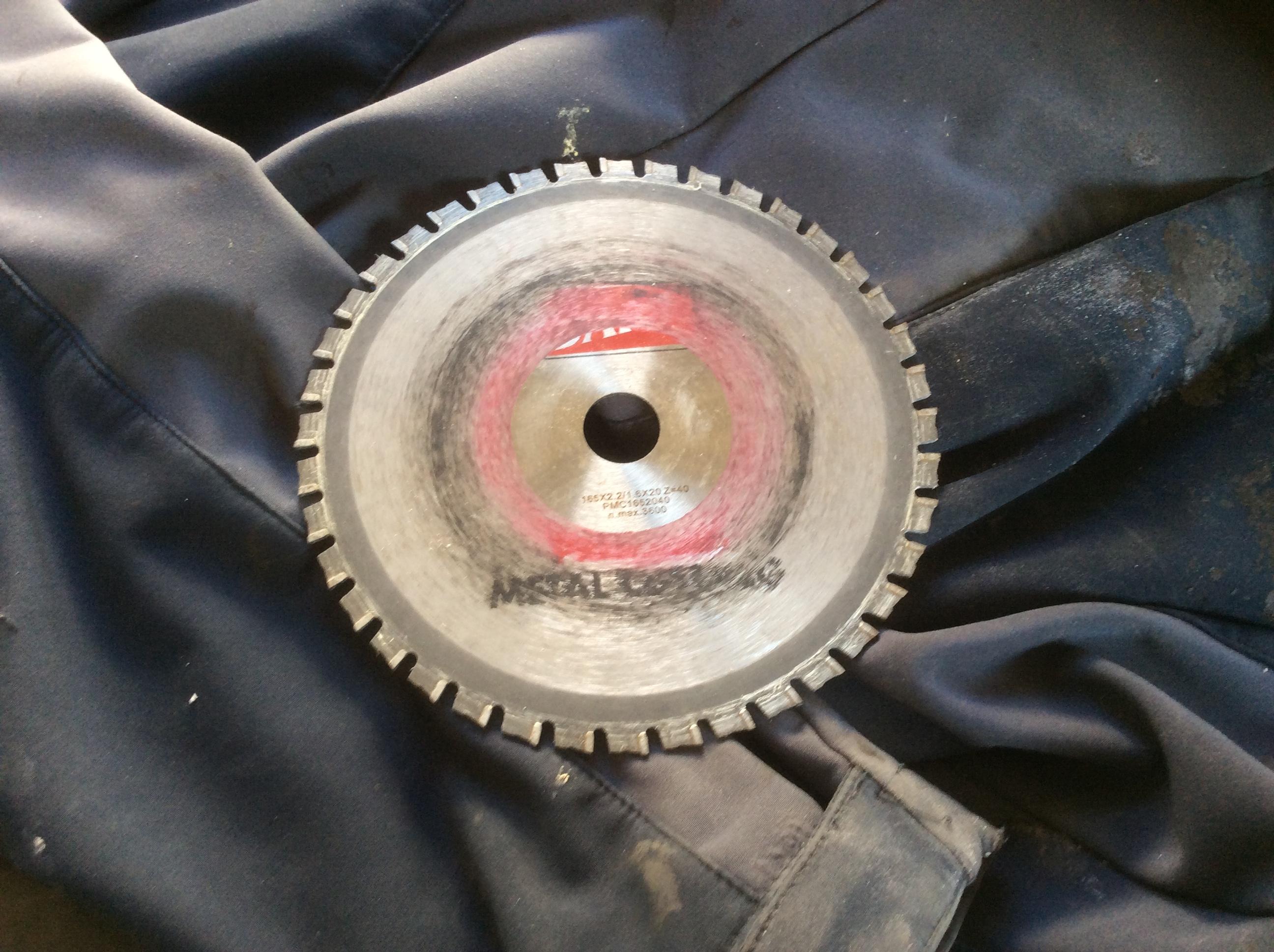

Russell griffiths Posted March 26, 2020 Share Posted March 26, 2020 I just bought a metal cutting blade for my circular saw thin cut, no offset to the teeth. Goggles and full face cover it’s savage. Lovely clean finish. Link to comment Share on other sites More sharing options...
