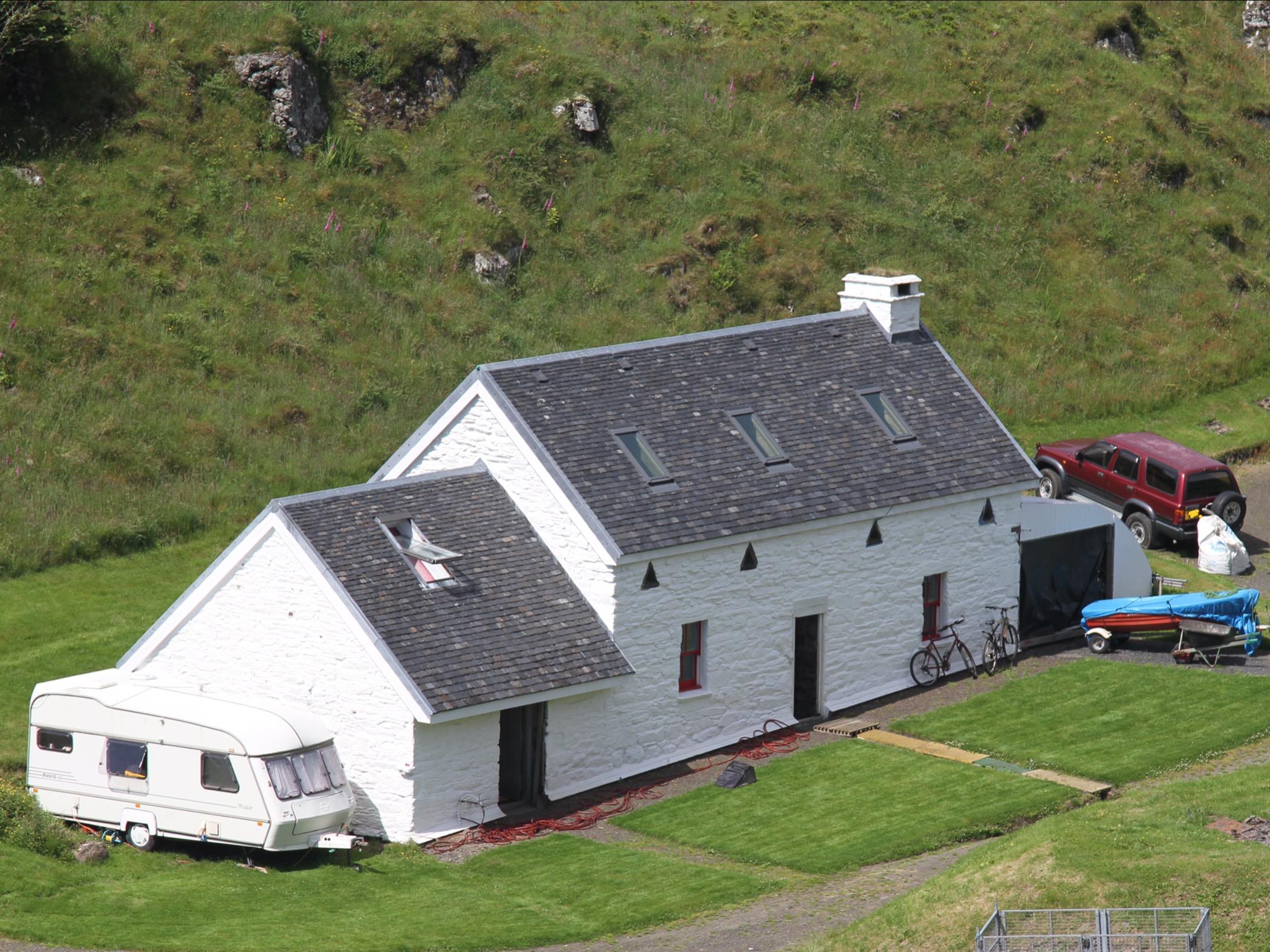

Cpd Posted March 25, 2020 Posted March 25, 2020 you could look at external wall insulation that then linked into a warm roof ? If the walls have footings you could look at digging in the exterior insulation as deep as possible to help minimise heat loss, your still going to have huge thermal bridge at the bace of the walls that will make UFH a non starter and these cold spots will be a perfect place for condensation and then mould..... I wanted to keep my stone walls inside as they were lovely but in the end the only way to keep the heat in And not have condensation problems is to line them internally. I concentrated on making the outside walls the feature through carful pointing.

Geoffrey Posted March 25, 2020 Author Posted March 25, 2020 2 hours ago, Cpd said: you could look at external wall insulation that then linked into a warm roof ? If the walls have footings you could look at digging in the exterior insulation as deep as possible to help minimise heat loss, your still going to have huge thermal bridge at the bace of the walls that will make UFH a non starter and these cold spots will be a perfect place for condensation and then mould..... I wanted to keep my stone walls inside as they were lovely but in the end the only way to keep the heat in And not have condensation problems is to line them internally. I concentrated on making the outside walls the feature through carful pointing. Thank you for your valid thoughts. Very helpful. Your house looks charming. I love the row of windows under the eaves.

Cpd Posted March 25, 2020 Posted March 25, 2020 Put some photos up, if for no one else I also love the charm of old buildings and just keep on charging into these projects...... lost a fortune and most of my sanity...... the triangle window are the only specific local architectural feature in old buildings round here and I wanted to add some when I was repairing the walls, they are not actually windows in this instant, but sudo window with mirrors and lights..... just a bit of fun. Normally they would be low down and in more agricultural style buildings but as I said it was just a nod to there existence as most of the old buildings get knocked down and this heritage feature is lost......

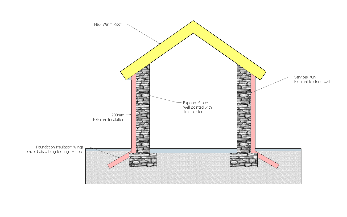

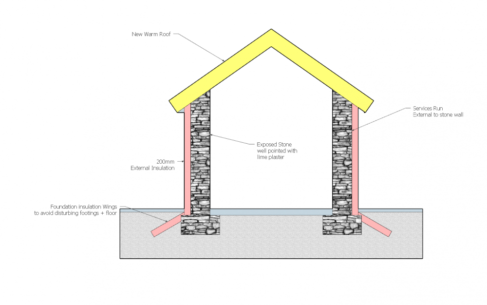

Iceverge Posted March 25, 2020 Posted March 25, 2020 Hi Geoffrey, How thick are the walls? I had a quick peruse of this paper. https://www.historicenvironment.scot/archives-and-research/publications/publication/?publicationId=16d0f7f7-44c4-4670-a96b-a59400bcdc91 They measured old stone and rubble walls in situ . I didn't read too deeply but it suggests a conductivity of about 0.72 W/mK although they varied to about double this ( I suspect for walls with higher levels of dampness). If you were confident your walls could be kept dry and were say 600mm thick could you expect a U value of 1.2W/m2 K. Well short of the regs but maybe with very high levels of floor and roof insulation, good air-tightness and triple glazed windows you could create a very comfortable home with your exposed stone walls. Failing that, externally insulating would work nicely and allow you to run all your services from the outside-in avoiding conduit or pipes showing inside. If there was no proper footings, insulation wings as shown joining to the external insulation would do the trick. Jonathan 1
Cpd Posted March 26, 2020 Posted March 26, 2020 The “wings” is the word I should have used when I talked about digging in the external insulation.

Geoffrey Posted March 27, 2020 Author Posted March 27, 2020 Hello Jonathan, Thank you very much indeed for your detailed reply and explanation. That has given me a lot of hope. I am very grateful. Best, Geoffrey
