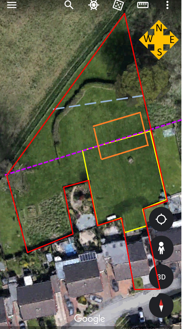

AshandOak Posted March 19, 2020 Share Posted March 19, 2020 Bonus points for diagrams! This is the plot we're buying. The red outline is owned by the property we're buying. The yellow outline is designated garden land. The rest is agricultural after an unsuccessful attempt 5 years ago to designate as garden land (not proven rather than refused per se) The purple line is the edge of the village envelope. The blue line is a strip still in the ownership of the original farmer (cannot build on or past it). Only 2 trees to the extreme north and furthest point west. For scaling purposes the size of house we want to build is pretty much the size of the 'sticky out' garden bit NOT owned by the property we're buying. So from the red line to the edge of the grey blob all that rectangle is about the size of the house we're planning. The views are to the north and west. There's some scrubland thin trees to the east (above the neighbour's garden past the purple line). The property and its neighbours are all single storey bungalows. Scaling/practicality wise it is 0.5 acres of completely flat land. Where would you put the house and how would you orientate it? Thank you in advance for your help. Link to comment Share on other sites More sharing options...

Ferdinand Posted March 19, 2020 Share Posted March 19, 2020 (edited) Potentially very tricky plot in planning terms. To ask this assume you have some sort of approval / pre-approval. I would take a long time thinking about it, and I might even think bungalow or an outline profile inspired say by Diana Princess of Wales conservatory at Kew (below), as you have loads of space. You need exposure to the South-West but also complete privacy from the other houses, which they will want not to try and stop you. You also need to have them on side, or at least not horribly off-side. I would be thinking top right of the yellow box, a path width away from the boundary, oriented South West with exposure to the North and East through windows or perhaps an evening patio or balcony hidden from the houses. What are plans for all the land around - is it zoned for housing in say 15 years time? If it is that changes what you do. How much of that half-demolished-for-the-driveway house is left - is it viable? Ferdinand Edited March 19, 2020 by Ferdinand Link to comment Share on other sites More sharing options...
AshandOak Posted March 19, 2020 Author Share Posted March 19, 2020 We will be using an architect but want to get some orientation ideas before we start. There's recent precedent in the village for infill garden sites and it's a designated growth village. Planning are on board in a pre application theoretical sense but obviously want to see drawings before they commit. The village has development sites for the next 15 years already agreed (far west - 400+m- behind the trees will be developed in next 2 years). Existing bungalow is a no go from a viability perspective. Already run that by planning! Link to comment Share on other sites More sharing options...

ProDave Posted March 19, 2020 Share Posted March 19, 2020 What is the width of the access alongside the bungalow? Could the bungalow be retained and make that a shared access and create new parking /garage behind the bungalow? Even by giving the bungalow a haircut and making it a smaller 1 bedroom semi bungalow? To be honest it looks more like a plot for a developer if they could get both of the pair of bungalows and create a small close type development of a few houses in their place. They would also want that awkward sticky out bit. Link to comment Share on other sites More sharing options...
AshandOak Posted March 19, 2020 Author Share Posted March 19, 2020 The bungalow will stay as is. If absolutely necessary for access (2.7m at the moment and the need for sprinkler system) we could shave 0.5m off it and it would still be a 2 bed bungalow albeit with a smaller 2nd bedroom, bathroom and the kitchen would need to be in the living room. But the costs might not outweigh the benefits. My mother in law will be living there. It's only 2.7m for a 2m stretch due to the staggering of the garages. Link to comment Share on other sites More sharing options...

Mike Posted March 20, 2020 Share Posted March 20, 2020 6 hours ago, AshandOak said: Planning have said no to extending but yes to a second house. There's nowt so strange as planners... Then I'd want to take advantage of the north and west views, so probably something like below, keeping a compact form to minimise heat losses. If you need to minimise the visual impact on the neighbours I might think about curving the roof into the ground at the south, with a grass roof & rooflights. Link to comment Share on other sites More sharing options...
Ferdinand Posted March 20, 2020 Share Posted March 20, 2020 (edited) 55 minutes ago, Mike said: There's nowt so strange as planners... Then I'd want to take advantage of the north and west views, so probably something like below, keeping a compact form to minimise heat losses. If you need to minimise the visual impact on the neighbours I might think about curving the roof into the ground at the south, with a grass roof & rooflights. That is the general spot, but I think going out onto the agricultural land will make it much more difficult. Stick on the garden land, and your life may be 10 times easier. But ask the q. Edited March 20, 2020 by Ferdinand Link to comment Share on other sites More sharing options...
