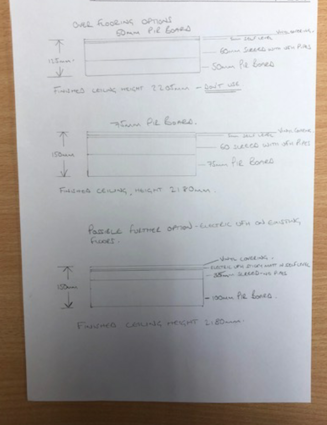

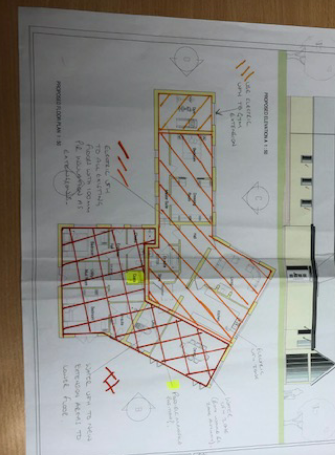

canalsiderenovation Posted March 18, 2020 Author Posted March 18, 2020 (edited) Ok, I've had a reply from the builder. I Have spoken with Wunda (they are the company that we have used for the last 10 years) regards the product that you have mentioned below. Its unfortunately not the right product for this application. It can be incorporated but it’s not the most cost effective. Are you averse to electric UFH to your existing floors? I have had an idea that would give you the same 100mm PIR board that will be going in your extension floors (see sketches attached. Our printer/scanner is offline so I had to take a photograph of them). The only section where the electric UFH would meet the water UFH in the extension is the open plan kitchen/dining room. This room would be spilt into two zones anyway so I don’t think it would be a problem. The electric UFH obviously pulls on your electricity more and you may prefer the water type UFH so the ASHP can run it. You could have 100mm PIR board with water UFH. It would leave you a finished ceiling height of 2155mm which is not an issue from a building regs point of view. I personally think the 75mm would be the best option in terms of U value and a slightly higher ceiling height but it’s your decision. We will obviously price up whatever you decide. ***** I've attached the pics but I can't really see them well. I'm not keen on electric for our existing, it's quite a large area and in my view defeats an ASHP but anyone got any suggestions? Edited March 18, 2020 by canalsiderenovation
canalsiderenovation Posted March 18, 2020 Author Posted March 18, 2020 So I guess if I'm reading this correctly if we want thicker insulation we would probably have to dig up our existing concrete pad....
PeterW Posted March 18, 2020 Posted March 18, 2020 He’s got a thing about screed..! Electric UFH can cause issues with LVT so it is not something I would use. To use the Wundatherm system for LVT or Karndean you use Duo boards over the top - not cheap but works fine.
canalsiderenovation Posted March 18, 2020 Author Posted March 18, 2020 2 minutes ago, PeterW said: He’s got a thing about screed..! Electric UFH can cause issues with LVT so it is not something I would use. To use the Wundatherm system for LVT or Karndean you use Duo boards over the top - not cheap but works fine. I'm really put off by electric underfloor heating and LVT gluedown flooring is non negotiable. I'd rather stick with 'wet' UFH. When you say he has a thing about screed do you mean he's using too much so he should reduce the screed and add more insulation? I'm feeling a bit out of my depth here but want to ensure we have the right about of insulation. I'd rather not dig up 100m2 plus of existing flooring. Any advice or help would be great, my main worries for the whole build is heating and insulation and windows, the latter I feel more confident with but this part is not something I have any knowledge of.
PeterW Posted March 18, 2020 Posted March 18, 2020 No he just keeps drawing options with screed - you don’t need to use it ..! There are loads of wet floor overlay options - if I get chance I’ll ring Wunda tomorrow and speak to Andy and see what he suggests. Other option is the Fermacell floor system over the track panels. Again, not cheap but works well. 1
canalsiderenovation Posted March 18, 2020 Author Posted March 18, 2020 1 minute ago, PeterW said: No he just keeps drawing options with screed - you don’t need to use it ..! There are loads of wet floor overlay options - if I get chance I’ll ring Wunda tomorrow and speak to Andy and see what he suggests. Other option is the Fermacell floor system over the track panels. Again, not cheap but works well. Ah thanks so much that would be amazing, private message me if it's easier. Cost wise I'm sure it's got to be better than digging up our floors. I don't want to go to the expense of putting in ASHP, triple glazed windows and wall insulations if the floor insulation is going to be insufficient. Our current ceiling height in our living room is 2.6m and the hall and bedroom areas is 2.35m (they vary because our property is like two bungalows seperated by a flat roof and the bungalow part with the bedrooms have steps).

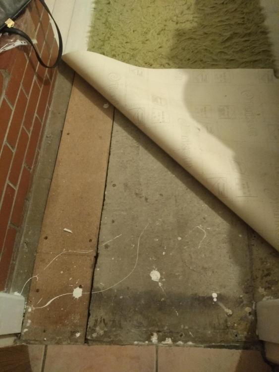

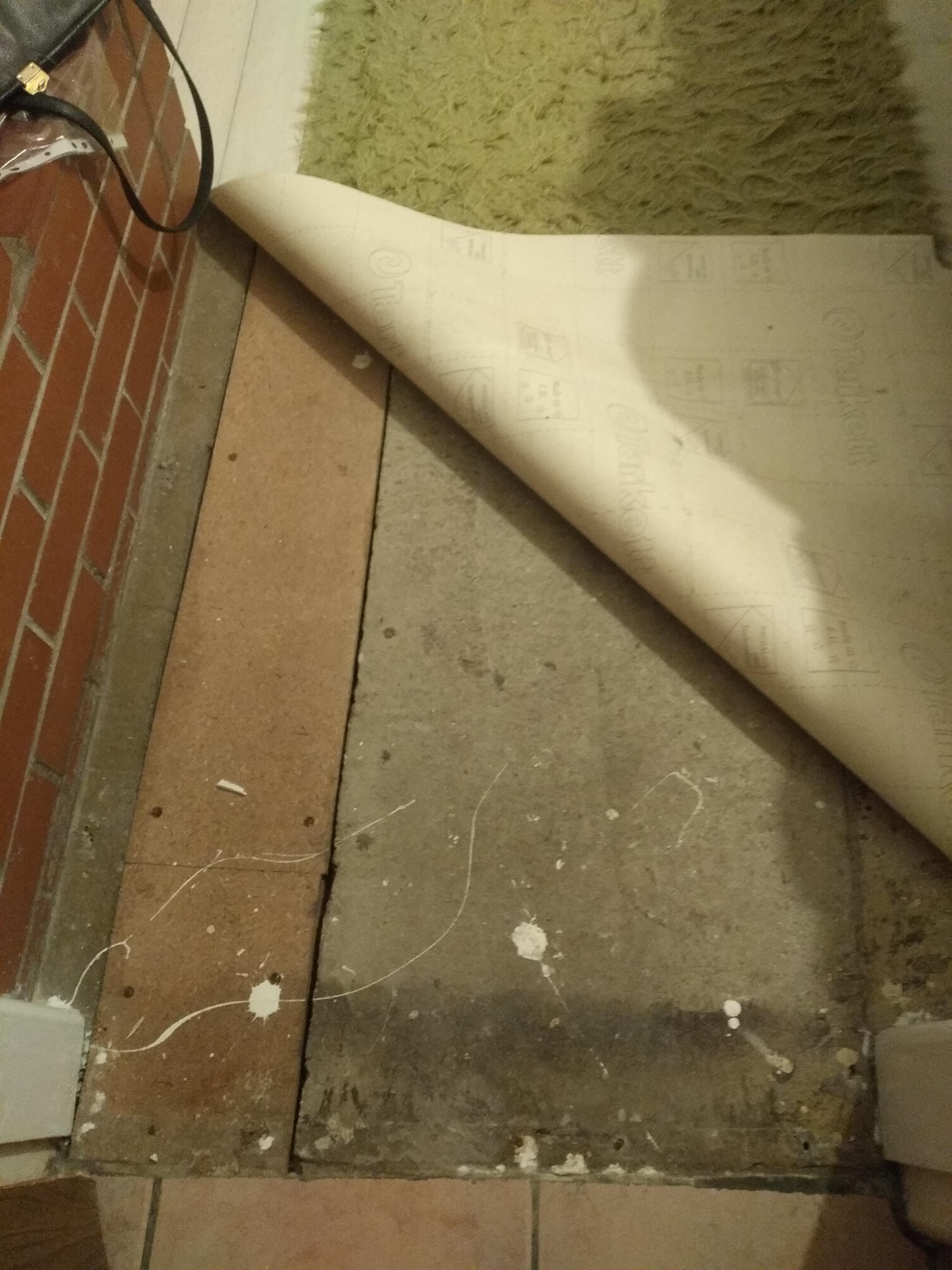

canalsiderenovation Posted March 18, 2020 Author Posted March 18, 2020 (edited) 38 minutes ago, PeterW said: So it’s definitely a solid concrete floor now ..? And you’re happy that you can go upward on door frames ..?? Get the 150mm additional clearance ..? Yep it's a solid concrete pad 1970s, some areas have wooden bits where the pipes are for our oil heating which is being ripped out (see pics) which when the heating worked (for about a month, would heat up the wood bits which was a bit weird). All door frames, skirting, plaster all coming off so makes no difference (and not all doors staying in same place anyway). Edit: Building Report from when we purchased it says: The floors throughout the property are solid concrete construction. There are ducts within the floor slab to allow the central heating pipework. These sections of the floor have a timber board over them in order to protect the pipework.The floors were generally found to be level with no evidence of any significant settlement. Some slight unevenness was noted to the surfaces but this is considered to be within normal building tolerances. Edited March 18, 2020 by canalsiderenovation
canalsiderenovation Posted April 6, 2020 Author Posted April 6, 2020 As an update to this, how does this sound? This would be breaking out our existing flooring: 150mm MOT sub base 150mm concrete oversite 120mm Kingspan insulation Polythene separating layer 60mm screed incorporating UFH pipework
PeterW Posted April 6, 2020 Posted April 6, 2020 Bin the oversite, it is not needed !! 150mm sub base 25mm EPS as blinding carried up the existing walls as expansion DPM 130mm PIR 100mm concrete with UFH Stronger and quicker than the screed insulation sandwich.
