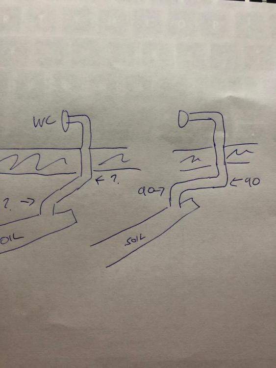

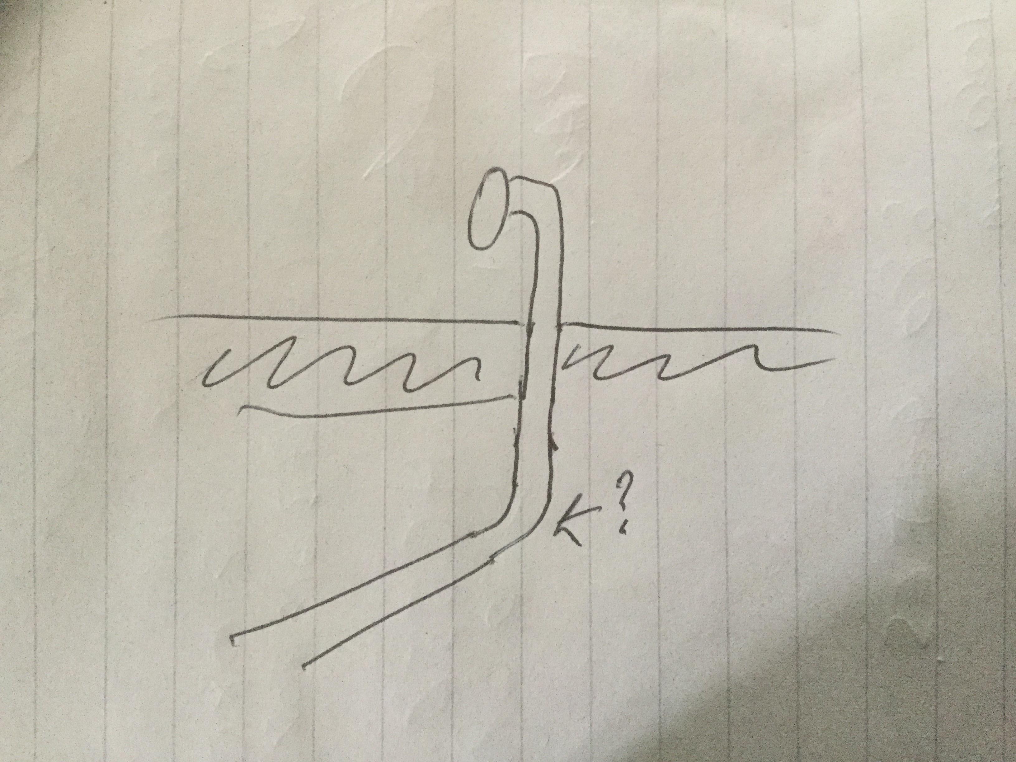

March 10, 20206 yr I assume the first drawing is better i.e. try to have 'gentle' bends rather than 90 degrees....
March 10, 20206 yr Yes, anything to avoid blockages and bends do slow the flow a lot . Is there any reason you can’t do this.
March 10, 20206 yr Author 7 minutes ago, joe90 said: Yes, anything to avoid blockages and bends do slow the flow a lot . Is there any reason you can’t do this. Maybe - the problem is my WC is near the in ceiling drain , so there’s not much ‘room’ to do a gentle fall .

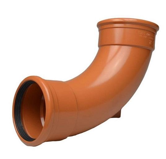

March 10, 20206 yr 27 minutes ago, pocster said: I assume the first drawing is better i.e. try to have 'gentle' bends rather than 90 degrees.... Might you mean a Rest Bend? 87.5 degrees.... me being an expert and all that ?
March 10, 20206 yr Author 1 minute ago, AnonymousBosch said: Might you mean a Rest Bend? 87.5 degrees.... me being an expert and all that ? That looks good - not sure it exists in solvent weld - will check !
March 10, 20206 yr Author Just now, AnonymousBosch said: Ahhh, sorry you meant soil pipe.... might this link help? Think this is it https://www.drainagecentral.co.uk/110mm-PVCu-Solvent-Weld-Soil-Pipe-Bend-925-Degrees-Double-Socket-BS473?gclid=EAIaIQobChMI-sSWsK-Q6AIVVODtCh3z1gt4EAQYCiABEgIY_vD_BwE
March 10, 20206 yr As an aside, why did you choose solvent weld? I nearly did, but I haven't got the guts - or the experience.
March 10, 20206 yr Author Or this ? ouch at the price !! https://www.mytub.co.uk/110mm-solvent-92-5d-rest-bend-only-ss705-product-570233

March 10, 20206 yr Why do they say solvent weld should be avoided below ground on this one?.. https://www.screwfix.com/p/floplast-long-radius-bend-87-5-110mm/81100 Quote FloPlast Long Radius Bend 87.5° 110mm (81100) Connects to 110mm ring seal sockets for underground installations and fittings. (If necessary, it can be connected to a solvent weld fitting, however this should be avoided on underground applications). Edited March 10, 20206 yr by Temp
March 11, 20206 yr 6 hours ago, Temp said: Why do they say solvent weld should be avoided below ground on this one?.. https://www.screwfix.com/p/floplast-long-radius-bend-87-5-110mm/81100 Because it can't flex with ground movements. Whereas push fit can.
