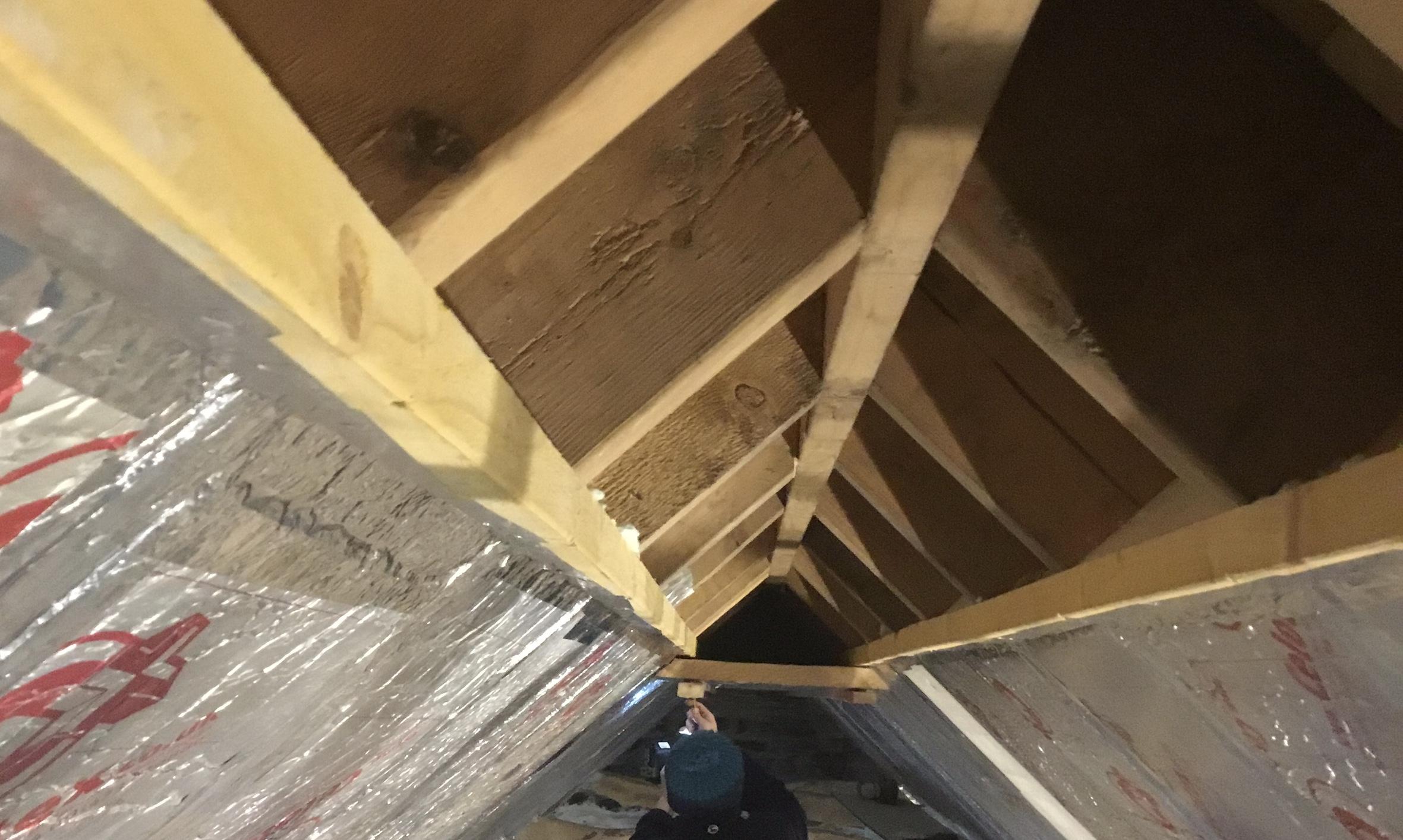

Additionally, you can see in the second picture that the stone walls are built into the slope of the roof. I removed a layer, to access a few rafters that needed replacing. The boards behind the stone were moist. They've now dried out, so I assume it was condensation. I can't really see any reason for the stone above the level of the wall plate, so would it make sense to remove everything down to this level to help the wall breathe?
it’s very likely that this additional stone is there to stop the roof blowing off ! You will probably find that where the roof joist fixes to the wall plate there is considerable rot in either the wall plate or the joists or both and that the actual fixing strength at this point is long gone. The additional stone will really help to secure the roof from up lift. Before the use of wall plates there would have been timber crucks ( lengths of large timber built into the stone walls) attaching the roof to the walls and stopping the roof from blowing away. You can remove this additional stone but you will need to add one or even two rows of noggins to strengthen the bottom of the joists and then LONG metal strapping attaching every joists to the wall. This will let the timber joists breathe better and also prevent your roof blowing away..... remember not to pull all the stone work away in one go, do half a dozen at a time so that the roof is never vulnerable if the weather changes..... it happened to a friend who did this exact thing while replacing a roof of similar vintage, new tin , tidied up wall heads, big wind and whole roof was on the lawn next morning. I am not an expert so do your own cross referencing.

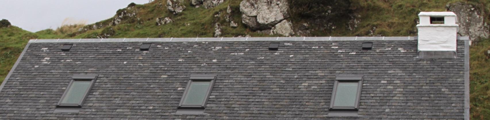

Roof vents from the outside and the vented area below the ridge just before we cover it over with 250mm of PIR from below.

I think you mentioned this before and talked about replacing with slate...... I would strongly suggest you replace with corrugated iron or box profile or something light weight  as the additional weight of slates on a roof like this may well cause structural issues......  it may have had slate on once but that was a long time ago and the timbers are now well past there best before date.... I expect with a little tlc the timbers will last another 100 years,  I have worked on buildings like this where we ripped of the the first 6 foot or more of the sarking so that we could inspect all the joist ends, replace as needed and treat all the old ones and in one case replaced the wall plate  without pulling the whole roof off....
Yes, I was planning to replace the original roof straps. It looks like they're all that's currently securing the roof! Additional bracing with noggings seems sensible, too!
I was thinking something like fiber cement tiles?
Sorry I know nothing about them, but if the roof can handle it then it would be a good opportunity to batten and counter batten, this would then leave you roof membrane intact without hundreds of nail holes, which happens on a traditional slate / sarking roof.
