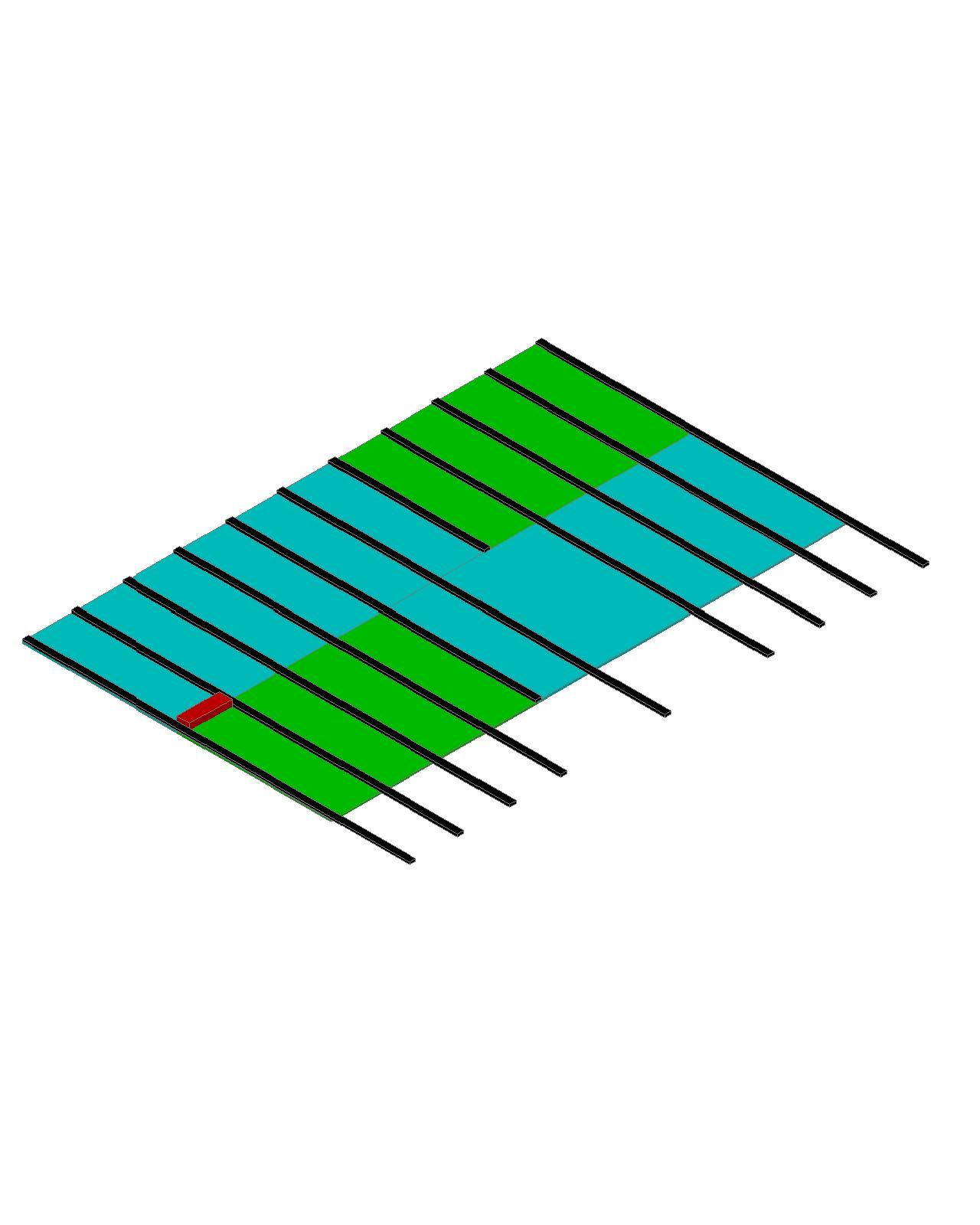

@andyscotland can I ask you please: I have an area of ceiling left, after I plasterboard it with full width 1200mm boards as much as I can, a gap left of 320mm. So the room width 3800mm x 320mm. So I need two bits: one full length board cut thin to 320mm, plus 1400mm x 320mm bit.
Is the long thin 2400mm x 320mm section a viable size? or is it a recipe for disaster/ you never use such a long thin bit.. IE cut it up or something?

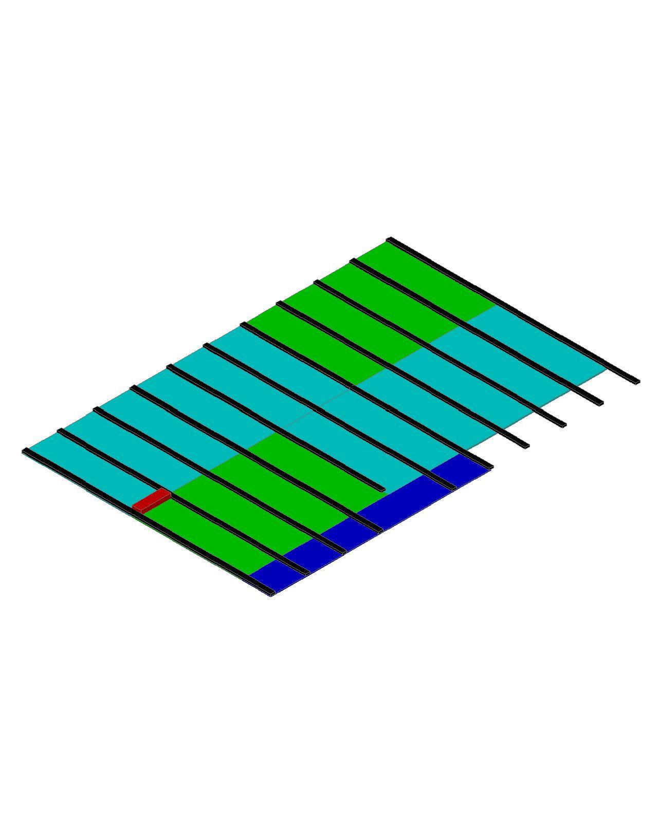

(I know its tagged on to this thread.. but I have no option). Thanks
That size is no issue at all but better with two of you putting it up.

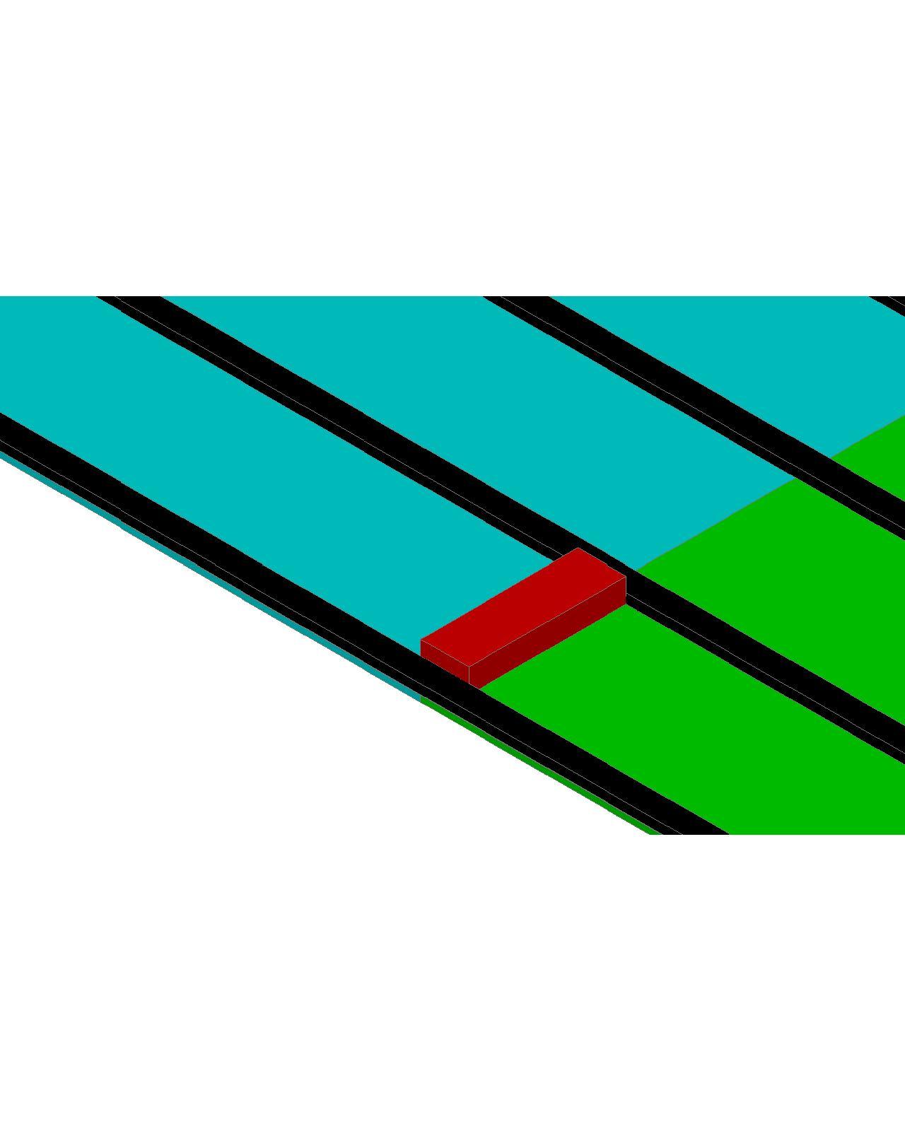

In answer to your earlier questions. Plasterboards are shown blue & green, joist bottoms in black. Without noggins, shown red, there is no support under where the edges butt up to each other.
Link to comment
Share on other sites

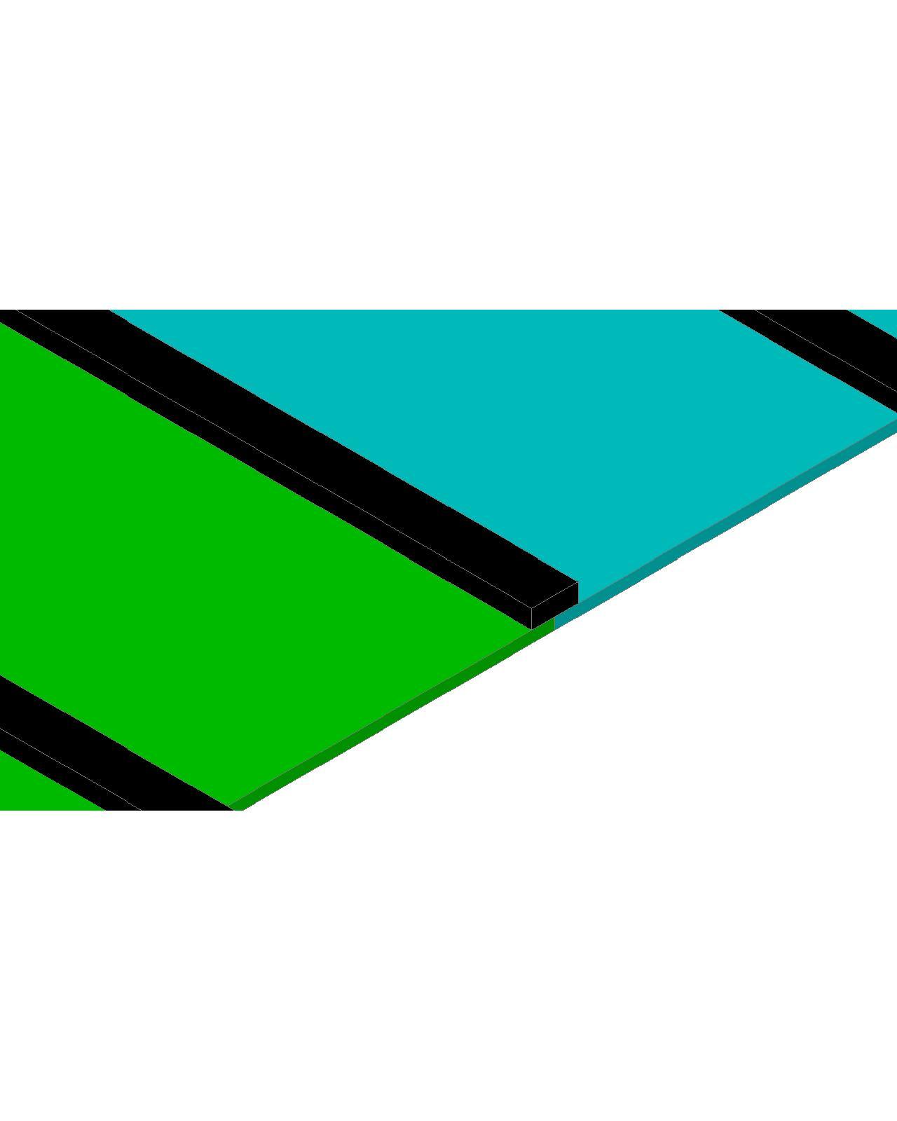

Dark blue is your 320mm wide bit. What will dictate whether you start with a full board (light blue) on the left is what the end of the board sits on. You MUST ideally have the right hand end of that board on the centre of a joist. Again, imo you want a line of noggins between the light and dark blue:

@Onoff hallelujah! I now understand what you were on about. Mostly. Thanks for your patience to explain this.
I had no idea that I needed any noggins perpendicular to the joists. I had -only- the notion of "extending" a joists' width, so if my board end fell short, my board end can fall on the new timber inserted (this -is- what is suggested on the other sketch.. the broken line additional timbers are parralel with the joists, not perp.. if I can recall: the thread, & all info I need within it, having been deleted).
Ok so let me get this right (with this new [to me] above info confusion has now shifted, not gone away).
Are you suggesting I need a whole series of (in your diagram above with the single red noggin) 18x noggins put in, between the light blue & green 'long sides' of the boards ----and----- the very long join between the dark blue 320mm board & adjacent long side of boards?
Or.. is your suggestion I ----only---- need noggins at the meeting of the dark blue & other boards? (& your red noggin is just an eg of what a noggin is.. rather than an actual placement-suggestion in my ceiling?).
Link to comment
I would yes.

Ok now I understand. Thanks. Its added a ton of work I'd no idea of then! I still can't quite get it tho (apart from it being belt/ braces which I can see the logic of) if my joists are only 300mm between, & 100mm W. Now looking at my builders' ceiling pB job upstairs.. there are 300mm gaps all over the shop between fixings (many 500mm). Its shoddily done, & you'd have a fit, but not alarmingly-so, to me.
But can you not see that altho your sketches always appreciated.. it has (broken-line) noggins in opposite/ perp to the red eg above-?
Onoff there's no googling to have solved this mystery! it would only increaced my confusion if I'd read a noggin is inherrantly perp to a joist (as I 1st thought > then sketch suggested otherwise > & now I'm back concluding a noggin likely is & only ever is perp to a joist).
Hence I naturally ask the q's I did. And you blow a gasket! I still may be wrong re. your sketch.. but I'm 99.9% sure those broken-line additionals were/ are facing twds the viewer, not to the sides like red-nog above is. Hey-ho. many thx tho- zoot.
