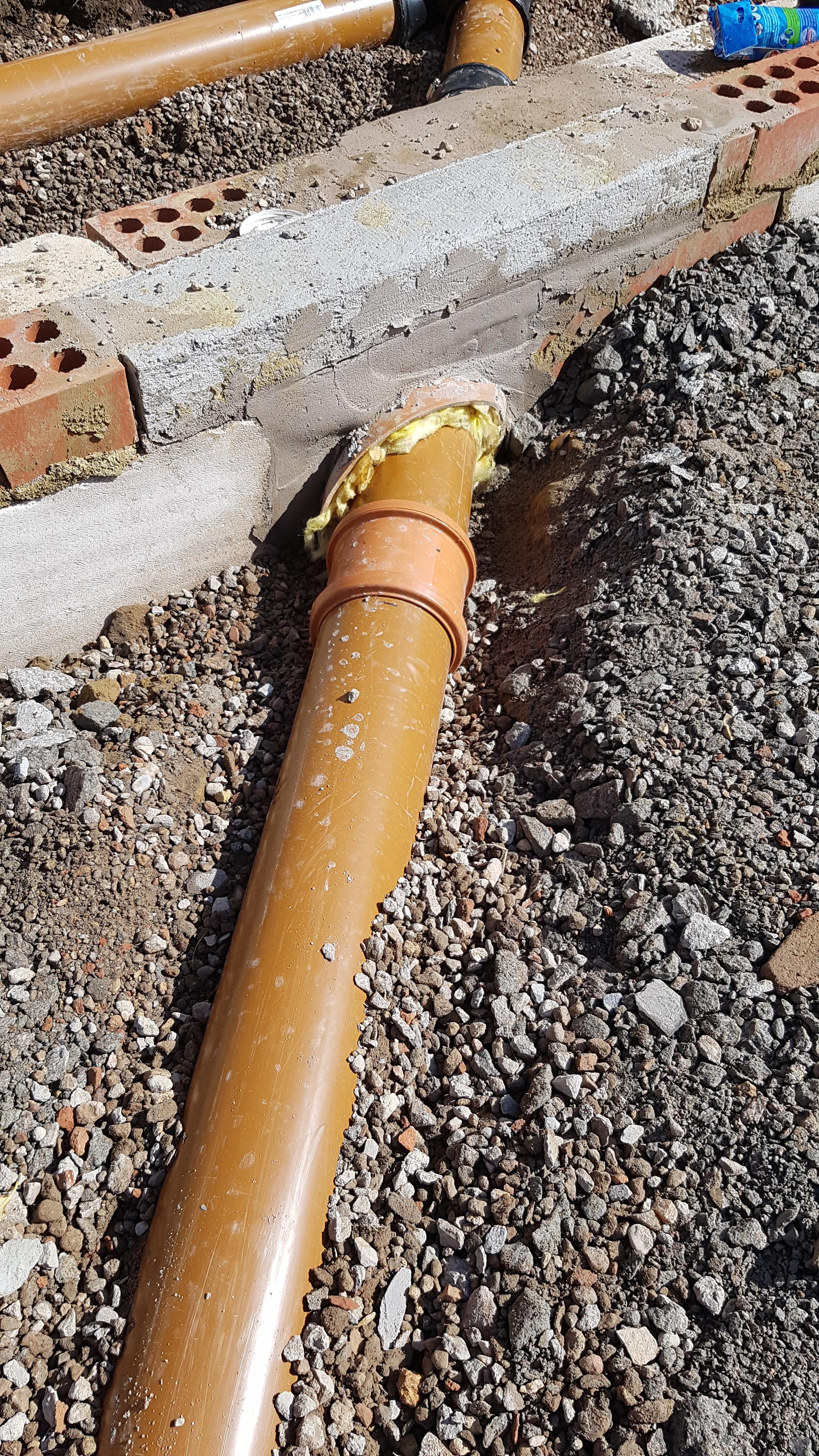

1. When the 110mm soil pipe goes through the blocks that will support the B&B floor, is it OK to leave a 200ish mm gap in the blocks (they are only 225mm high)  and cover with a steel lintel to support the B&B - I believe the drains all fall to not require the lintel supporting a beam. I am not sure what filler material is acceptable. I would assume expanding foam is not.
2. What is the best way to support the pipes that will sit under the B&B floor to ensure a proper gradient? One pipe is quite long (just under 3m) so I'm keen to get it right. The surface under the B&B floor will be gravel over a membrane assuming the BCO doesn't change his mind. I thought about building this grave up surrounding the pipes to support them.
3. I know the fresh water needs insulating. Does anything need to be done with the soil pipes? Document H doesn't mention it so I assume not.
In the past i have supported soil pipes below BandB floors on a bit of leanmix concrete every 2 meters, with shingle under the remaining. Not saying that's right, but i've never had a problem.
Concrete lintel over the pipes no need for steel
pipes will need to be fully supported on a weak dry mix of concrete
do not support on blobs as the pipe will sag over time.
Try to not end up with a beam directly on the mid span of a lintel if you can, unless it has enough block work on top to provide a good bearing.

I guess you're suggesting I go with 2.24a in document H where you have flexible connections within 150mm of the wall so I don't need to leave a gap to fill. Otherwise having 210mm of clear space in a wall that is 225 high doesn't give much room for concrete!
I haven’t I couldn’t see the point there is no way your ring beam is going to move up or down, I will fix stainless mesh over the hole around the pipes, but Im happy to be told this is wrong
Should be an 8" pipe not 6" but I like living on the edge. Insulation and stainless steel scouring pads as packing as per @Jeremy Harris advice20190829_110217.thumb.jpg.3b5cb91a0b3d503e4d1bd19720273419.jpg
