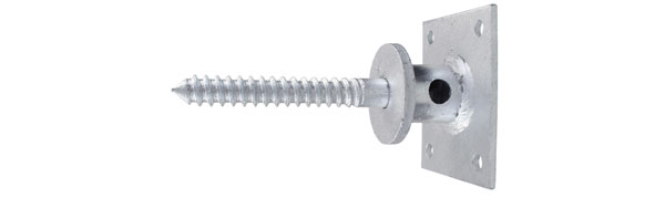

success1980 Posted February 29, 2020 Posted February 29, 2020 Hi all, I am planning to construct a small garden wall (only about 50cm high to cover hight difference) to fix the fence onto instead of having it dug in and rot every few years. Also, I like the look of it. I am digging a trench and pour the foundation. Then it would ideally be solid concrete rather than hollow blocks filled with concrete. Would anyone know where I can hire formwork panels? 50cm or 75cm wide would do, I need 20m all together (10m wall). Thanks
bassanclan Posted February 29, 2020 Posted February 29, 2020 This sounds like a complicated way of going about putting up a fence. How do you plan to fix the fence to the concrete wall Would concrete posts and gravel boards not offer a similar solution?
Declan52 Posted February 29, 2020 Posted February 29, 2020 Cut a sheet of 12mm ply/ OSB, whatever you can get cheaper, in half and use 2*2 driven into the ground to act as support posts. Depending on your skills you could insert some threaded rod into through the ply into the gap so when you pour the concrete the rods will be fixed onto which you can slide your posts. Will require a bit more work in setting it all out so it suits the lengths of D rail you are going to use.
success1980 Posted February 29, 2020 Author Posted February 29, 2020 Yes it is a complicated way to do the fence ... but I just dont like the lookof gravel boards or concrete posts. I can barely deal with wooden fences . I think it looks neater if I have a stable concrete wall that's 5cm higher than the lawn. The posts will be fixed "invisibly" by drilling a 25mm hole in the bottom and screw the steel plate to the concrete with concrete screws. Ideally I would use composite or aluminuim panels but that's way too expensive for now.
success1980 Posted February 29, 2020 Author Posted February 29, 2020 16 minutes ago, Declan52 said: Cut a sheet of 12mm ply/ OSB, whatever you can get cheaper, in half and use 2*2 driven into the ground to act as support posts. Depending on your skills you could insert some threaded rod into through the ply into the gap so when you pour the concrete the rods will be fixed onto which you can slide your posts. Will require a bit more work in setting it all out so it suits the lengths of D rail you are going to use. Like this suggestion. Most of it will be underground anyway so that could be an option.
Mike Posted February 29, 2020 Posted February 29, 2020 Have you come across Postsaver bituminous post sleeves? Would be less hassle than building a concrete wall if they work as claimed. I used them on a new fence last year so will report back in a decade or two...
Ferdinand Posted February 29, 2020 Posted February 29, 2020 (edited) I either bolt the posts to concrete repair spurs, or use Postsavers as above. Either way should give 2 decades of life. Postsavers work by protecting a wooden post at the point where it rots - ground level. (Vid below - they also work with square posts). Other options are plastic posts or guaranteed life wooden posts. Best of luck with your chosen method. Ferdinand https://vimeo.com/manage/262801711/general Edited February 29, 2020 by Ferdinand
bassanclan Posted February 29, 2020 Posted February 29, 2020 This sounds like the ideal time to learn how to lay bricks and build a brick wall which shouldn't last 50+ years
