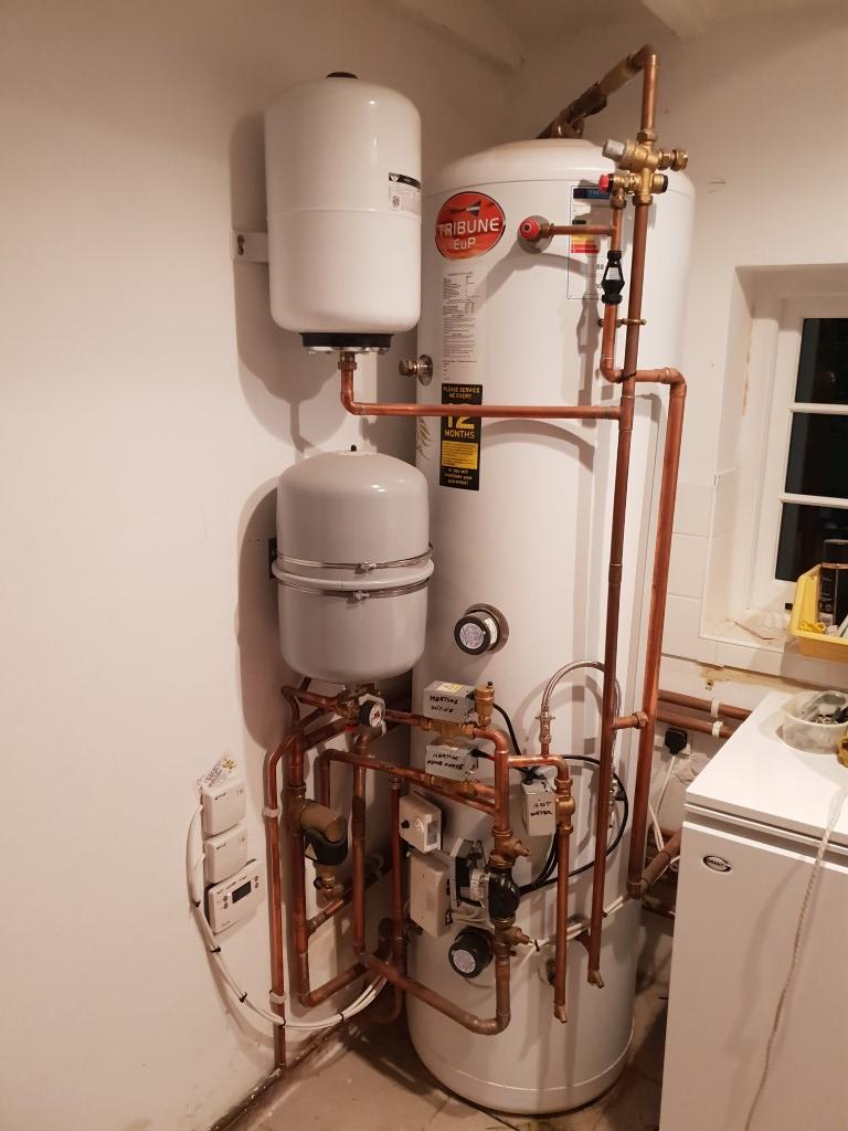

ProDave Posted February 25, 2020 Share Posted February 25, 2020 I have never been a fan of combi boilers though plenty are happy with them. What people are suggesting to you is a "system boiler" that heats the heating and heats a hot water tank. The fact people are confusing you calling it an "immersion tank" While it does have an immersion heater, it is primarily heated by the boiler, so won't be any more expensive. An Unvented cylinder would be my choice so you get mains pressure hot water and the tank should be able to run more than one shower at a time (which I doubt a combi boiler would manage) Link to comment Share on other sites More sharing options...
Snowbeetle Posted February 25, 2020 Author Share Posted February 25, 2020 5 minutes ago, ProDave said: I have never been a fan of combi boilers though plenty are happy with them. What people are suggesting to you is a "system boiler" that heats the heating and heats a hot water tank. The fact people are confusing you calling it an "immersion tank" While it does have an immersion heater, it is primarily heated by the boiler, so won't be any more expensive. An Unvented cylinder would be my choice so you get mains pressure hot water and the tank should be able to run more than one shower at a time (which I doubt a combi boiler would manage) Thanks ProDave, Is it all combi boilers you think are not good or just oil ones? Thanks for clearing up the confusion over immersion / system boiler - that makes more sense now. I liked our old mains gas combi boiler because it kept up with hot water demands well and you never got the tank-water-gone-cold experience of which I have treasured memories from my youth. Does the system you lean towards avoid that problem somehow? Size of tank maybe? Link to comment Share on other sites More sharing options...
Temp Posted February 25, 2020 Share Posted February 25, 2020 We went with a thermal store which stores energy for both the DHW and UFH. That's because I was concerned our oil boiler would short cycle on and off too much without one. The burner in an oil boiler always runs flat out when lit. It doesn't modulate up and down like a gas boiler. So if you have a powerful burner to provide loads of DHW in a combi it might cycle on and off too much if/when the heating load is very small. Short cycling is s bit like stop start driving in a car, it's less efficient than doing fewer longer burns. That said you can lose a lot of heat from a thermal store and it's associated pipes and pumps. Who knows what the right approach is. We're happy as our TS gives loads of mains pressure DHW and the boiler doesn't cycle when just one loop is calling for heat. However our bills are still higher than I expected. 1 Link to comment Share on other sites More sharing options...

mm289 Posted February 25, 2020 Share Posted February 25, 2020 We had an oil combi in our farmhouse I fitted about 15 years ago. Supplying a 200sqm building with traditional radiators and 2 bathrooms. It was fine for showers and wasn't to bad for baths, you just got used to running the hot in first incase it struggled. When we did our major renovation the last few years we swapped this out with a trad oil boiler feeding an unvented HW tank as @ProDave describes. This gave me a couple of advantages. As we had added a 3rd bathroom I wanted lots of HW capacity and so we had a HUGE unvented tank fitted, probably overkill but what the plumber recommended. Also having a tank meant we could add an immersion heater which is great for the times when i forget to order the oil in time and we then have no HW? The system is working really well for us and with oil at the lowest price it has been for over 10 years it is actually quite cheap heating. cheers, MM 1 Link to comment Share on other sites More sharing options...
