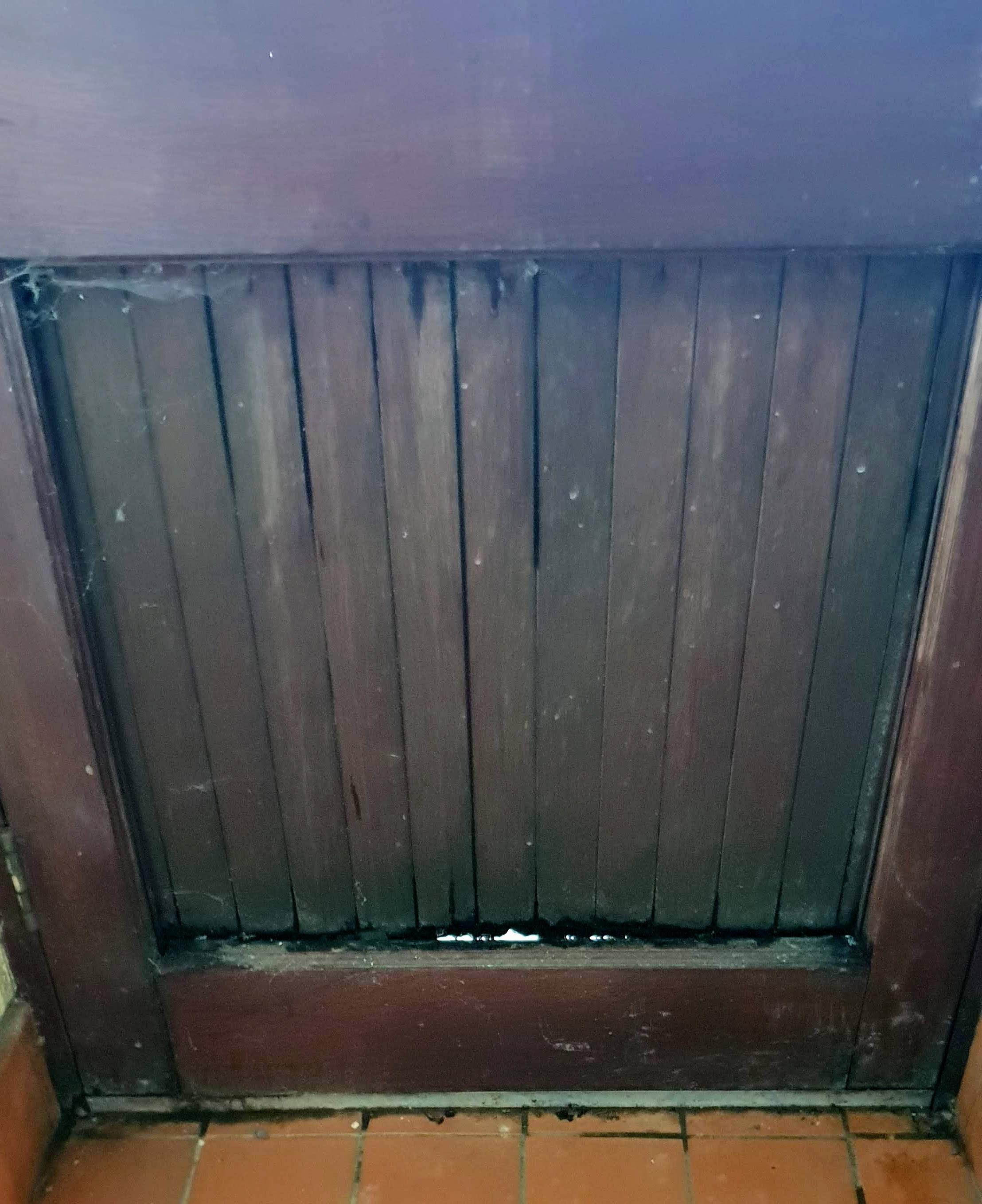

ToughButterCup Posted February 24, 2020 Share Posted February 24, 2020 Our cottage is built facing south west and so traps every last bit of bad weather. And the back door 'gets it' . The last month or so has pushed it beyond its limits. Its developed a curve that would make Beckham proud. Awful innit? Question is how to mend it? The vertical lines are strips of timber are fixed with nails top and bottom. What a silly design for an external door. But then nobody asked me ...? My instinct is to knock the vertical strips of timber all out and make a replacement ply cover for the hole. But it wont take long before the ply starts to delaminate. I'm all out of imagination this morning ....... I need a simple quick temporary fix that'll last until the summer, please. 1 Link to comment Share on other sites More sharing options...
Delicatedave Posted February 24, 2020 Share Posted February 24, 2020 Rip it out and replace it with a picture frame filled with glass (that's what I would do) or wood. Then on the outside screw a sheet of plastic glass over it. If fact over the whole door if you want. Link to comment Share on other sites More sharing options...
Mr Punter Posted February 24, 2020 Share Posted February 24, 2020 Cut a piece of OSB bigger than the infill and screw it to the face. It lasts a surprisingly long time. Link to comment Share on other sites More sharing options...
Ferdinand Posted February 24, 2020 Share Posted February 24, 2020 (edited) I would replace it with a simple plank pattern UPVC door in rosewood or dark brown colour, especially if there is no lobby etc. That's what I did with my cottage door. Cost around £500-600 I'm guestimating. Not sure what your sale plans are, but a new door would be knocked off the offer in all likelihood. Ferdinand Edited February 24, 2020 by Ferdinand Link to comment Share on other sites More sharing options...
Gone West Posted February 24, 2020 Share Posted February 24, 2020 We had catflap in our old bungalow back door which we didn't want. I took the catflap out and fitted a piece if thin plywood on both sides, painted it and it was still fine when we demolished the bungalow fourteen years later. 1 Link to comment Share on other sites More sharing options...
ToughButterCup Posted February 24, 2020 Author Share Posted February 24, 2020 Maybe some heavily painted WBP, then Peter ..... ? Link to comment Share on other sites More sharing options...
Gone West Posted February 24, 2020 Share Posted February 24, 2020 Just now, AnonymousBosch said: Maybe some heavily painted WBP, then Peter ..... ? Worked for us. IIRC we sandwiched the existing panel with 6mm ply although I can't remember the grade exactly. Link to comment Share on other sites More sharing options...

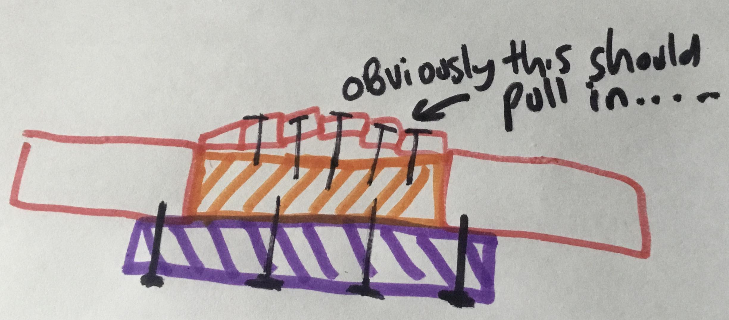

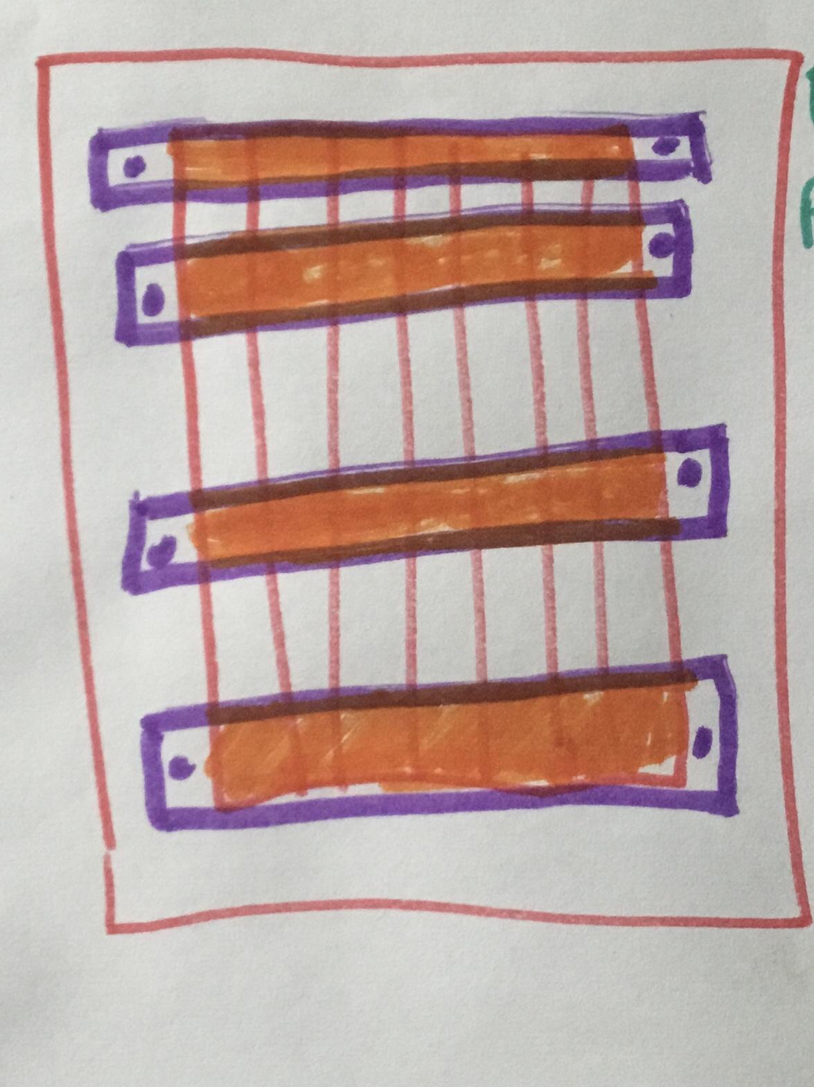

Cpd Posted February 24, 2020 Share Posted February 24, 2020 So many ways ...... just of the top of my head as I’m on lunch brake ! assuming this is inside ? and your not wanting to spend money on it..,.. Orange - infill with some cross bars to a depth that will bring them level with the face of the door (ignoring the bow) the purple are attached to the orange but are longer so that they can be attached to the door face go outside and ram in a bunch of screws to pull the bowed door panels up tight to the orange , purple braces. if you want to make it a bit less draughty staple a bit of roofing paper over the inside before braces. right back to building. 1 Link to comment Share on other sites More sharing options...
