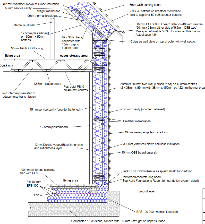

Our external walls are a different form of twin stud construction, but seem to be extremely effective at attenuating sound.  This is a section though the wall:
The ~300mm wide void between the skins is filled with dense pressure-blown cellulose, and is pretty heavy and solid.  The construction is inherently very airtight, as is has been designed to be the external walls for a passive house.  It should be pretty easy to substitute this type of wall for a standard stud wall, albeit with a fair increase in wall thickness.

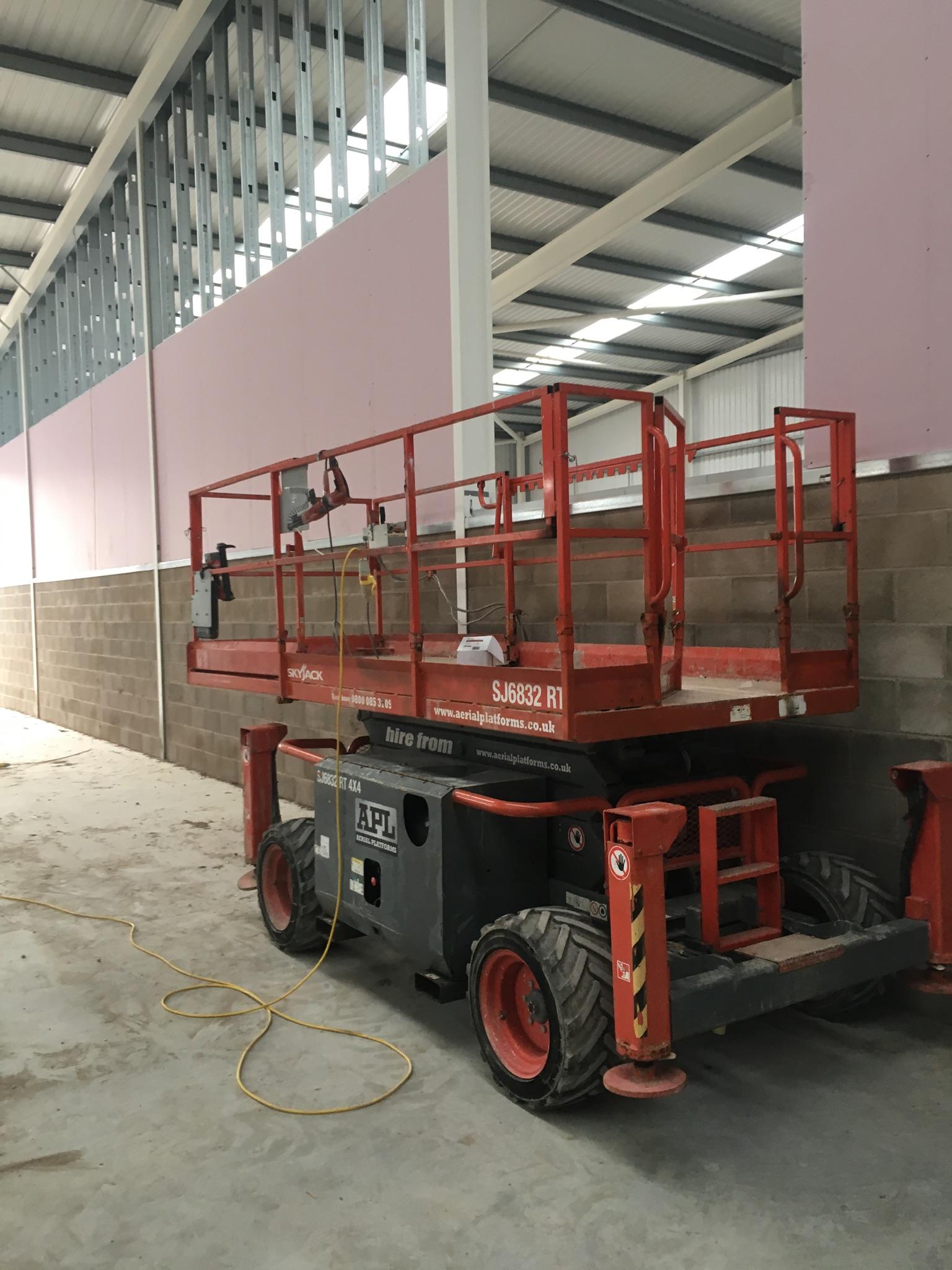

This is what I do for a living
A double MF wall will out perform a solid built wall for sound  and air tightness
I’m just pricing some factory units that have a set of offices in the middle that won’t want to listen to machinery all day
Similar to the one shown but with Gypsum slabs clipped to the back of each stud
