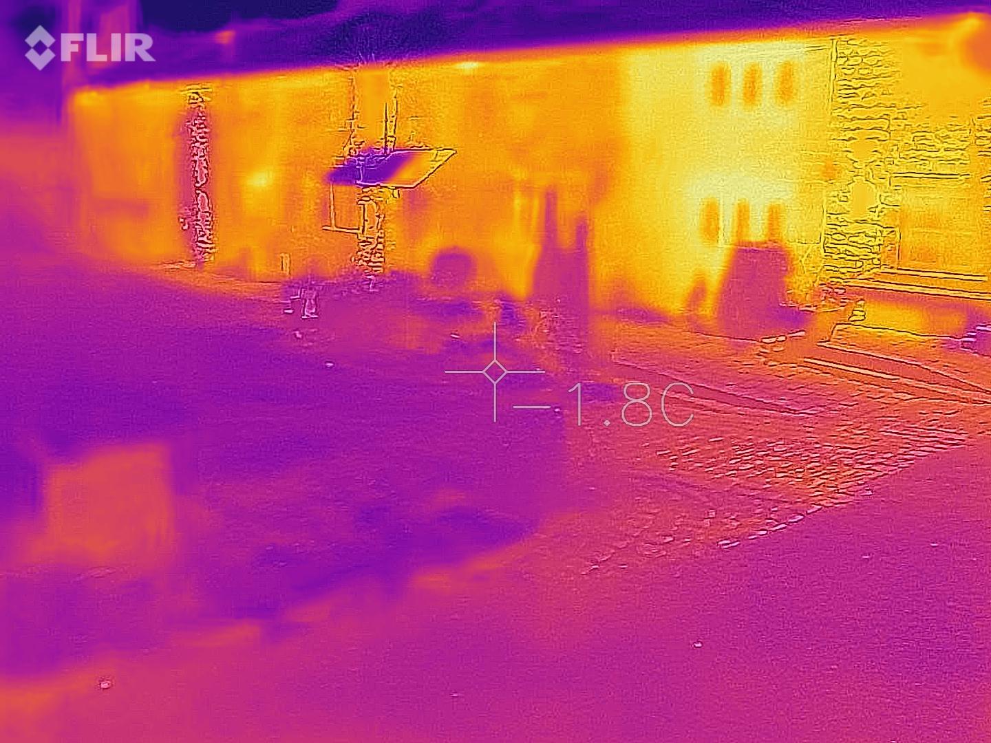

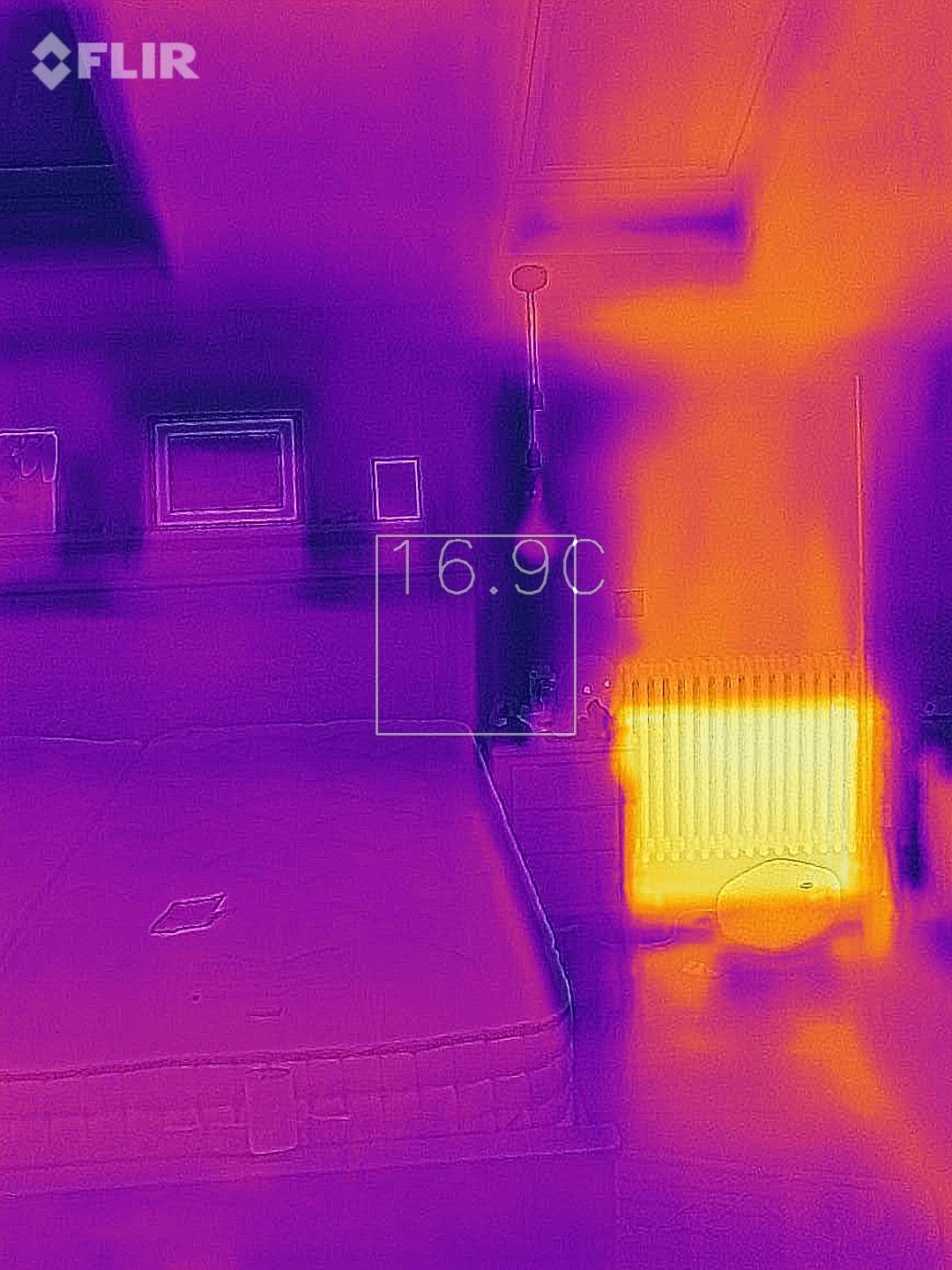

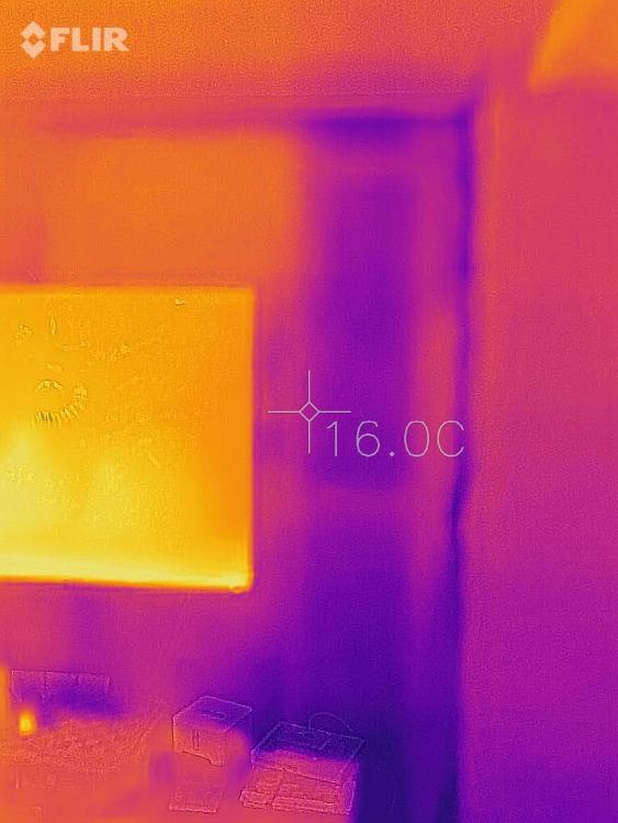

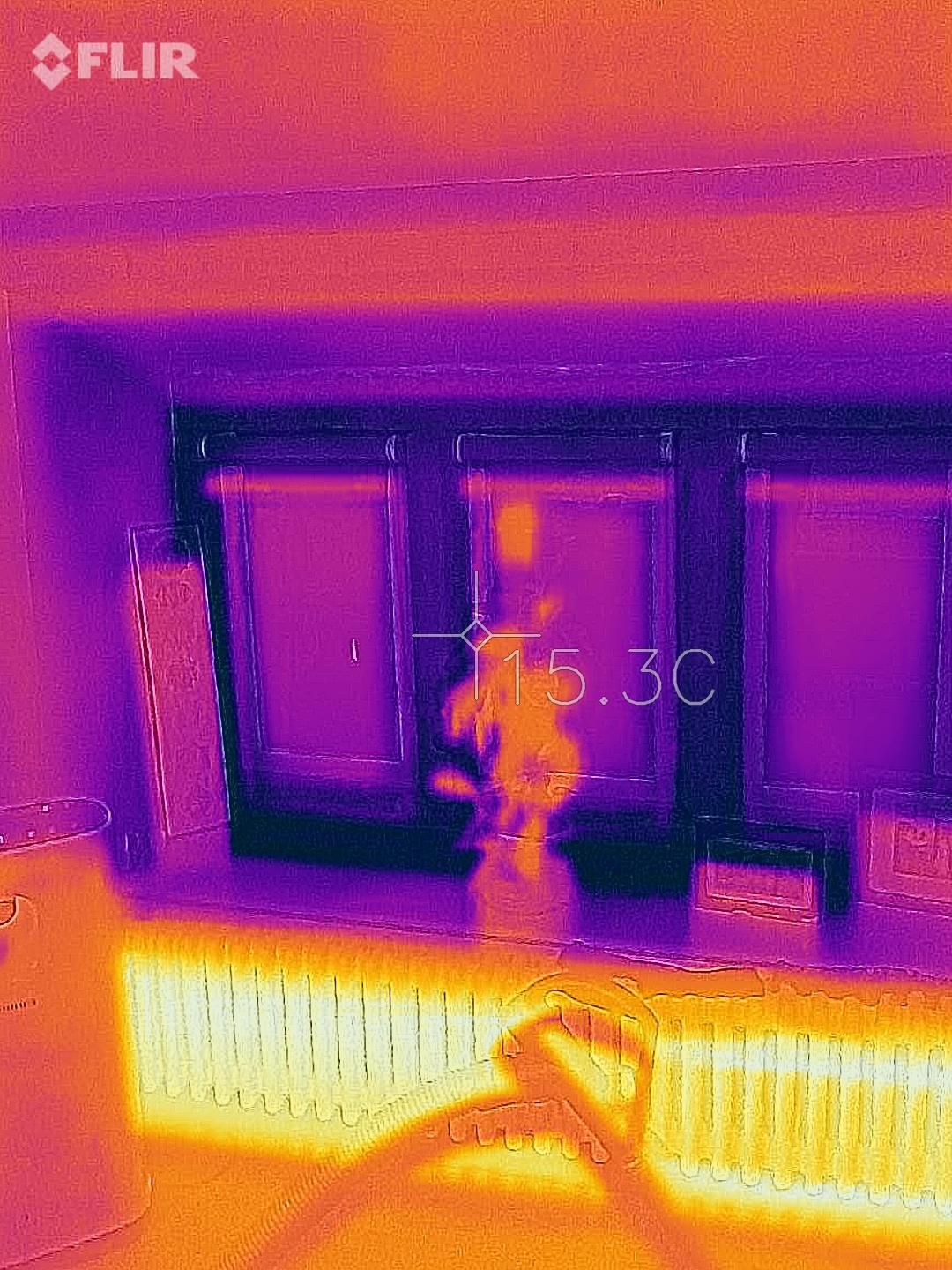

Benjseb Posted March 7, 2020 Author Posted March 7, 2020 So I took the plunge and purchased a FLIR One camera for my phone to investigate heat loss my suspicions were correct see image below. The rather yellow end of the house is our lounge and master bedroom. Clearly losing more heat than the rest of the building from inside I can also see some areas where the insulation is missing so next job is to pull the plasterboard off and reinsulate. If we can bear the mess! The original stone millions around the windows are like fridges too so may need to switch those for something with a bit less cold bridging going on. 2
AliG Posted March 7, 2020 Posted March 7, 2020 We have stone mullions too, it is the lack of insulation on the plasterboard on the inside that is probably the issue. On the second picture, taking the plasterboard on that wall off and replacing it with insulated board would probably make a big difference, the walls are older than the windows. Also when you take it off you can make sure that there are no holes around the frames. On the first picture I think the problem is the placing of the radiator. The heat appears to be rising right up into the Velux window and not getting anywhere else in the room. Assuming that you aren't going to move the radiator or replace the Velux windows. You might try blinds across the windows in the winter and see if that reduces heat loss. You might want to try a shelf above the radiator or one of those fans that you attach and use to send heat into the room.
Benjseb Posted March 7, 2020 Author Posted March 7, 2020 (edited) 13 minutes ago, AliG said: We have stone mullions too, it is the lack of insulation on the plasterboard on the inside that is probably the issue. On the second picture, taking the plasterboard on that wall off and replacing it with insulated board would probably make a big difference, the walls are older than the windows. Also when you take it off you can make sure that there are no holes around the frames. On the first picture I think the problem is the placing of the radiator. The heat appears to be rising right up into the Velux window and not getting anywhere else in the room. Assuming that you aren't going to move the radiator or replace the Velux windows. You might try blinds across the windows in the winter and see if that reduces heat loss. You might want to try a shelf above the radiator or one of those fans that you attach and use to send heat into the room. Good point about the window surrounds. I had a quick peek behind a section of plasterboard about a year ago when some electrical work was being done. Seems the Kingspan insulation was “thrown in” ?? The other issue we have though is the stone mullions being about 5c so they attract any moisture in the air and over time start to go mouldy. When we moved in they were black! We cleaned them off and have lowered the humidity about 10% since but bring quite sensitive to mould I’d rather not have any surfaces that are that cold compared to the room. We’ve had a quite for replacements with a thermal break but I’m not convinced how much better they will be. And at £1500 a pop without glazing they are quite expensive. Seems that would require quite some effort to replace anyway so we were thinking it may just be worth putting a lintel in and using normal casement windows moving forward. And yes I see your point with the velux. We do have blinds already, but I think a shelf would work well. No chance of a radiator fan in the bedroom, the Mrs can hear a pin drop a mile off ? Edited March 7, 2020 by Benjseb
AliG Posted March 7, 2020 Posted March 7, 2020 So is there actually a stone surface on the inside too? I assumed it was just stone outside and plastered or covered in plasterboard on the inside. If it is stone all the way through then I see the problem. If you don't want to lose the stone, would secondary glazing right across the whole area not be a better and cheaper solution?
Benjseb Posted March 7, 2020 Author Posted March 7, 2020 12 minutes ago, AliG said: So is there actually a stone surface on the inside too? I assumed it was just stone outside and plastered or covered in plasterboard on the inside. If it is stone all the way through then I see the problem. If you don't want to lose the stone, would secondary glazing right across the whole area not be a better and cheaper solution? yes it’s all stone and from the feel of it zero thermal break. We could secondary glaze I guess. I need to look at the options. We have the same in the lounge downstairs. They do tend to leak slightly in heavy driving rain too I wonder if secondary glazing is just delaying the inevitable. I shall find someone who knows a lot more than me about windows to take a look and give us a quote! Generally that part of the house must have been renovated at a different time. The rest is cosy You can see if the pic attached how there’s no/very little insulation on the inner stud wall in the lounge too (hot spot is TV)
AliG Posted March 7, 2020 Posted March 7, 2020 You'd need planning permission to do away with the mullions as that is not a straight window replacement. Are you in a conservation area? I doubt you'd get permission for such a change on what looks like quite an old building (from the IR pictures). The great thing about secondary glazing is it would provide a break to the mullions which are creating more heat loss than the windows. It would also reduce condensation on the inside of them. You could buy some cheap plastic film and tape it over the area to get an idea of how much benefit you would get.
