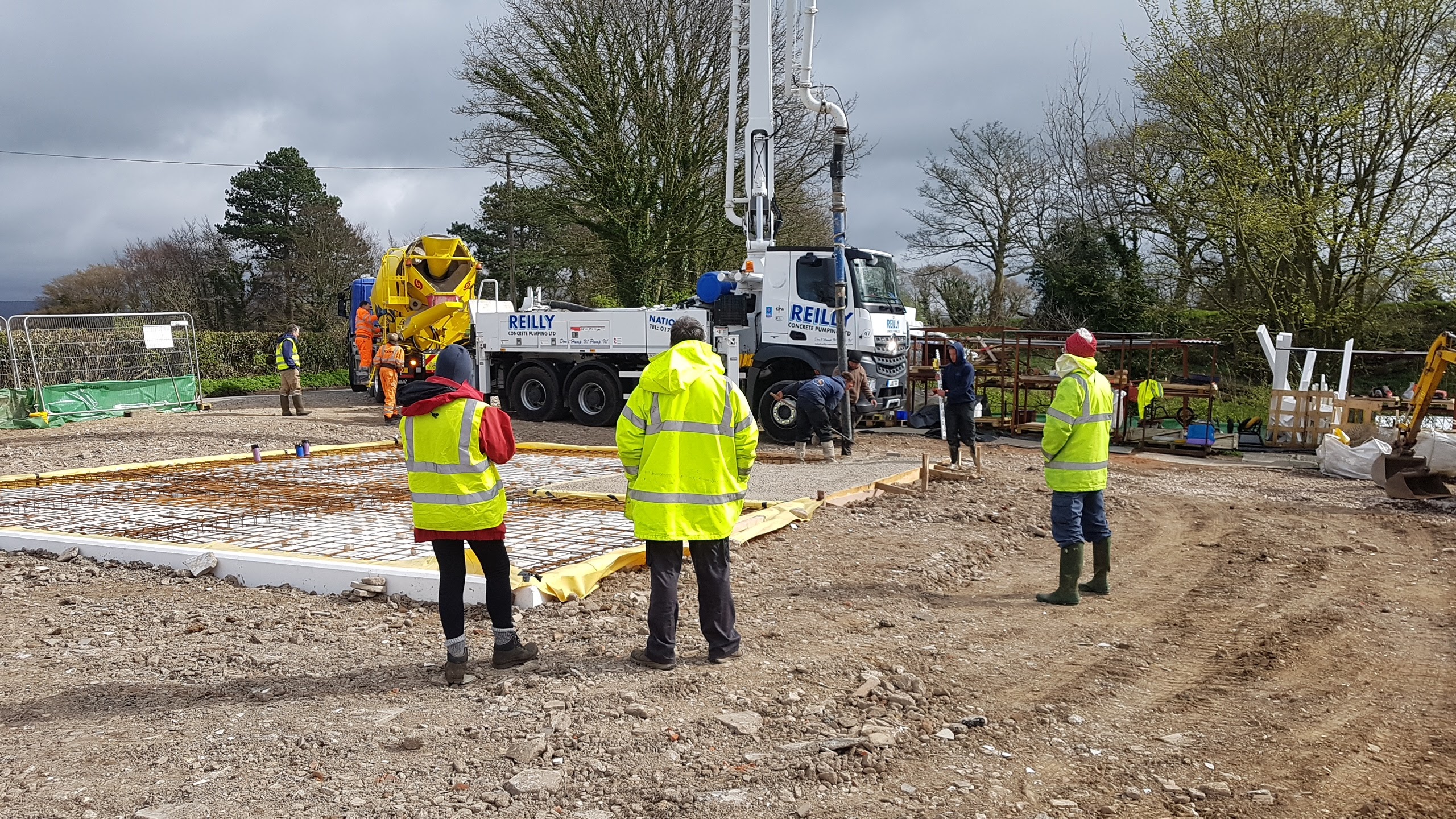

Hi, @RichS; not sure what you mean by skirt, but, since you ask,  do you mean something like this?
The vertical white EPS300 'skirt' (on the LHS of the image) is designed to prevent well, reduce the cold bridge from the side of the slab.
By contrast, the area being poured isn't part of the heated envelope, and so doesn't have a skirt.
See you in Mayorkshire (as my lad calls it) at the end of April.
Ian
Sorry, probably a bad description.
I mean the EPS that is outside the perimeter of the building envelope, only appears to be about 50/70mm thick
1 hour ago, RichS said:
[...]I mean the EPS that is outside the perimeter of the building envelope, only appears to be about 50/70mm thick
That's interesting. We'll find out more later this month
