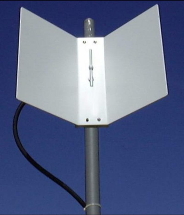

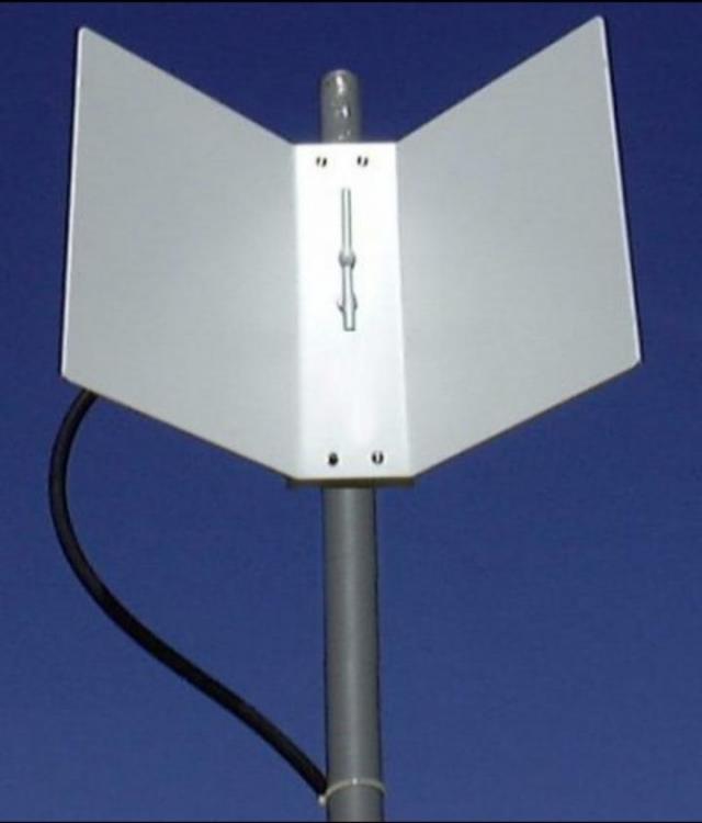

Onoff Posted February 16, 2020 Posted February 16, 2020 +1 on aerialsandtv. I went with a specific Band A Yagi here in the end. Vastly superior to the "WB", wideband tat you get from the DIY sheds. If you're in a weak or fringe area I'd go band specific everytime. Just check what your transmitter puts out. Mind I've made a few aerials along the way. My favourite is the corner reflector/ trough antenna. Still got 2 neighbours running on these that I made, one in sheet ali and one in galv mesh. Can integrate well on a gable end with just the top and bottom "wings" and dipole visible. Windage can be a problem. The ones I've done are horizontally polarized to suit the transmitter. I'm unfortunate being at the lowest elevation of all of us. My Yagi is on a pole about 100' from the house if not more. 1
