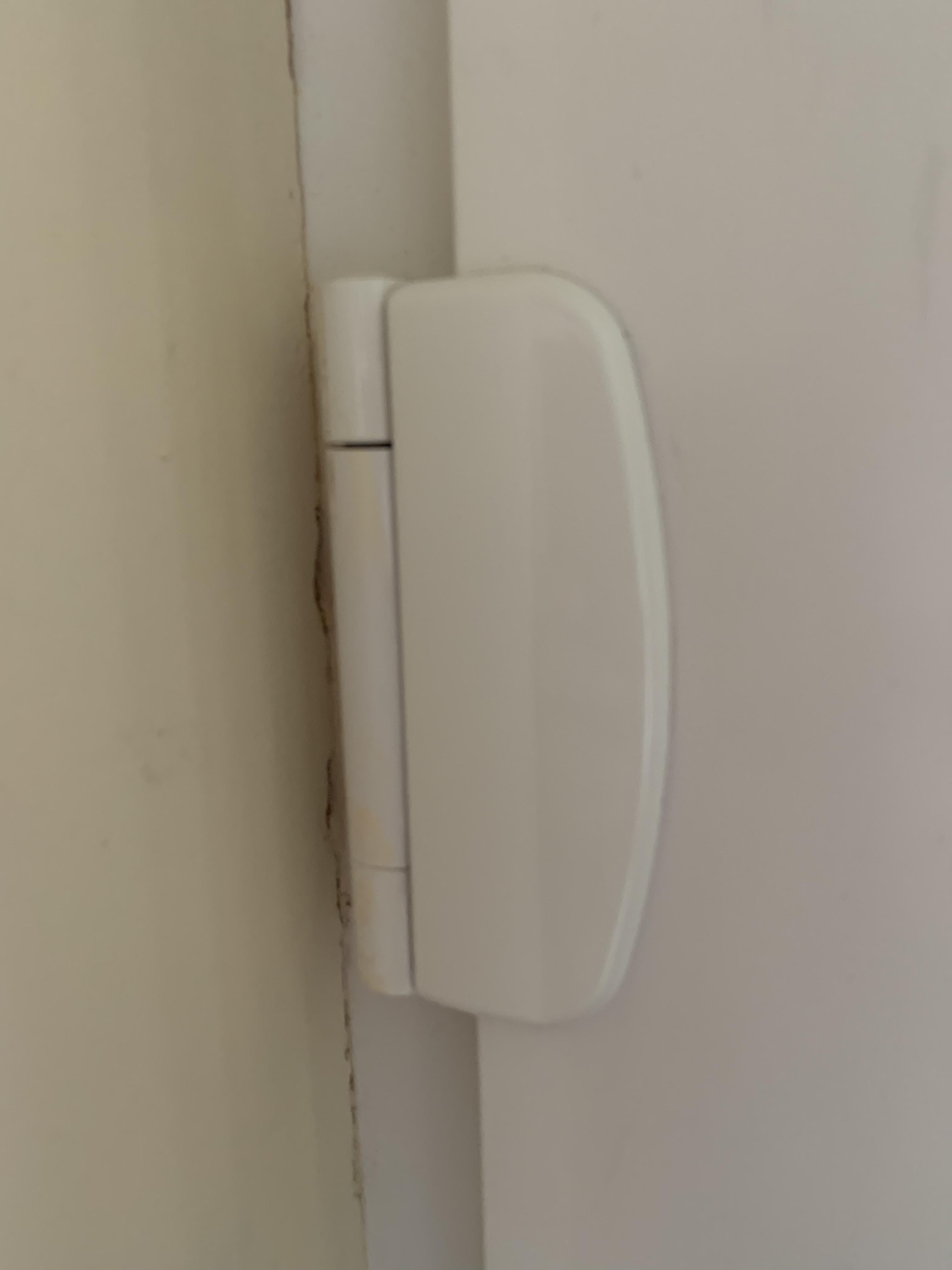

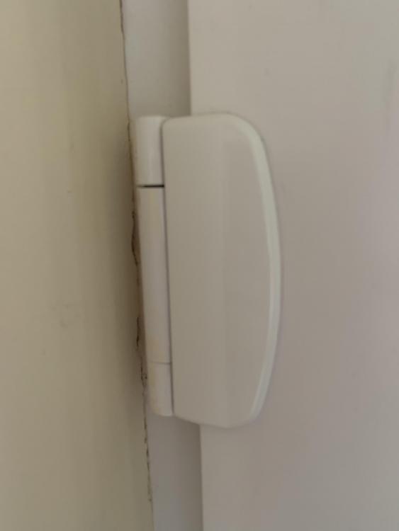

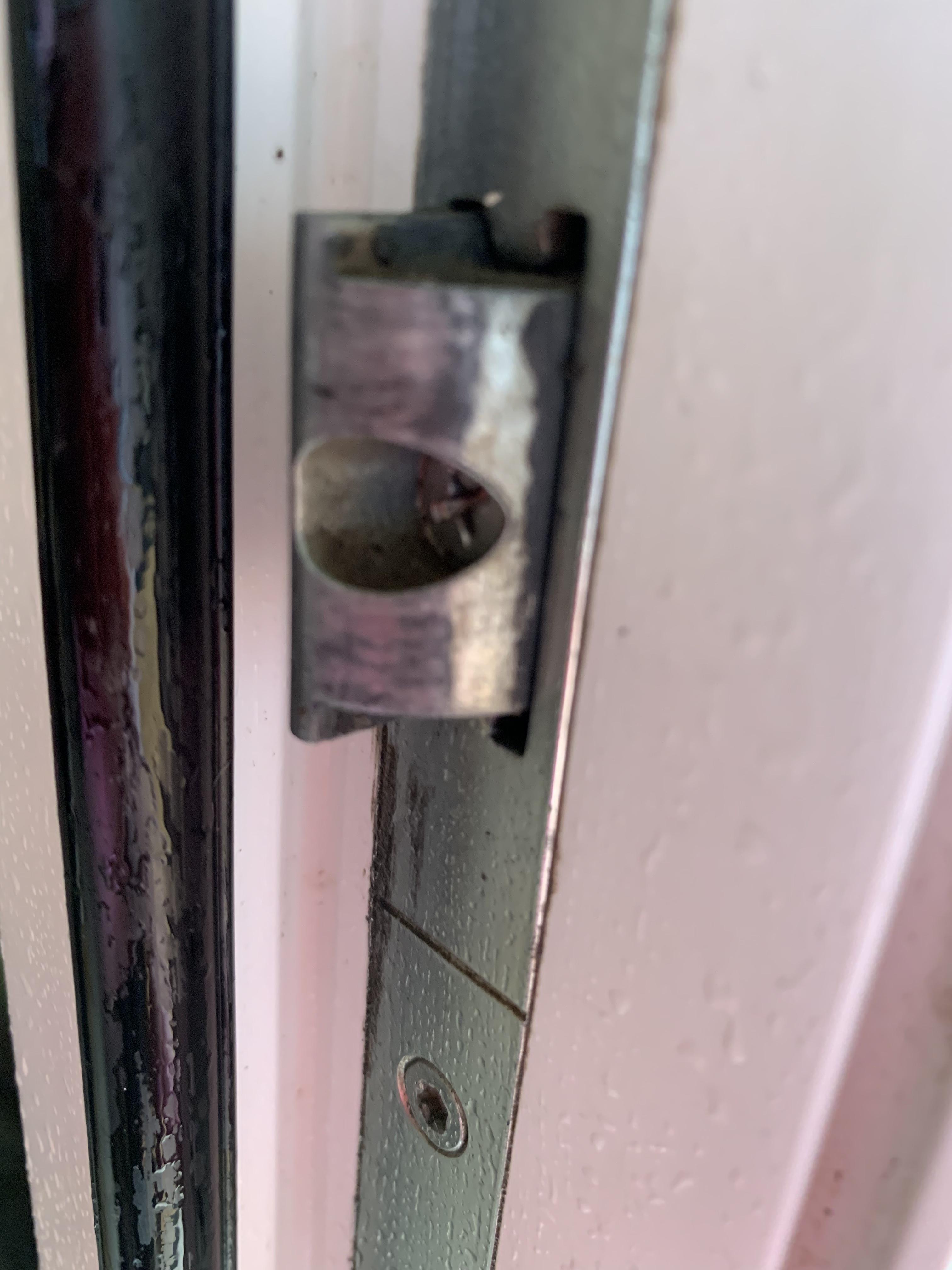

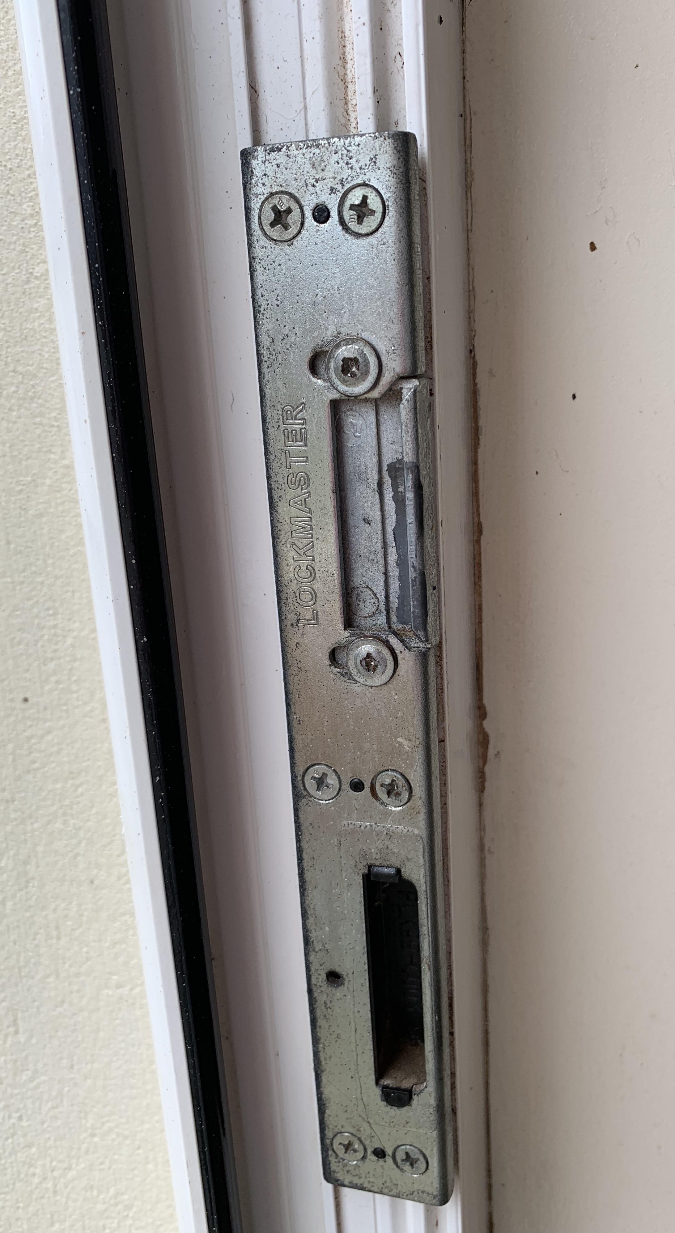

newhome Posted February 14, 2020 Posted February 14, 2020 Storm Ciara seems to have done something to my back door as it no longer seals properly against the frame and there is a draught coming through. I’ve tried adjusting the mechanism to push the door nearer to the frame (see pic) and that has helped to a degree but if I adjust it any further the door doesn’t latch properly and the locking mechanism won’t work. Photo is of the middle section. There are 2 similar adjusters at the top and bottom. The seal looks ok I think in that it’s not perished anywhere but if I press the door against the frame when it’s closed the door moves in and the seal clearly works because the draught stops. Do they do thicker ones? I reckon it’s a few mm out currently but the effect is massive from a draught perspective. Anything else I can try please?

ToughButterCup Posted February 14, 2020 Posted February 14, 2020 Do your hinges have adjusters in them?
newhome Posted February 14, 2020 Author Posted February 14, 2020 2 minutes ago, AnonymousBosch said: Do your hinges have adjusters in them? Hmm, not sure. How can I tell please?
bassanclan Posted February 14, 2020 Posted February 14, 2020 Difficultto tell if they are flag hinges or butt hinges. Flag can be adjusted https://www.windowware.co.uk/news/how-to-adjust-a-flag-hinge

ToughButterCup Posted February 14, 2020 Posted February 14, 2020 This hinge looks very slightly out of line - maybe just the camera angle ....

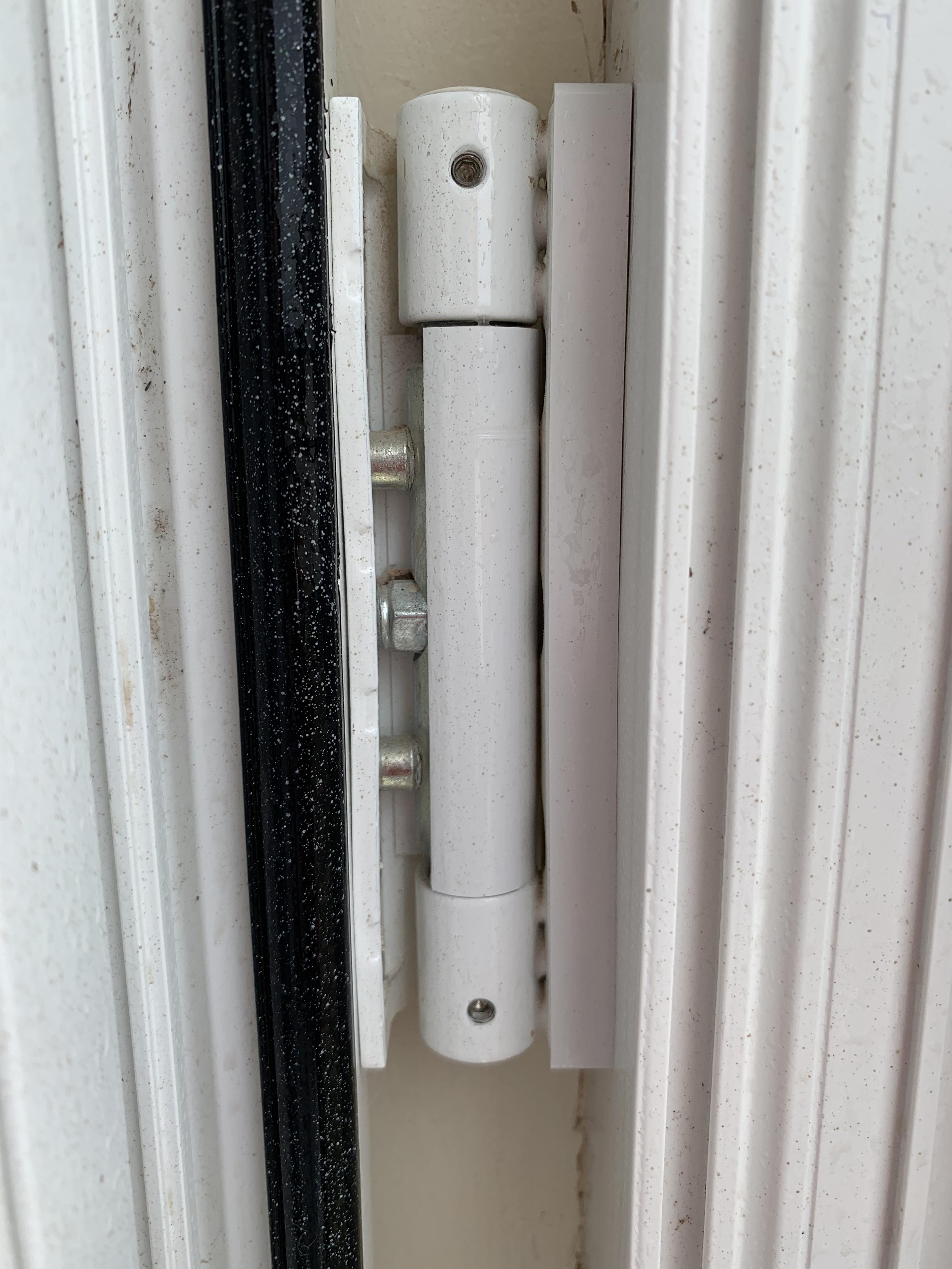

Ferdinand Posted February 14, 2020 Posted February 14, 2020 See if you can get a look under that cover.

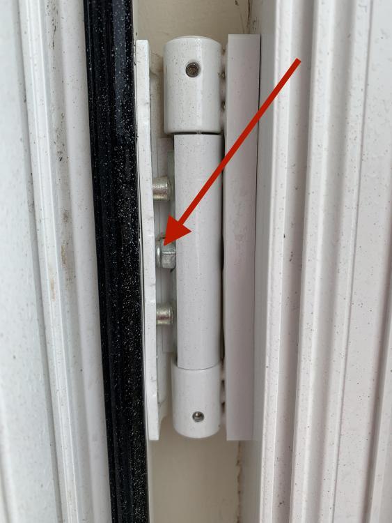

PeterW Posted February 14, 2020 Posted February 14, 2020 This is the adjuster - you need a thin 10/12mm spanner. Cheap cycle spanner will help.
