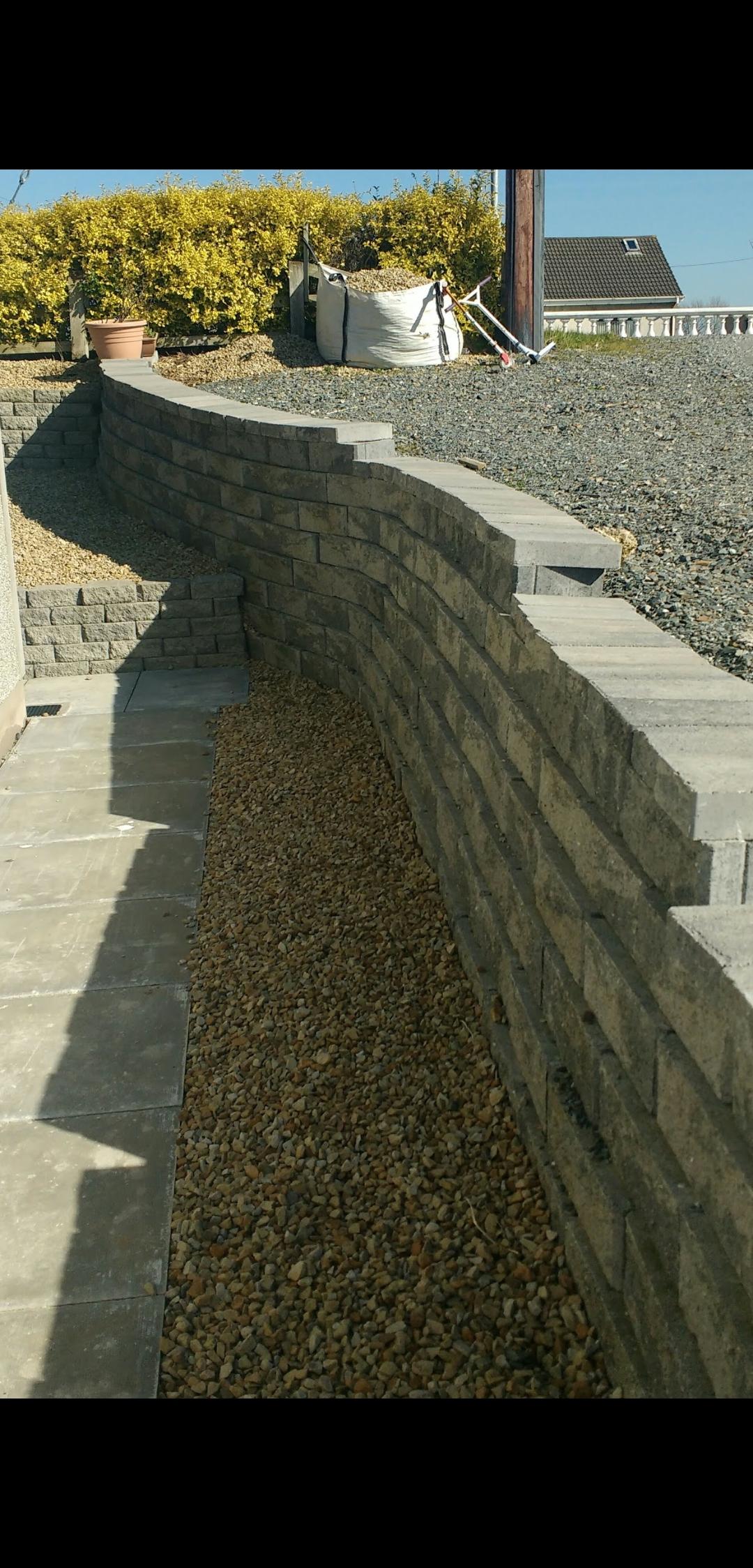

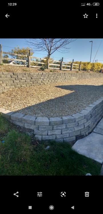

Declan52 Posted February 12, 2020 Posted February 12, 2020 Do you mean this type of retaining wall??? If so they are pretty easy to build. They require no concrete just a well compacted hardcore base. And then it's just lift and set down and lift and set down. The back of the blocks have a lip so they can't push of the bottom block. Depending on how high you need to go will dictate the size of the blocks you need. The small ones in my front garden can go to 0.9m and that's it. The bigger ones can go to a few metres if you build in membranes along the way. Like all walls like this you need a drain at the back to get rid of any water plus plenty of clean stone like pea gravel to backfill it all in.

Declan52 Posted February 12, 2020 Posted February 12, 2020 They make it pretty close to me so my price won't be anywhere close to what you will get charged. I done my 5+ years ago as well . There are plenty of companies who do this type of block. I got mine from this one. https://ag.uk.com/retaining-wall/anchor-diamond/

Declan52 Posted February 12, 2020 Posted February 12, 2020 2 minutes ago, Conor said: I had this discussion with my architect last week. We require a couple retaining walls in the region of 2.5m high. The engineers design for reinforced concrete look scary and expensive. However, the interlocking block option works out more expensive and much more time consuming at that scale. Same for gabions, as you end up with a wall just as thick as it is high. It would be the quickest method by far off doing a small retaining wall. I done that large wall in a few hours. It's about 15m long by 1.2m high. Once you go over that height then you need to be backfilling as you go which will really slow you down plus building in the membrane. You could step it so have 2 walls at 1.2m. much the same as I done with my front garden but move them closer together.
