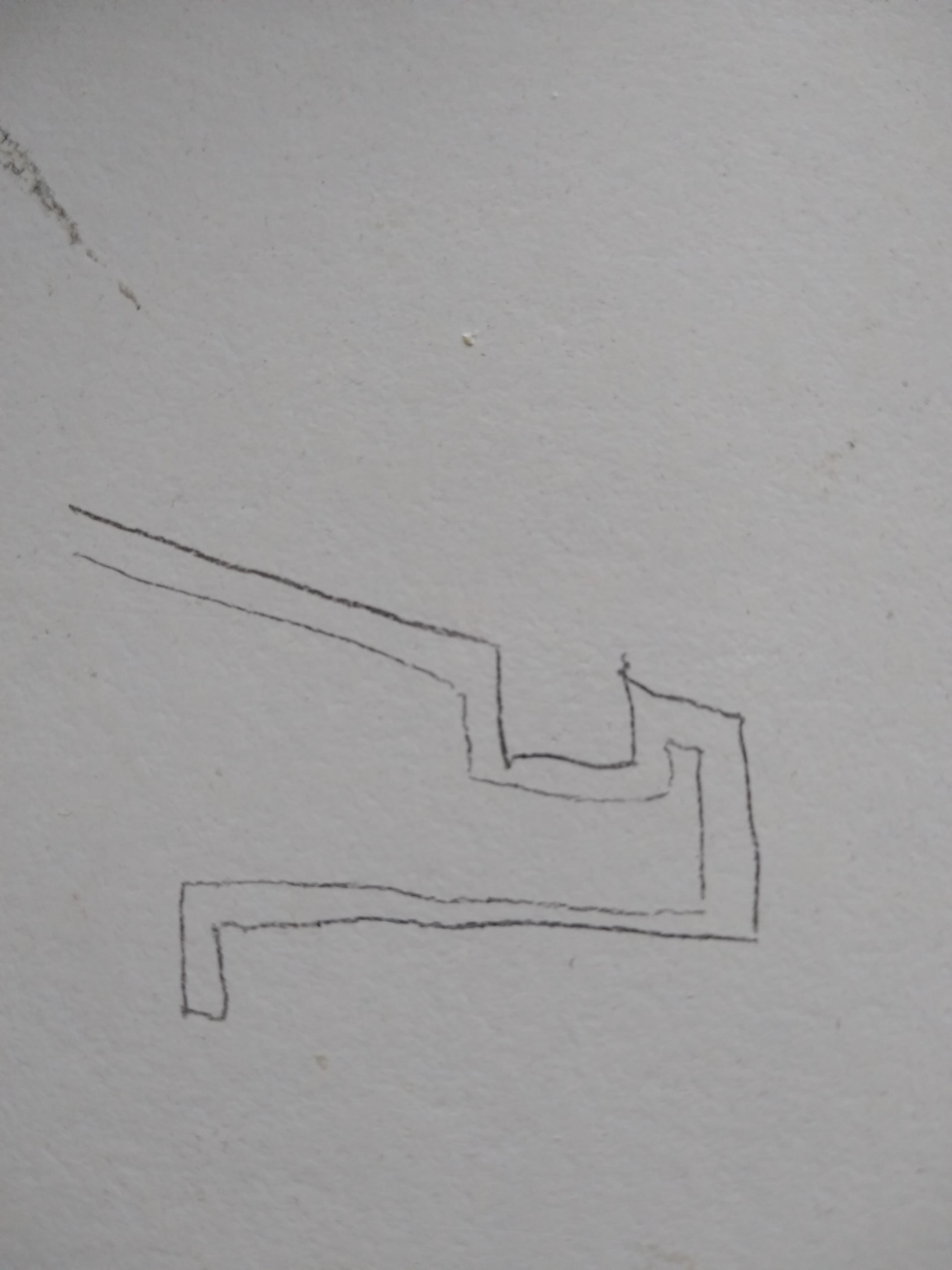

RichC Posted February 12, 2020 Author Share Posted February 12, 2020 I just went back to look at the pictures of your build Ed. I see that you put the posts individually on the brackets. I wonder how practical it would be to use those if the whole wall was already pre-assembled before being lifted up onto the brackets. Would be disappointing to find out that the flange was a cm off.... ...but as I write this I realise that that could be alleviated by aligning the flange in the same plane as the wall Rich. Link to comment Share on other sites More sharing options...
Ed Davies Posted February 12, 2020 Share Posted February 12, 2020 The flanges on my brackets are aligned east/west, parallel to the ridge line, and I think [¹] they contribute significantly to the east/west racking strength of the house so you couldn't turn them through 90°. When the posts and beams were up but before I started on the roof the structure was quite stiff east/west but swayed a bit north/south. [¹] Structural engineer specified this but we didn't, unfortunately, have a lot of discussion about it. Link to comment Share on other sites More sharing options...
SteamyTea Posted February 12, 2020 Share Posted February 12, 2020 (edited) Why don't they/we design a hinged bracket. That way you can assemble a wall, jack one end up onto the hinges, bolt/screw in place, then lift the wall vertical. Then some sort of locking plate on the bracket. Maybe 3 sided box section instead of two upright plates. Edited February 12, 2020 by SteamyTea Link to comment Share on other sites More sharing options...
Ed Davies Posted February 13, 2020 Share Posted February 13, 2020 Hinging is sort of what I did. Still, specifically designing a hinge to be used once then sit unhinged for decades seems a bit odd. Link to comment Share on other sites More sharing options...

Ed Davies Posted February 13, 2020 Share Posted February 13, 2020 1 minute ago, SteamyTea said: A simple, cheap hinge, which could be removed and reused Ah, right, I was assuming incorporated in the structure. 2 minutes ago, SteamyTea said: Though you have picked a design that has long lengths. Doing it again I'd have longer lengths, but thinner. E.g, instead of making up the purlins out of 3 metre or so long lengths of 145x245 C24 (or was it C16? I forget without looking - I do remember the posts were specced as C16 but I actually used C24 as that was what was available) I'd have used 3 off 6 or 7 metre lengths of 45x245 or whatever lengths of LVL staggered and bolted together. The ring beam for the floor has 13 metre lengths like that which I could move fairly easily with a bit of forethought. Link to comment Share on other sites More sharing options...
