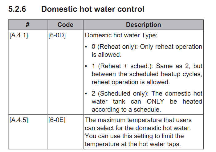

Jeremy Harris Posted February 9, 2020 Share Posted February 9, 2020 Usually there will be two main modes on an ASHP, heating mode, which will usually be set to deliver a flow temperature of around 35° to 40°C and hot water mode, which will usually be set to deliver a flow temperature of around 50° to 55°C. It's not clear from the manual whether or not the unit you have actually has a hot water mode. The manual isn't the easiest thing in the world to decode, either! All I can see on hot water control is this: And that's as clear as mud. . . It looks to me as if this model of ASHP doesn't actually have a hot water mode, and relies on using an immersion heater to boost the hot water up from the low temperature that the ASHP works at. That seems unusual, but then the unit is described as being a "low temperature monobloc", so it may be that this is a simplified unit that doesn't have an integral hot water capability, but relies on using an immersion heater for boost. Link to comment Share on other sites More sharing options...
DOIGAN Posted February 9, 2020 Author Share Posted February 9, 2020 4 minutes ago, Jeremy Harris said: Usually there will be two main modes on an ASHP, heating mode, which will usually be set to deliver a flow temperature of around 35° to 40°C and hot water mode, which will usually be set to deliver a flow temperature of around 50° to 55°C. It's not clear from the manual whether or not the unit you have actually has a hot water mode. The manual isn't the easiest thing in the world to decode, either! All I can see on hot water control is this: And that's as clear as mud. . . It looks to me as if this model of ASHP doesn't actually have a hot water mode, and relies on using an immersion heater to boost the hot water up from the low temperature that the ASHP works at. That seems unusual, but then the unit is described as being a "low temperature monobloc", so it may be that this is a simplified unit that doesn't have an integral hot water capability, but relies on using an immersion heater for boost. God, thank you Jeremy, I thought it was just me that could not wrap my head around the manual. I will try and phone Daiken technical to see if they can shed any light on it, I was hoping for divine inspiration from someone on here to be honest Link to comment Share on other sites More sharing options...

Jeremy Harris Posted February 9, 2020 Share Posted February 9, 2020 Looking at the wiring diagram for the indoor control box, there doesn't seem to be provision for getting the ASHP to operate in a hot water mode, just a relay that can turn the immersion on or off. As @ProDave mentioned above, running at a constant temperature seems to work well, it's how I've set ours up. You could try altering the heating curve settings to set the unit to a fairly high constant flow temperature, say 45°C, as a compromise that might get the hot water tank a bit warmer by using the heat pump. I'm struggling to see if there's a setting to adjust the temperature at which the immersion relay kicks in, but if there is, then increasing that, along with setting a fixed flow temp that's around 45°C might work OK. You have the advantage up there of a reasonable climate for an ASHP. Another member here, @Stones, lives on Orkney, and he has an ASHP that seems to perform well. Link to comment Share on other sites More sharing options...

arg Posted March 2, 2020 Share Posted March 2, 2020 On 09/02/2020 at 16:01, Jeremy Harris said: It looks to me as if this model of ASHP doesn't actually have a hot water mode, I happened to be reading the manuals for this thing recently (it's a candidate for my install when I get to that point later in the year). I concluded that it DOES have a seperate hot water mode; there's supposed to be a motorised valve to divert the flow water to either the space heating or the water tank coil. There's separate configuration of the tank target temp(s). There's several documents online, this one "installer reference" seems more detailed than the "installation maual". https://www.daikin.co.uk/content/dam/document-library/Installer-reference-guide/heat/EBLQ05-07CV3-EDLQ04-07CV3_4PEN405544-1D_Installer Reference Guide_English.pdf The exact capabilities of the unit are a bit unclear as it is documenting the whole system including the "optional" backup (resistance) heater, but as I read it the maximum capability of the heatpump alone is 50C (it says you can set it for 55C but won't reach that in low temperature conditions). You can set the tank target temp up to 80C but that will invoke the resistance heater. The bit you quoted earlier about reheat/scheduled setting is to avoid the DHW demand taking away from the space heating since it can't supply both at once: you can have the DHW heated only on a timer (so deliberately chosen times when you don't anticipate using space heating, eg. overnight), or just on demand (so it will take away from space heating), or a compromise that tries to do it on the timer but will top up at other times if it falls below a threshold. There's a huge lot of settings on this thing and it could easily be set up wrongly such that it's only able to deliver less than its full output. Rated maximum input is 15.7A (=3.6kW) - interestingly the 5kW and 7kW versions are almost the same, suggesting that they share the same compressor and the 7kW unit just has a bigger fan/heat exchanger so there's more opportunity for it to run closer to flat out. Stated typical input powers are 1.55kW (at 35C water temperature) to 2.45kW (at 45C water temperature) given 7C ambient. So if it's taking an average of 1.16kW across the day and it's running continuously day and night, then there's quite a lot more capacity there to be turned up (though will of course cost you more money!). If it's only running 12 hours a day (and the resistance heater is disabled), then it's effectively flat out and the only way to get more heat out of it is to run it longer - use the scheduling to get the hot water tank heated in those other 12 hours, leaving the daytime hours to keep the lounge warm. If the 28kWh/day = 1.16kW average included significant amounts of resistance heater usage then there's scope to push the heat pump harder and get more heat for the same money. I think if it was me, I'd start by disabling the resistance heater and see what it's doing by itself. (NB. all the above just based on reading the manuals and analysing the numbers - I don't actually have one of these) Link to comment Share on other sites More sharing options...
