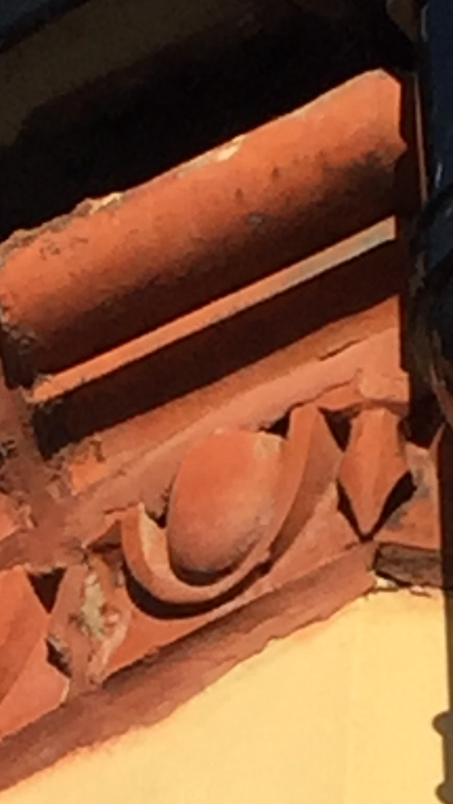

Dipy Posted February 9, 2020 Share Posted February 9, 2020 Hi, I need to replace one of these pieces, mainly the piece which is in the middle above the fancy bit ? Any advice where to get it from would be helpful too. Thanks Link to comment Share on other sites More sharing options...
ToughButterCup Posted February 9, 2020 Share Posted February 9, 2020 Try an architectural salvage company. Heres a list of our local ones - if you hint at your location in your profile, we'd be able to help you by suggesting sites local to you. ( Click on your Profile image - currently the green letter D - and edit you profile - top right> Edit Profile) 1 Link to comment Share on other sites More sharing options...
Temp Posted February 9, 2020 Share Posted February 9, 2020 Can't really see what the middle bit is. Could you cut a ridge tile to shape? 1 Link to comment Share on other sites More sharing options...
Ferdinand Posted February 9, 2020 Share Posted February 9, 2020 (edited) It looks like a terracotta or brick decorative moulding. Moulding is probably one word you can start from. Take one to a salvage yard, and say “this”. If there are lots of those on houses in your locality, then someone local should have one. May be worth gossiping down the street to see if anyone has a spare. Really need a wider piccie. Edited February 9, 2020 by Ferdinand 1 Link to comment Share on other sites More sharing options...
Simplysimon Posted February 9, 2020 Share Posted February 9, 2020 if it's at the top of a wall under the slates it will be a dentil 1 Link to comment Share on other sites More sharing options...
Dipy Posted February 9, 2020 Author Share Posted February 9, 2020 Thanks for that , I’ll try a salvage yard. Link to comment Share on other sites More sharing options...
Ferdinand Posted February 9, 2020 Share Posted February 9, 2020 (edited) more exactly .. decorative header corbel brick. compare to these: https://cawardenreclaim.co.uk/bricks/specials/decorative-corbelling Personally I think dentil may be the wrong direction as I think this is Gothic not Classical, and Dentil Is a classical term. Obvs that could be wrong and any term may put you in the ballpark. Edited February 9, 2020 by Ferdinand Link to comment Share on other sites More sharing options...
Critical Path Posted February 25, 2020 Share Posted February 25, 2020 The pattern is egg and Dart which represents life and death... everyday is a school day as they say! Link to comment Share on other sites More sharing options...
