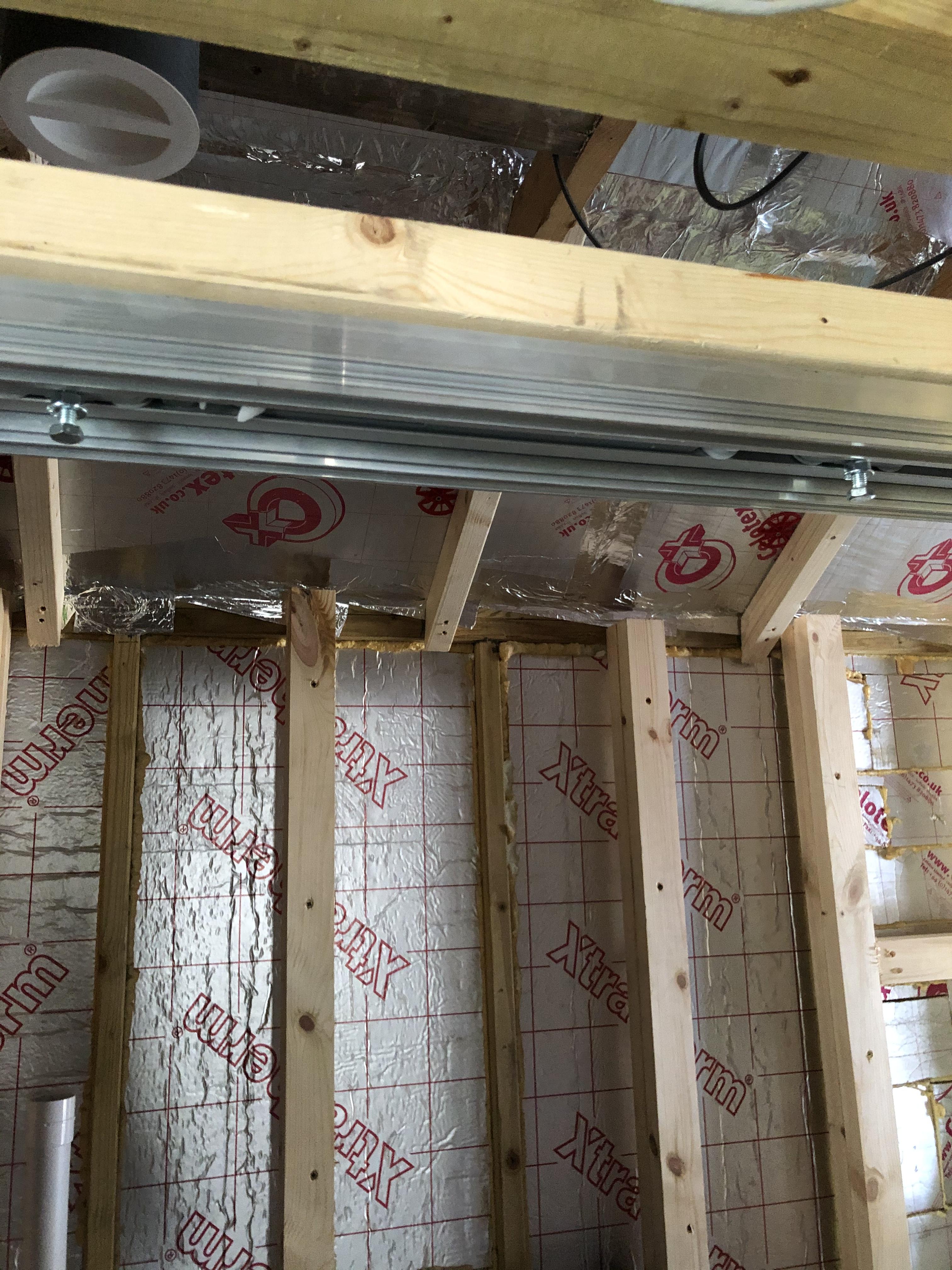

So that white strip is non removable and therefore you can't screw through the metal and replace the white strip? Where is the door stop?
Exactly .
The door stop ( as I understand it ) is in the anti slam mechanism in the horizontal header rail . I haven’t installed this yet as I don’t have the door . The instructions also ‘suggest’ screwing the metal frame from the rear which seems absurd - some kind of fixing would of helped

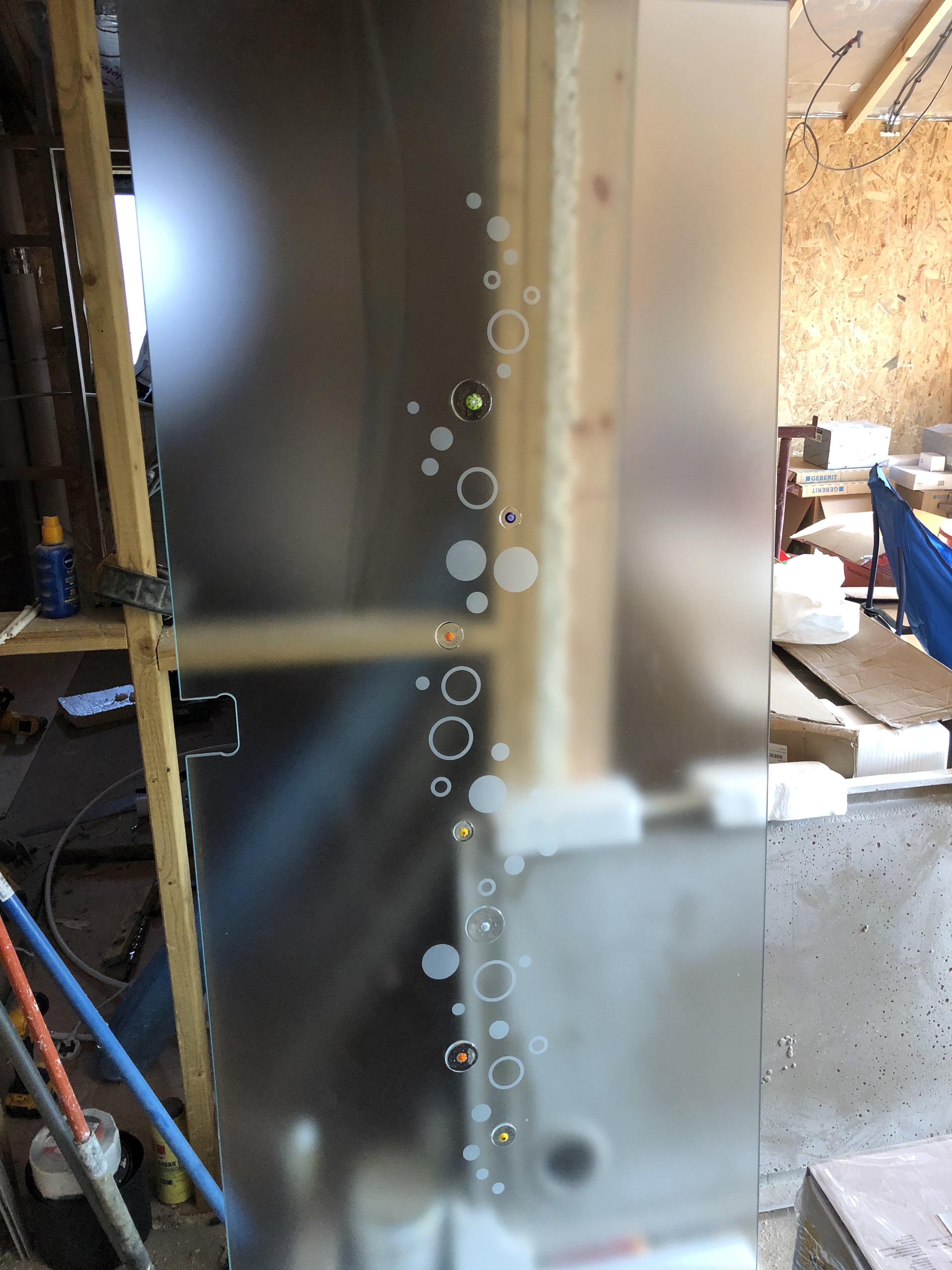

Apparently with a glass door you get a wooden doorstop post ( !! ) that glues over that vertical . So you can screw through the face of it . None the less I’ll wait for the actual door to turn up ....
  • Like 1
Posted
Here’s the exert
It’s a wooden doorpost designed the cover the current doorpost which converts it to suit the glass door. It’s glued over the top of the doorpost for the wooden door I believe, which would cover up the screw heads.
whatever ! Sounds like a bodge too me !

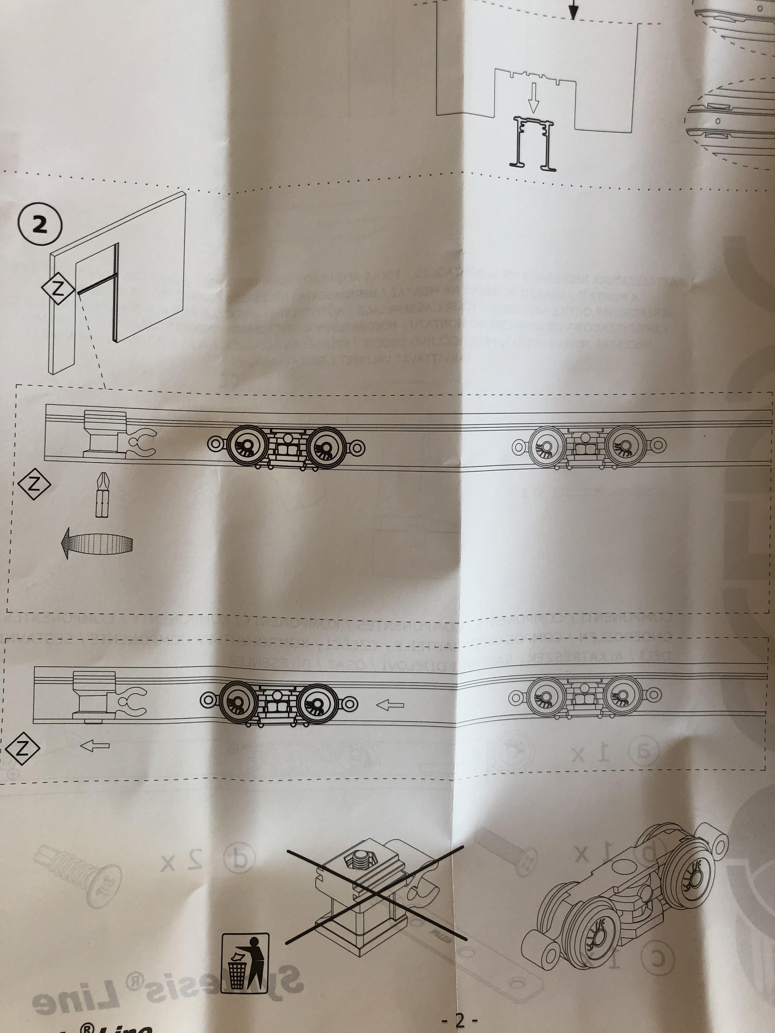

Like this . On the left shows an ‘end’ stop type thing in both pictures .
Then beneath it shows the end clip crossed out .
So need end clip don’t need end clip ?
Perhaps it’s me ( probably) or perhaps it’s just confusing . Trial and errors going to be a dog as door weighs 45kg

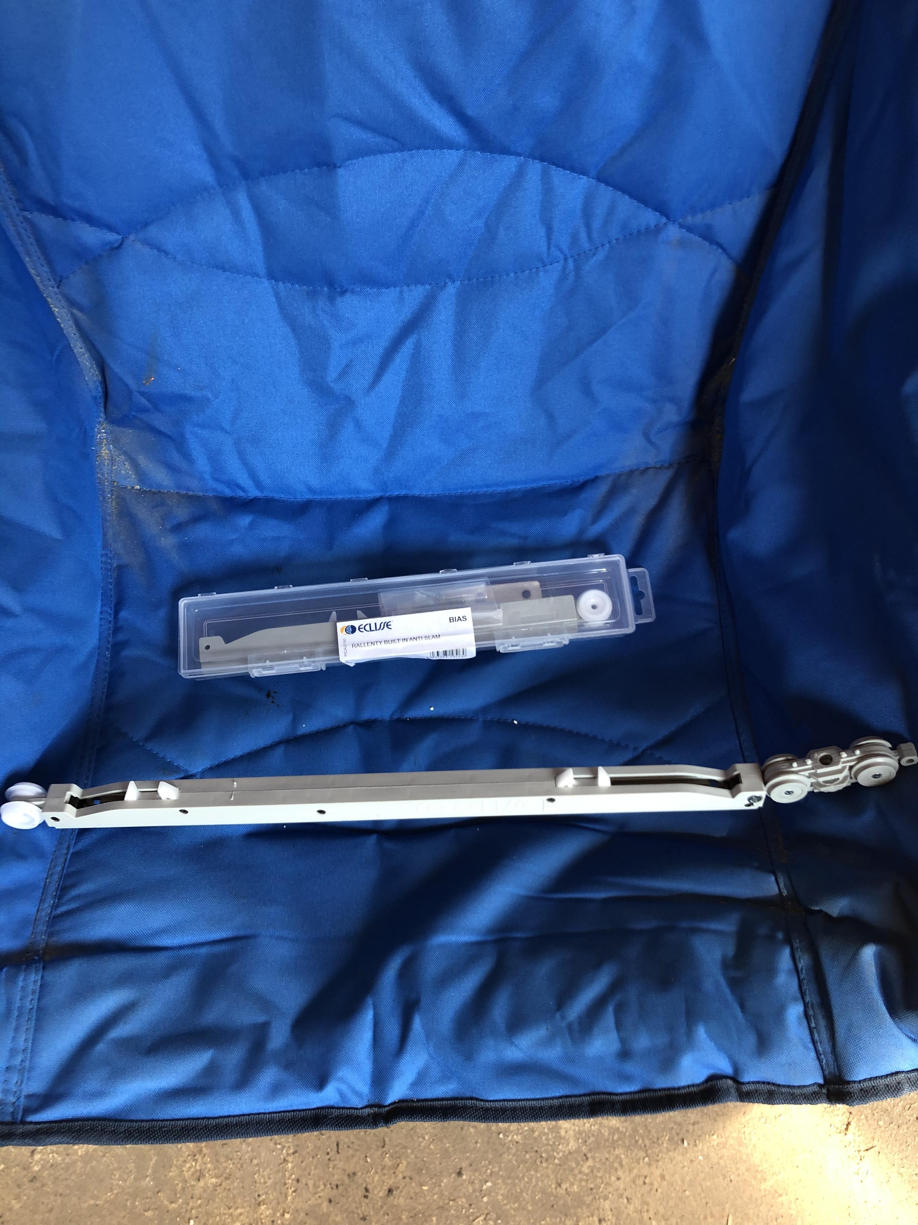

Or they send me 2 anti slam kits - so I have no idea which to use ( or how exactly it works ) - both different lengths
f ing Eclisse - hate them . Even their technical support didn’t seem to know - of course they are all in self isolation now ffs !
Posted
Pretty sure it's telling you to remove the end clip and put it in the bin (personally I'd hang on to it just in case).

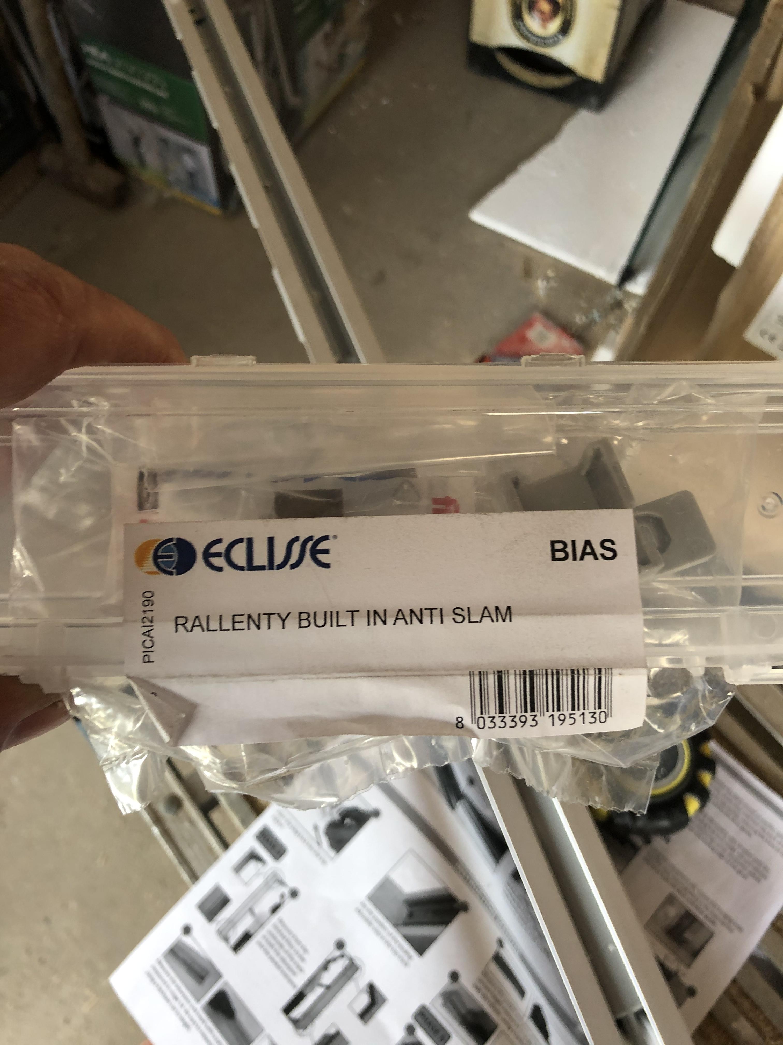

What's written on the label on the clear plastic box?
I'm wondering if you have anti slam kits for both wood and glass doors.

Posted
Quite possibly !

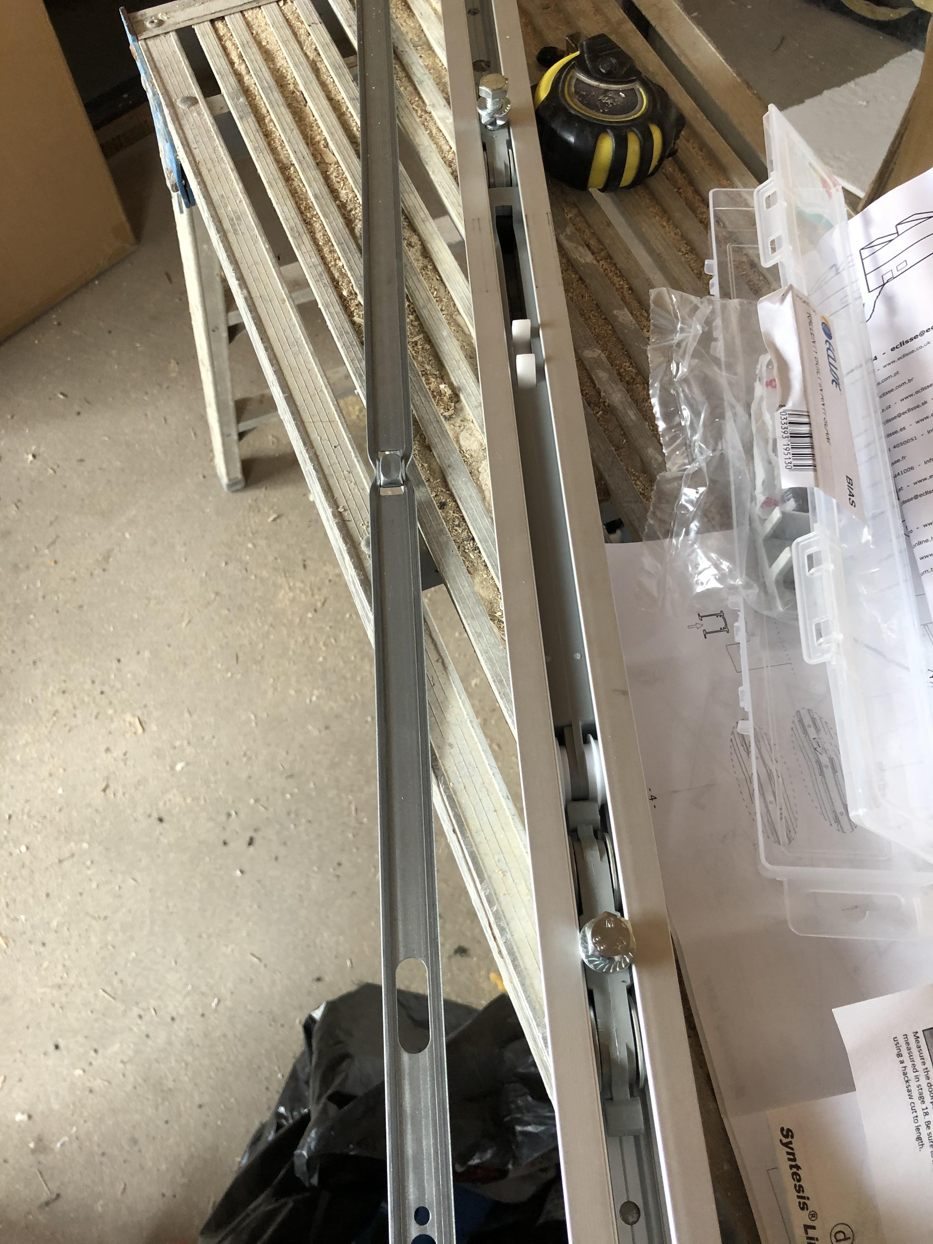

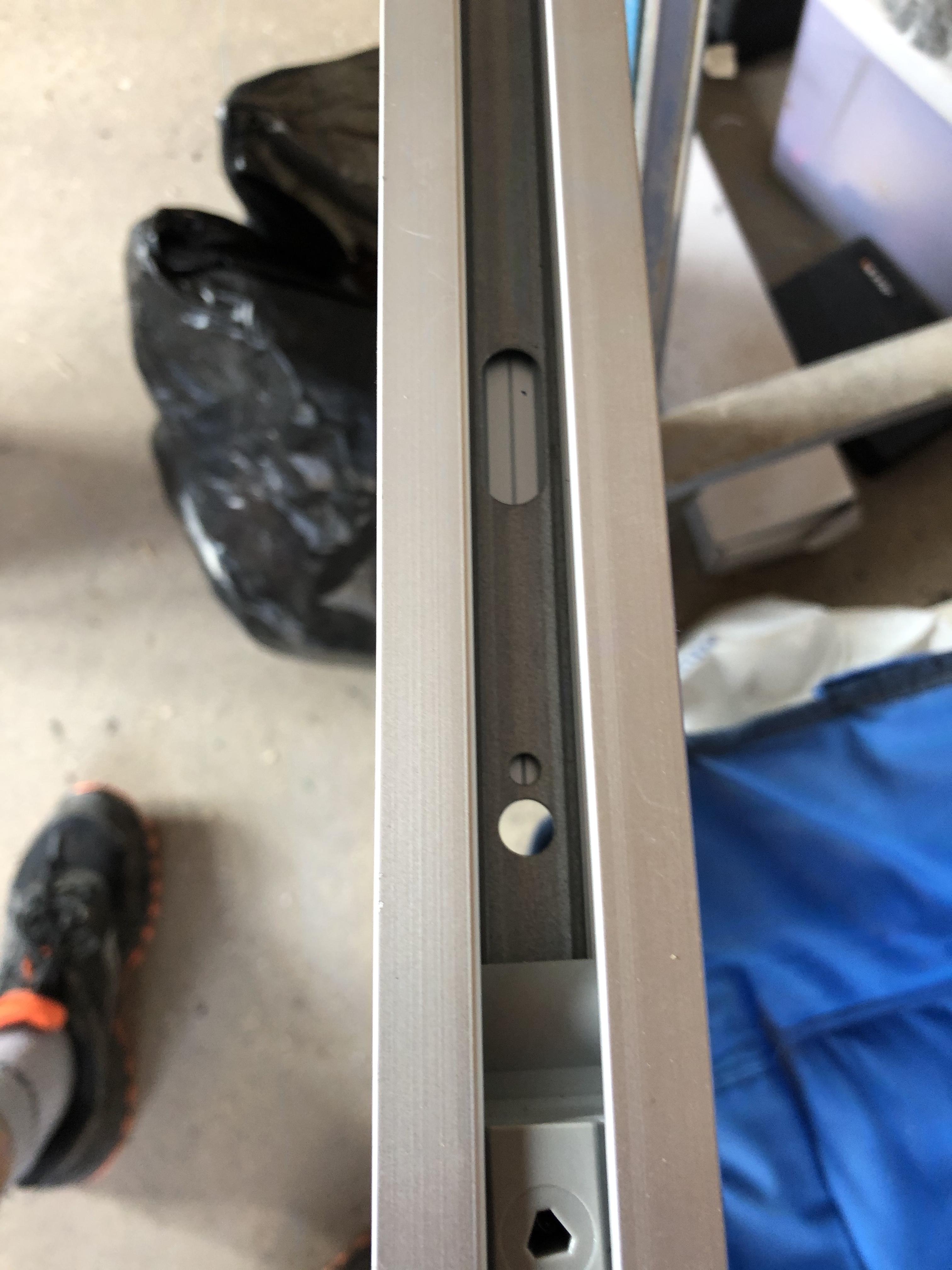

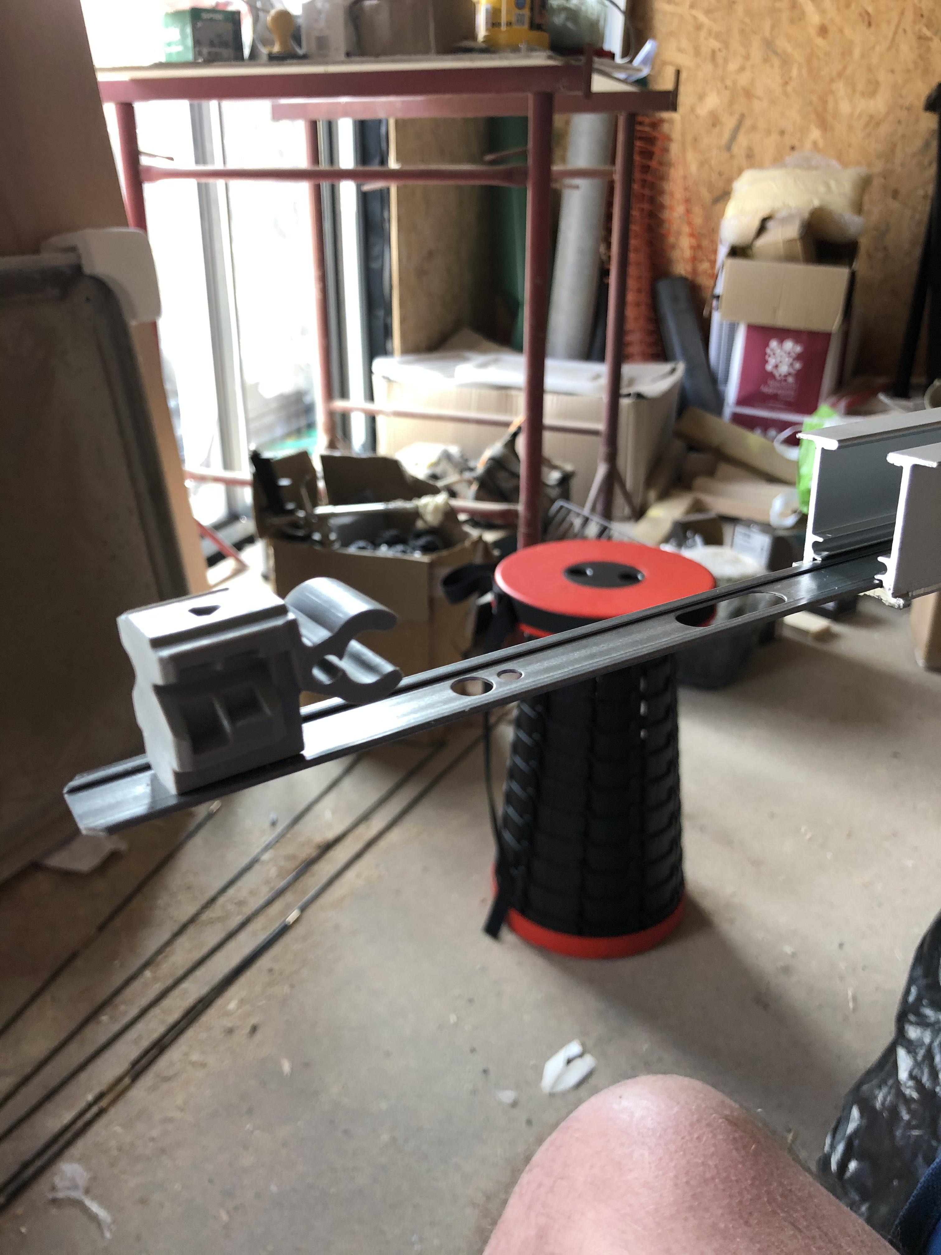

Also the sliding vertical track confuses me . You’ve got the sliding bits . But there’s another track in there that moves - don’t understand that at all .
Also have the ‘double side ‘ anti slam . It shows a single door ( not double ) so assumed anti slam on opening and closing ...
I’ve gone with the Rallenty one for now .But the sliding metal has a ‘bit’ that stops the runner ....
Better photo of slidy rail inside rail . Also the bump that stops everything !

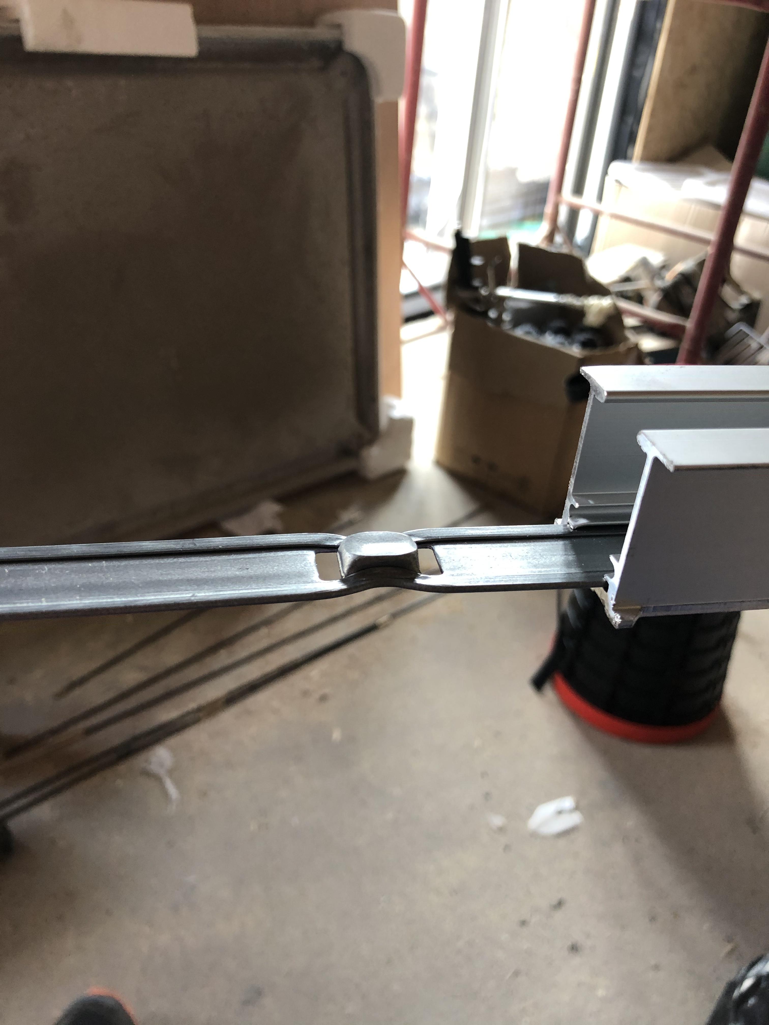

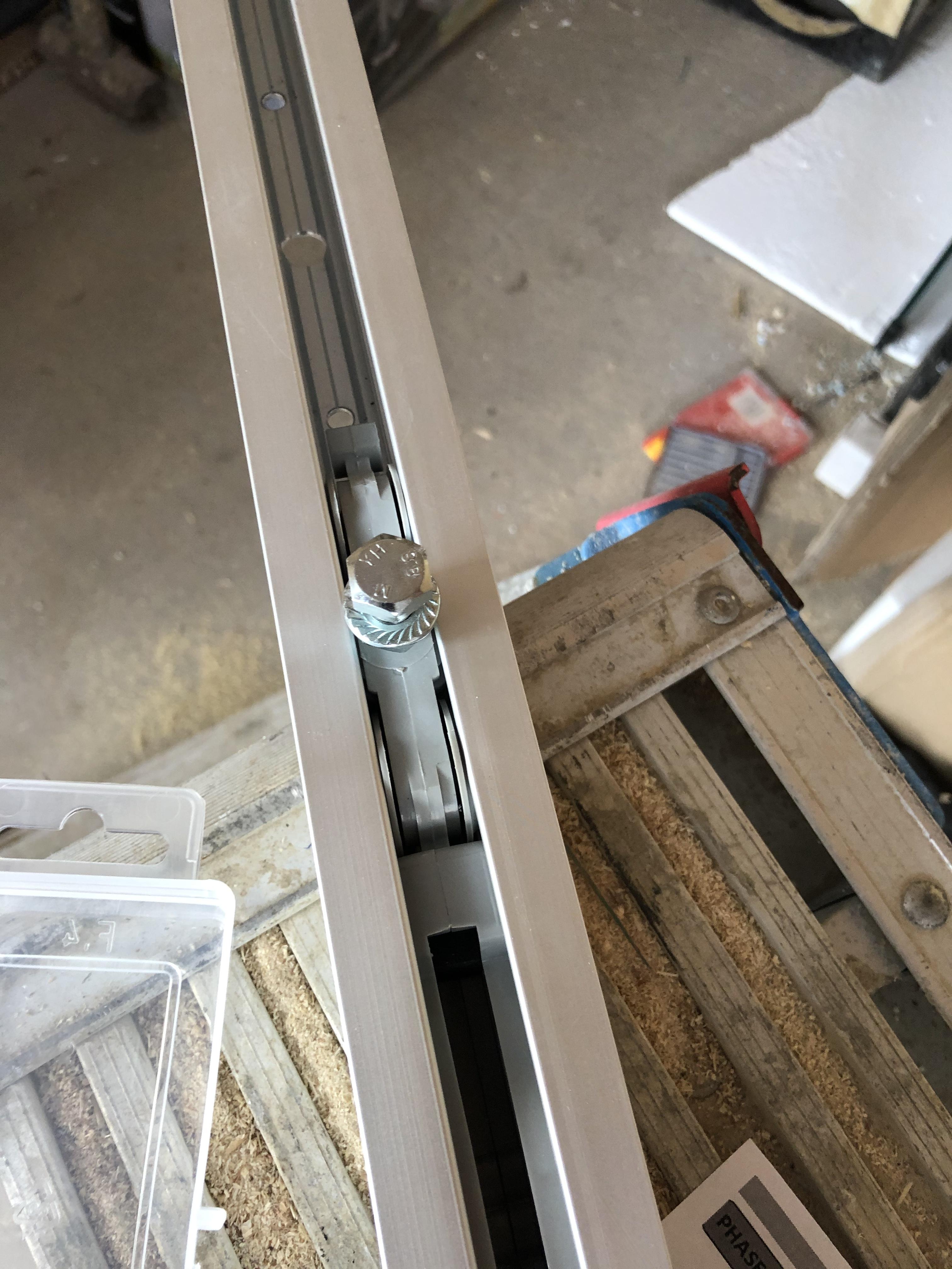

Posted
There !
Took slidy rail out ( on the left ) this was in the rail on the right so naturally assumed that was correct ; as it was supplied like that . But as I have seen Eclisse send more stuff and variations of instructions because they presumably don’t know what you need . I actually was sent 3 anti slam kits ( 2 of the ‘doubles ‘ ) . Countless frame instructions synthesis line ,vitro ,bias .
Dead helpful !

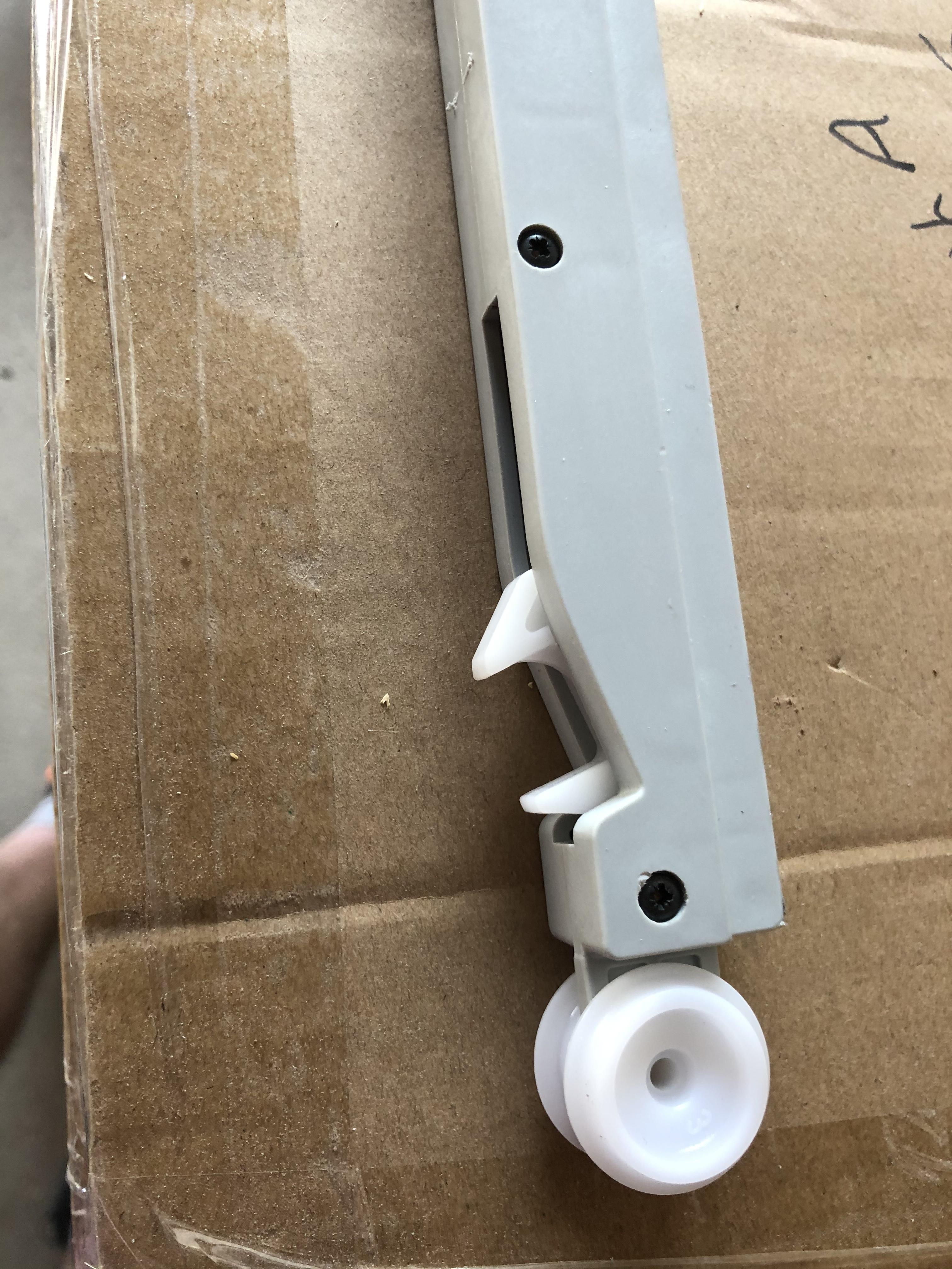

Posted
I just don’t get how the anti slam works . I don’t see how the plastic white clip part ‘catches’ anything to cause it to work .

Posted (edited)
I found these instructions which appear similar but only have one white "catch" rather than two.
https://www.eclisse.co.uk/content/installation-accessories/603024103%20Scheda%20Rallenty%20BIAS.pdf
I think it might catch on the shaped end of "Item C".
Does your kit have the same or similar part?
