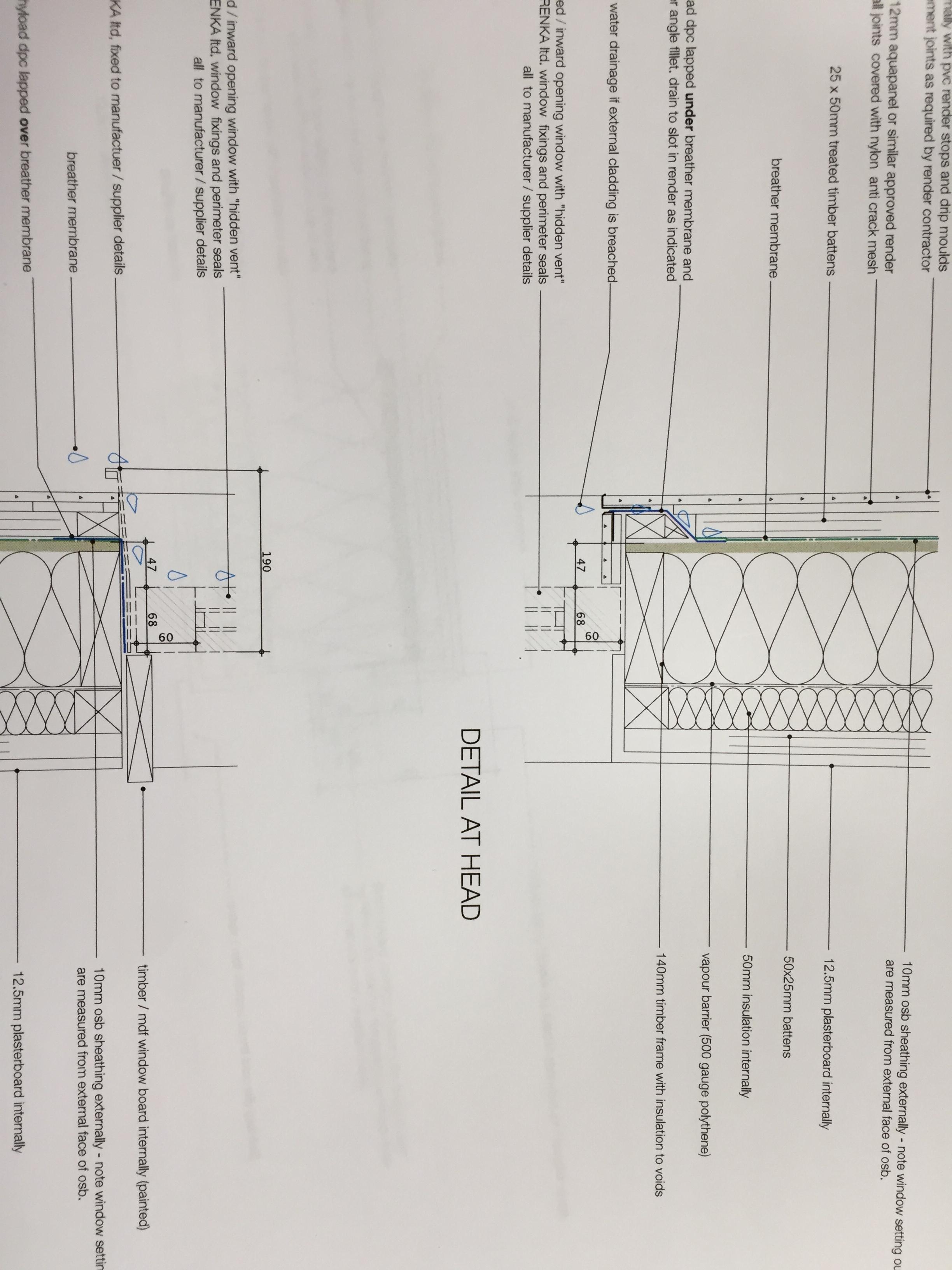

Trw144 Posted November 7, 2016 Share Posted November 7, 2016 Can anyone tell me what render detail they have done regarding dpc/drip routes for rendering around windows. Renderer says he never does this, architect has drawn it. I m not sure if it's the renderer being lazy or architect overkill?? No urgency but I need to know for the morning! Link to comment Share on other sites More sharing options...
tonyshouse Posted November 7, 2016 Share Posted November 7, 2016 I always like to see a Belfast drip bead at the head that hangs down BELOW the level of the head or soffit. I do do not like the render stop or the detail at the head, looks like water will track into the reveal. I would not allow the plasterer or remderer to decide you need to tell him what you want. Link to comment Share on other sites More sharing options...
bassanclan Posted November 7, 2016 Share Posted November 7, 2016 What render are you using? If you look at the technical info from the render manufacturer it will show very similar detail which will back up your argument with the renderer. I have attached a Sto example Heritage R1_MNP_FULL.pdf Link to comment Share on other sites More sharing options...
Trw144 Posted November 7, 2016 Author Share Posted November 7, 2016 The K rend thin coat (timber frame house). From what your both suggesting you suggest not having that drainage channel and instead just ensure a suitable plastic head to ensure it drops off? Link to comment Share on other sites More sharing options...
nod Posted November 7, 2016 Share Posted November 7, 2016 14 hours ago, Trw144 said: Can anyone tell me what render detail they have done regarding dpc/drip routes for rendering around windows. Renderer says he never does this, architect has drawn it. I m not sure if it's the renderer being lazy or architect overkill?? No urgency but I need to know for the morning! It's really not a difficult detail to follow. Tell your renderer it is what it is, he'll understand where you are coming from. Link to comment Share on other sites More sharing options...
PeterW Posted November 7, 2016 Share Posted November 7, 2016 6 hours ago, Trw144 said: Can anyone tell me what render detail they have done regarding dpc/drip routes for rendering around windows. Renderer says he never does this, architect has drawn it. I m not sure if it's the renderer being lazy or architect overkill?? No urgency but I need to know for the morning! Just as an aside there is a pretty big cold bridge in that around the opening as you have battens shown in line with the frame above and below the window. Can they not be vertical inside..? No service void ..? Link to comment Share on other sites More sharing options...
