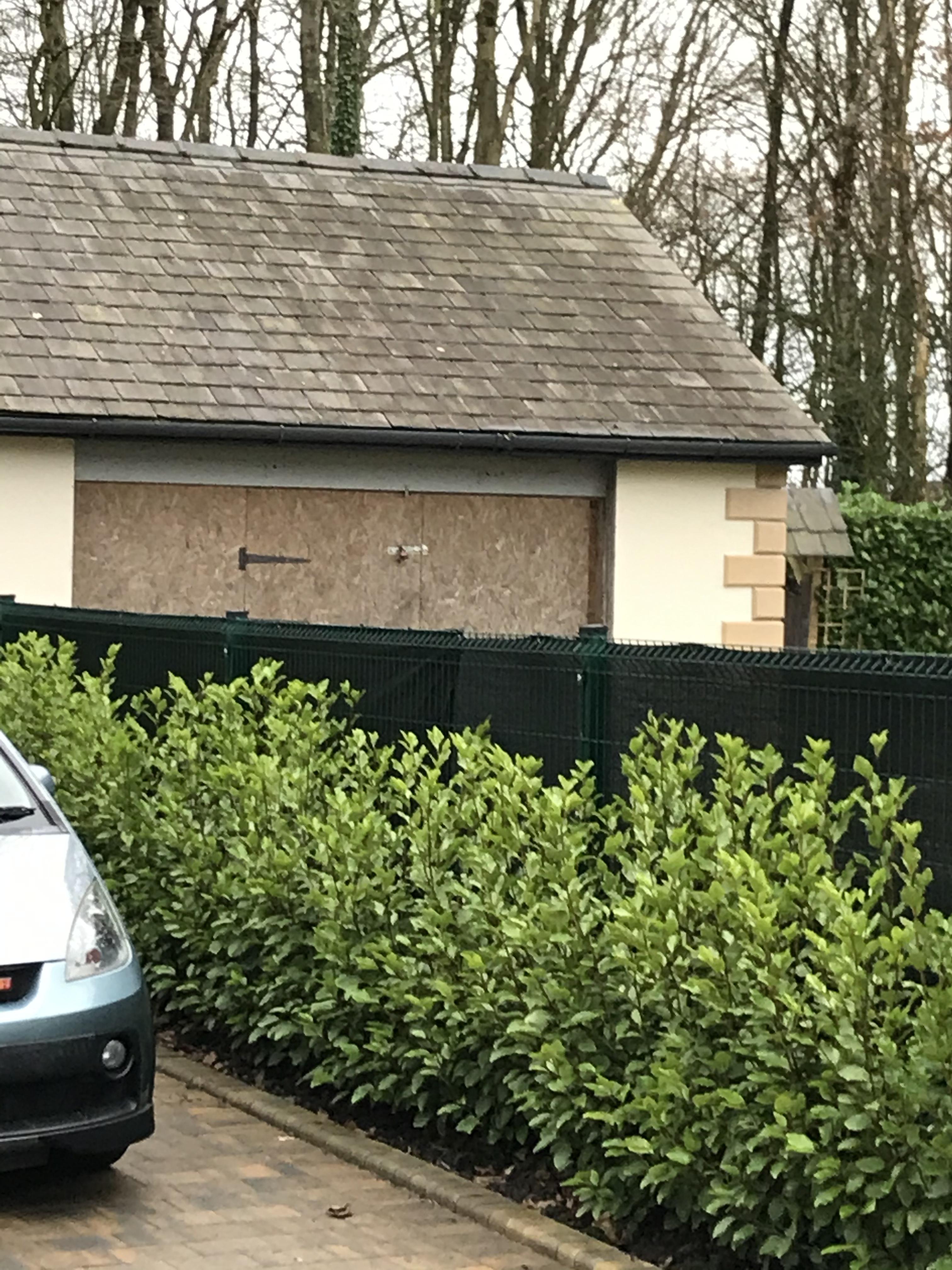

nod Posted January 11, 2020 Posted January 11, 2020 Our neighbour who sold us the land hounded us to u red gently get his garage built before we started the build 3 years on he still hasn’t removed the temporary osb door I reckon it will still be in use in another three years 1
ToughButterCup Posted January 11, 2020 Posted January 11, 2020 Hmmm, Gary, the door's a mil or two out of line. ....... can see it from here.
