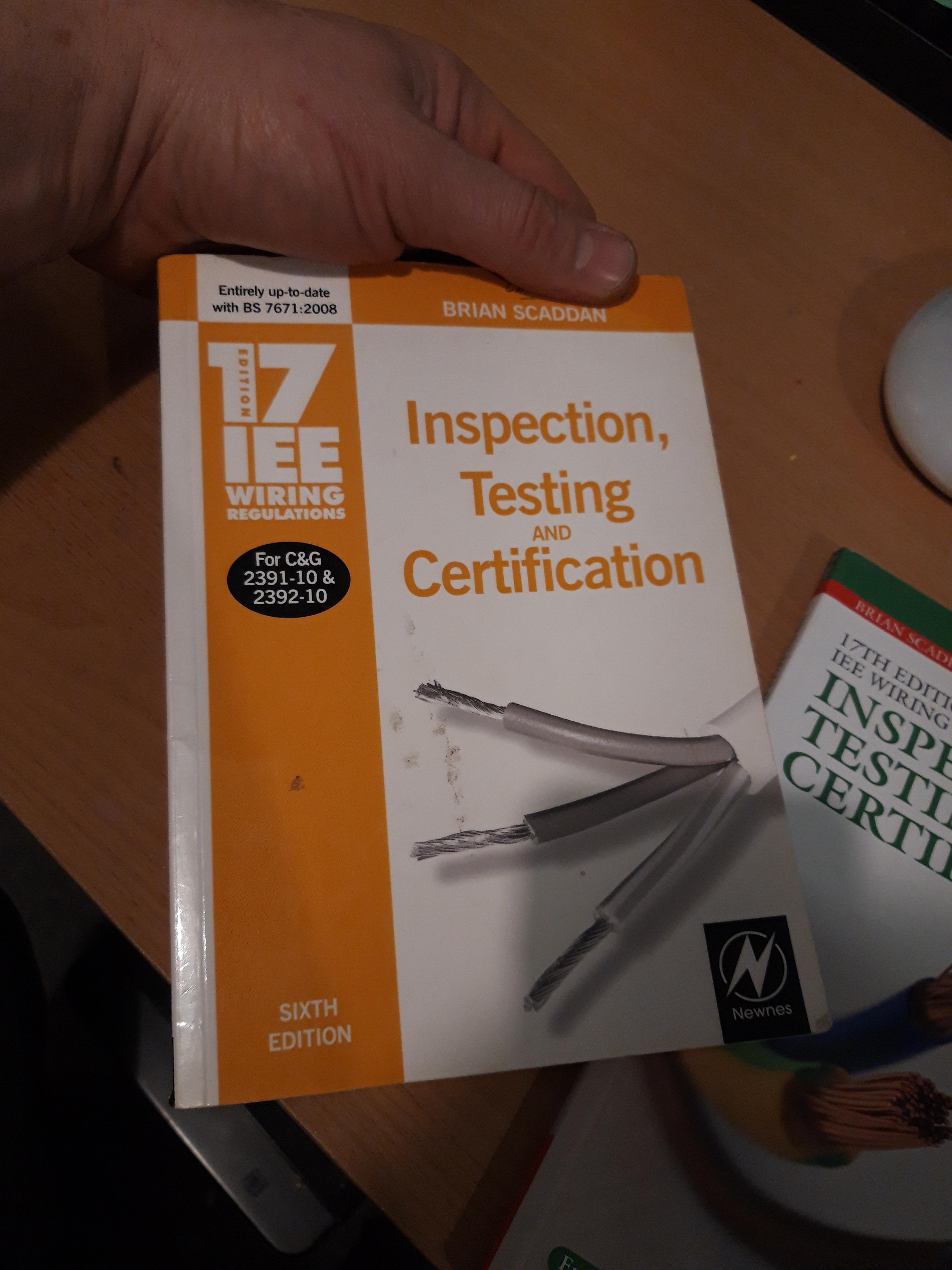

Onoff Posted January 10, 2020 Posted January 10, 2020 I've a slightly out of date test and inspection guide here you're welcome too. Fundamental testing remains the same tbh. The Scadden books are pretty good imo but for belt and braces the latest Guidance Note 3 is probably the best bet (about £27). Lots of clear, pretty pictures. I know I'm rarely serious but dead testing prior to energizing a circuit is a must. Saved the day for me on many an occasion. Done properly it'll flag up your and other's mistakes and tbh isn't that hard to do. An all singing all dancing Megger multi function tester is around the £800 mark now. Of course you have to know how to use it. 2

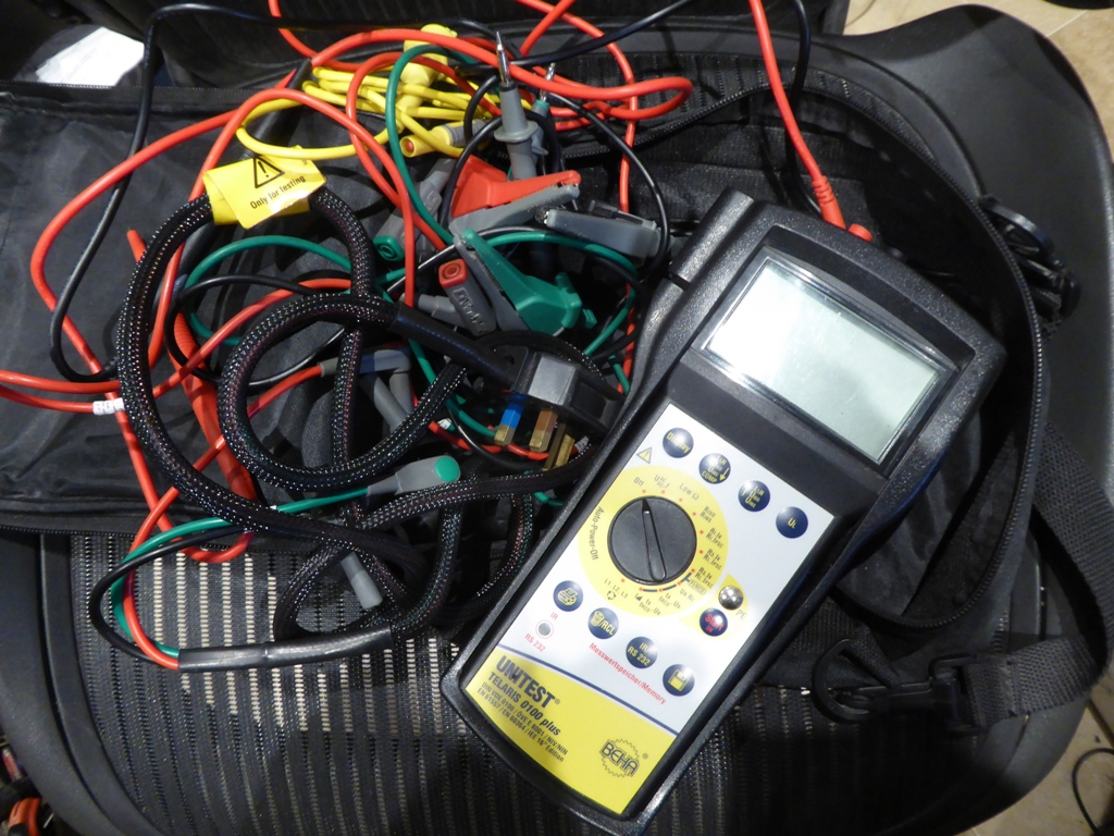

Jeremy Harris Posted January 10, 2020 Posted January 10, 2020 On the subject of MFTs, you can often pick up a second hand one for a couple of hundred pounds or less. Mine's pretty old now, but IIRC it cost me about £150. It's a PITA to use, as the test button is on the right (must have been designed by a left handed person), but it stays in cal and I knocked up a proving unit to check it before I use it, just to be reasonably sure it's still in spec (no point paying for a proper calibration for my use, anyway). It seems that some electricians MUST have the latest MFT, so often seem to sell off perfectly good units on eBay, Gumtree etc. I bought mine via a friend of a friend years ago, who bought it back when part P first came out, then started working for one of the big contractors locally and got issued with a much nicer machine.

Onoff Posted January 11, 2020 Posted January 11, 2020 6 hours ago, Jeremy Harris said: Mine's pretty old now, but IIRC it cost me about £150 My best Megger meter was £800 at the time. I bought it unused off a mate where his firm folded with the governors disappearing into the night and he was left with all his supplied tools. He walked straight into another job so sold the tools on. The mad thing is he has pretty much zero electrical knowledge and was employed as a general maintenance man with a van and the meter was still boxed up. I gave him £130 from memory. It only does RCDs and earth loop impedance though. My insulation tester, again Megger is stand alone.
