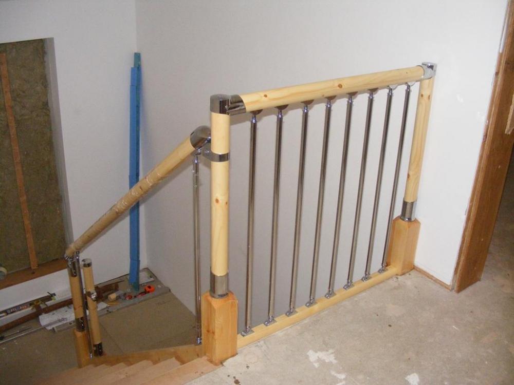

Well I went ahead and did it. :ph34r:
The threaded rod was M12 and I had an M12 tap so I drilled a 10mm hole and tapped an M12 hole down into the newel post, screwed the threaded rod in with plenty of epoxy, gave it time to set before setting the post bracket on and tightening it down.
It all seems solid and I think looks better for not having holes in the side of the newel posts.

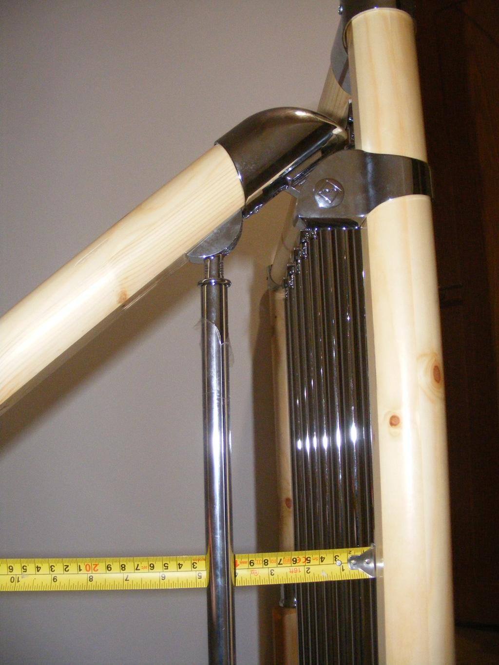

But I have encountered a problem.
At the top of the flight, the top spindle is fitted as far up the stairs as it possibly can go.  The spindle bracket is touching the top handrail bracket.
I am measuring the gap as exactly 100mm if not 101.  That will fail the "a 100mm sphere will not pass through"
I will see if I can find a contact to pose this issue to Richard Burbidge and see what they say.
I suspect the problem is my stairs are too shallow.  I had a bit of extra space so chose to make the going of each stair a little greater, all within building regs limits, to make the stairs a bit less steep.  I have just looked it up and it's 40.21 degrees.  What's the betting Burbidge tell me my stairs are too shallow? That should not be the case as they say suitable for a pitch between 38 and 45 degrees.
The only solution I can see is cut a bit off that top spindle bracket, which is chrome plated plastic.

Three points really.  Why is such a well known manufacturer as Burbidge selling a product that as far as I can tell in anything less than the standard 42 degree staircase, cannot meet building regs?
I think we will end up with 95mm gap throughout.  My OCD will notice the odd 100mm gap every time we climb the stairs, and so might the building inspector.
We have a split flight with a half landing, so the spindles for each flight will overlap.  So you try and make the spindles on each flight line up.  Because you can't get less than a 100mm gap at the top, that also applies to the top of the lower flight.  So to make the first spindles in either direction from the half landing line up, that means using a 100mm gap at the bottom of the flights as well.  Double OCD.
I have sent an email and my picture with the tape measure to Burbidge. I will let you know their response.

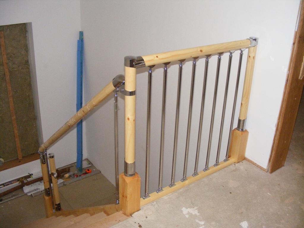

All completed.
I filed a bit off the top spindle bracket and got the top gap to 97mm.  The rest of the top run is 90mm and the bottom run 95mm.
