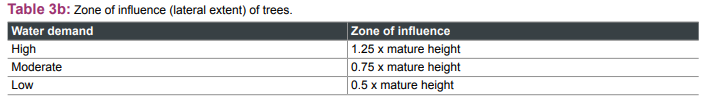

MortarThePoint Posted January 5, 2020 Share Posted January 5, 2020 (edited) You have a double whammy as the geology is likely high volume change potential (VCP) and the trees removed are high water demand so that will maximise any resulting heave. How high were the Leylandi? If over 9m or 10m (I think) then they would be classed as mature and their full height (>=18m) would be used for any foundation calculations. What are the different strata? Don't forget to consider other nearby trees. NHBC have a foundations mobile app but I don't know if it covers raft. Chapter 4.2 of their guidelines has useful information (NHBC 2020 Chapter 4.2). I have some experience in this area as we are to build a large(ish) garage with high VCP geology (alluvium over gault clay). We can't bear on the alluvium so need to do bulk soil replacement down to 1.25m with MOT Type 1. Thankfully we should be yielding some concrete from demolition. There are some sizable trees and ex-trees near by so a raft was the best bet. Thankfully this isn't the case for the house, but the trench foundations need to be pretty deep there. I'd expect the dimensions of your workshop are consistent with a less fussy approach, but you will certainly need reinforcement and +1 for the thickening round the edges. You could (some might say should) spend a lot on geotec and structural engineering, but that's your call and I don't think I would for the likely cost of what you are proposing. Be careful of building regulations (Outbuildings vs Building Regs) but the size you are proposing (26m2) will be OK if you are >1m from the boundary or substantially non-combustible (i.e. no timber cladding). I'm no expert on any of these areas so don't take the above as gospel. Edited January 5, 2020 by MortarThePoint links Link to comment Share on other sites More sharing options...

texutree Posted January 5, 2020 Author Share Posted January 5, 2020 Many thanks all. The trees are approx. 3.5m tall and I am unsure as to the different strata underlying the clay. As it is just an outbuilding, I don't think I will go down the route of paying lots for geotech - in terms of building regs, it is closer than 1m to boundary but I will ensure it is built from substantially non-combustible materials. Link to comment Share on other sites More sharing options...
MortarThePoint Posted January 5, 2020 Share Posted January 5, 2020 2 hours ago, texutree said: The trees are approx. 3.5m tall and I am unsure as to the different strata underlying the clay. Pretty small trees. NHBC considers the zone of influence for high water demand trees to be 1.25 times mature height so you can be surprised how far away tress can have an affect. Quote I don't think I will go down the route of paying lots for geotech Makes sense, I wouldn't either. The NHBC guidelines will be cautious and you're not building multiple storey habitable space. Link to comment Share on other sites More sharing options...
