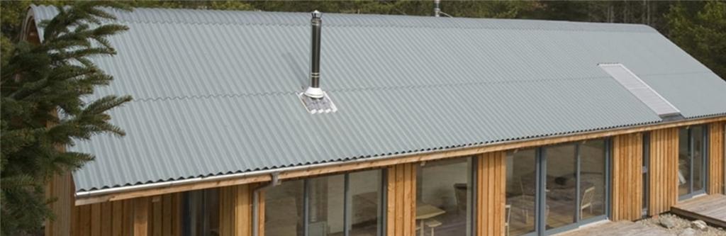

Simplysimon Posted January 7, 2020 Posted January 7, 2020 alternative would be to use corrugated cement fibre roof, no drips and quieter when it rains
Cpd Posted January 7, 2020 Posted January 7, 2020 1 hour ago, Simplysimon said: alternative would be to use corrugated cement fibre roof, no drips and quieter when it rains Do they do it with a curve ?
