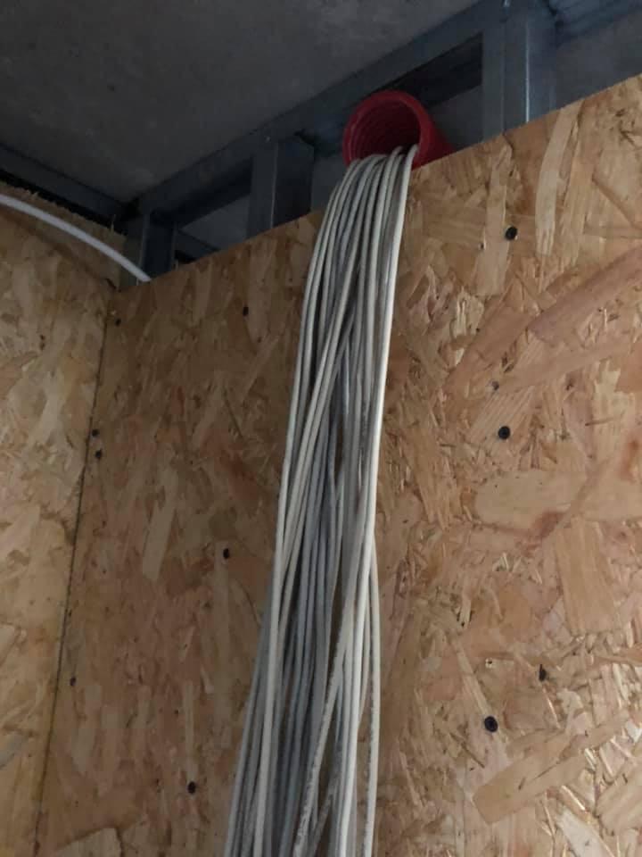

jack Posted December 31, 2019 Share Posted December 31, 2019 The cable category question isn't just a matter of cable cost. The higher spec cables are thicker, stiffer (in some cases, a lot stiffer) and harder to work with. The necessary terminations are more expensive (again, possibly a lot more so). Also, the higher data rates are only reliably achievable if some pretty stringent installation standards are met - everything from termination type and quality through to max bend radii. If all that will ever happen over a link is switching and maybe KNX-type data, basic Cat5 or 5a is more than sufficient. Either way, consider getting LSZH (less fumes in a fire) and definitely make sure the wire is solid copper rather than CCA (copper clad aluminium). I think I got a good deal on Cat6 when I was buying, but for 90% of my wiring that was complete overkill. Link to comment Share on other sites More sharing options...
puntloos Posted December 31, 2019 Author Share Posted December 31, 2019 Trawling the dankweb I did find this: Temp, Motion, Light, Humidity But it only works with Apple Homekit. I wonder if there are any good bridges for Homekit to Smartthings or somesuch. @joth you know if suchlike exists? 3 minutes ago, jack said: The cable category question isn't just a matter of cable cost. The higher spec cables are thicker, stiffer (in some cases, a lot stiffer) and harder to work with. The necessary terminations are more expensive (again, possibly a lot more so). Also, the higher data rates are only reliably achievable if some pretty stringent installation standards are met - everything from termination type and quality through to max bend radii. If all that will ever happen over a link is switching and maybe KNX-type data, basic Cat5 or 5a is more than sufficient. Tend to agree, today it's definitely true. But what about the future.. 3 minutes ago, jack said: Either way, consider getting LSZH (less fumes in a fire) and definitely make sure the wire is solid copper rather than CCA (copper clad aluminium). Good call, will make a note. 3 minutes ago, jack said: I think I got a good deal on Cat6 when I was buying, but for 90% of my wiring that was complete overkill. Link to comment Share on other sites More sharing options...
