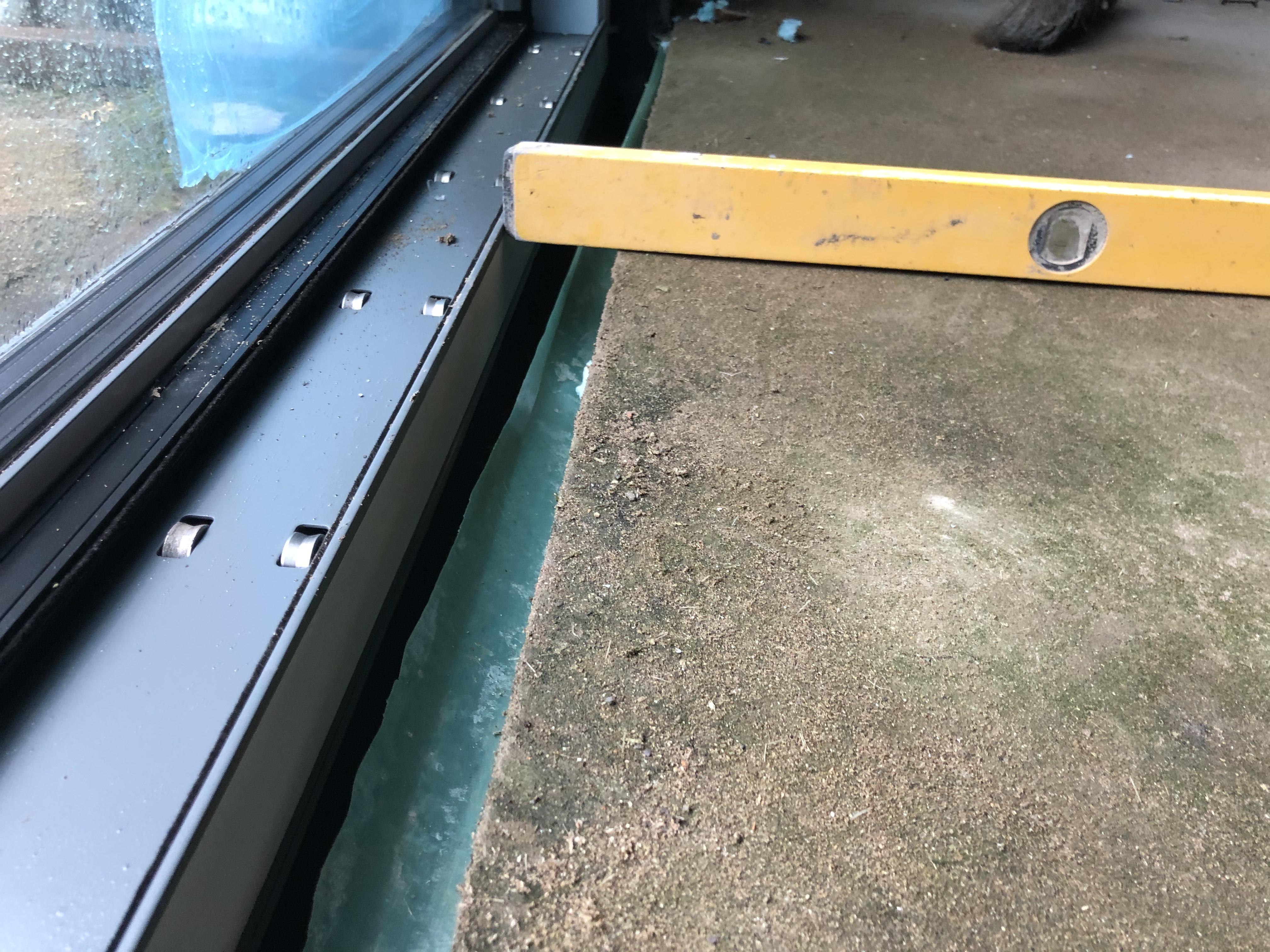

Pocster Posted November 26, 2019 Posted November 26, 2019 So , the glazing fitters have been as expected job only half done some “glazing to follow” Anyway , plan was to have internal and external tiles level with large slliders . We discussed and around 18mm would be free . Stuck the spirit level on and as it meets the door I’ve got maybe 8mm . Tile 10mm , adhesive 5mm , de coupling Mat etc. Making around 18 . Erm - what do I do here ? . I assume the tiles are meant to be flush with the track ? .
Mr Punter Posted November 26, 2019 Posted November 26, 2019 Looking at you spirit level, does the screed ramp up toward the threshold? If it does maybe you could grind it down or reduce the adhesive for the lat 100mm. What goes in the gap? 1
Pocster Posted November 26, 2019 Author Posted November 26, 2019 10 minutes ago, Mr Punter said: Looking at you spirit level, does the screed ramp up toward the threshold? If it does maybe you could grind it down or reduce the adhesive for the lat 100mm. What goes in the gap? The gap they left me . Was just going to fill with a screed mix myself . I double checked and at the opening door end there probably is 18mm . So assume the screed is maybe 10mm our across the span of around 7 meters . Did think a concrete grinder might be the solution .
Big Jimbo Posted November 26, 2019 Posted November 26, 2019 i always go to great pains to try and get my door thresholds standing up about 25mm or so. it wont give me level, but i can live with the 8mm or so, (better than the 4 0r 5 inches you can end up with) I would run the tiles level, and finish the edge with a nice stainless tile trim if my doors have been set low. Just take care to ensure that the opening door does not foul the tiles.
Pocster Posted November 26, 2019 Author Posted November 26, 2019 1 hour ago, Big Jimbo said: i always go to great pains to try and get my door thresholds standing up about 25mm or so. it wont give me level, but i can live with the 8mm or so, (better than the 4 0r 5 inches you can end up with) I would run the tiles level, and finish the edge with a nice stainless tile trim if my doors have been set low. Just take care to ensure that the opening door does not foul the tiles. Yeah I think the issue is if I ran the tile level they would be above the threshold . I’ll grind the screed one day ........ ?
Big Jimbo Posted November 26, 2019 Posted November 26, 2019 Just now, pocster said: Yeah I think the issue is if I ran the tile level they would be above the threshold . I’ll grind the screed one day ........ ? No i get that. So when your doors are open, and you are outside looking in, all you can see is a little stainless upstand rather that the cut edges of tiles. 1
Pocster Posted November 26, 2019 Author Posted November 26, 2019 Just now, Big Jimbo said: No i get that. So when your doors are open, and you are outside looking in, all you can see is a little stainless upstand rather that the cut edges of tiles. Oh I see - sorry ; yes I could do that 1
Big Jimbo Posted November 26, 2019 Posted November 26, 2019 1 minute ago, pocster said: Oh I see - sorry ; yes I could do that Believe me, nobody will even notice. You can grind your screed, but £10 it still wont allow you tiles to be set level. Nothing worse than seeing tiles that sombody has obviously tried to ramp down to a door. It looks sh17e, especially if they distort a reflection. 1
joe90 Posted November 26, 2019 Posted November 26, 2019 8 minutes ago, Big Jimbo said: Believe me, nobody will even notice. You can grind your screed, but £10 it still wont allow you tiles to be set level. Nothing worse than seeing tiles that sombody has obviously tried to ramp down to a door. It looks sh17e, especially if they distort a reflection. I think what @Mr Punter is saying is that it looks like the screed rises towards the edge (it certainly looks like that) and suggests grinding it down to be flat with the rest of the floor!
Pocster Posted November 26, 2019 Author Posted November 26, 2019 25 minutes ago, joe90 said: I think what @Mr Punter is saying is that it looks like the screed rises towards the edge (it certainly looks like that) and suggests grinding it down to be flat with the rest of the floor! It does but maybe only by 2mm ... 1

Pocster Posted November 26, 2019 Author Posted November 26, 2019 I’ll stick a laser in the centre of the floor and see how the horizontal beam lies on the door frame . Probably a more accurate way to see how far out the floor is .
Pocster Posted November 26, 2019 Author Posted November 26, 2019 Out of interest how ‘fast’ does a concrete grinder grind ? ? . If you go over an area does it take a fraction of a millimetre off ???

Onoff Posted November 26, 2019 Posted November 26, 2019 Could you use say a wall chaser to cut some parallel slots in the screed at the edge then break the "fingers" out?
