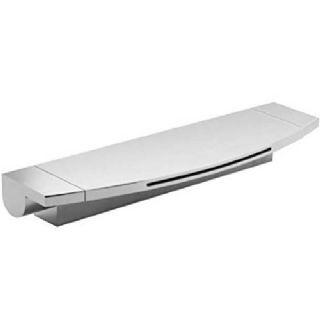

Onoff Posted November 21, 2019 Posted November 21, 2019 I was banned from getting this Vado Summit bath filler ?
ProDave Posted November 21, 2019 Posted November 21, 2019 24 minutes ago, Onoff said: I was banned from getting this Vado Summit bath filler ? Reason?
Onoff Posted November 21, 2019 Posted November 21, 2019 Just now, ProDave said: Reason? She didn't like it so we compromised and got what she wanted. 1
