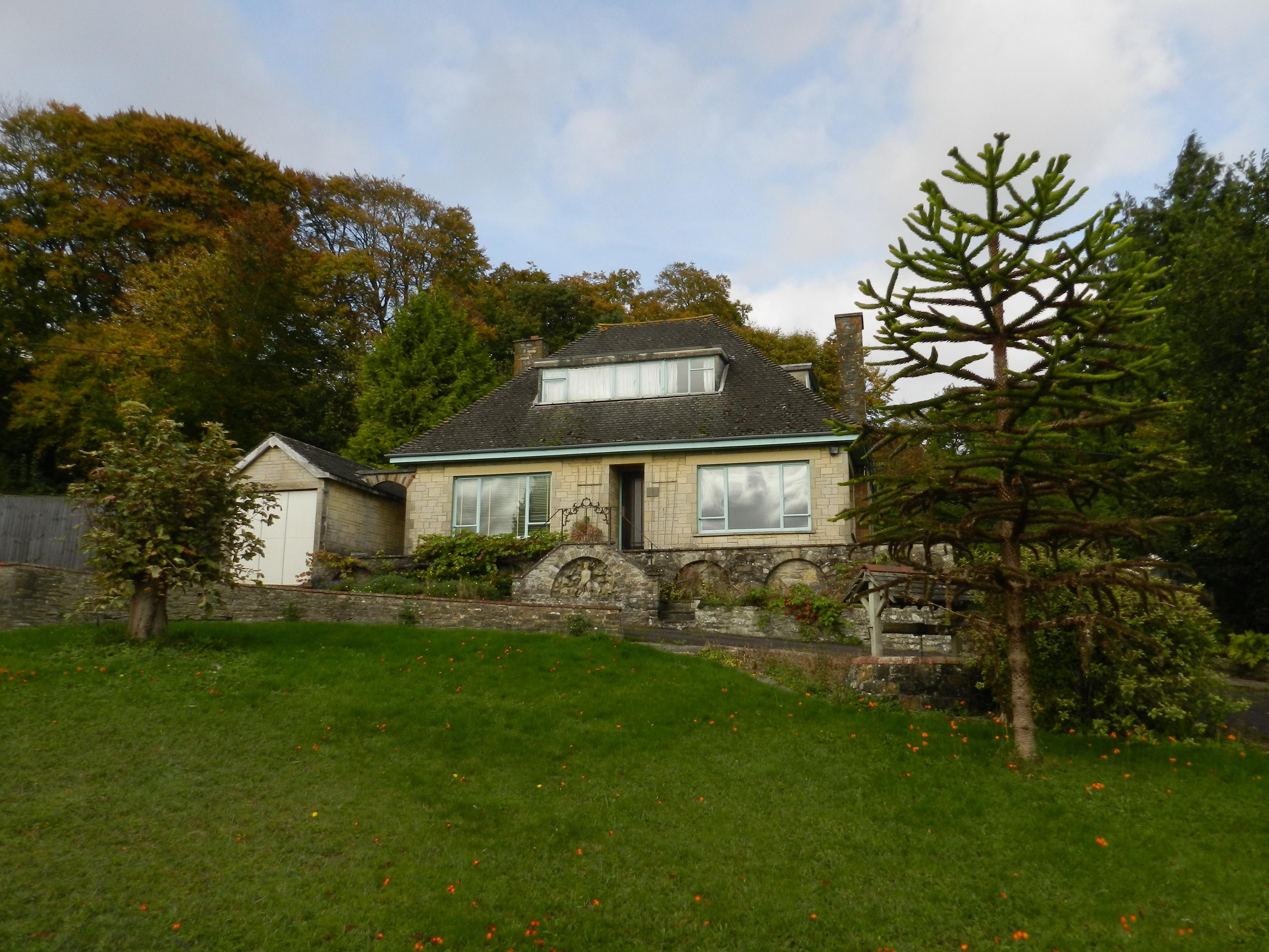

Angel Posted November 21, 2019 Share Posted November 21, 2019 We are planning to renovate our 1960s chalet bungalow (cavity walls, reconstituted stone). Photo attached. Footprint is 11m x 7m; ridge is 3m long. Building is structurally sound and existing foundations are good enough to build a new two storey, timber-framed house on them. Before we get carried away with ideas, we would like an indication of the relative costs of three options: (i) Re-roof and re-do the existing dormers and probably remove both chimneys (this is base level option); (ii) Remove chimneys, convert hips to gable ends (with hipped or gabled dormers for better kerb appeal) to provide a bit more interior space; (iii) remove roof and chimneys, replace with timber-framed, flat-roofed timber-clad, first floor extension giving a lot more upstairs space (+ cosmetic alterations to give a contemporary look). I can work out demolition, flooring, walls, bathrooms, electrics and so on but have no idea about the roof and exterior wall elements. Just wondered if there was anyone on the forum who could give ball park range of figures for each option as a starting point for us? Link to comment Share on other sites More sharing options...

Ferdinand Posted November 22, 2019 Share Posted November 22, 2019 (edited) 19 hours ago, Angel said: We are planning to renovate our 1960s chalet bungalow (cavity walls, reconstituted stone). Photo attached. Footprint is 11m x 7m; ridge is 3m long. Building is structurally sound and existing foundations are good enough to build a new two storey, timber-framed house on them. Before we get carried away with ideas, we would like an indication of the relative costs of three options: (i) Re-roof and re-do the existing dormers and probably remove both chimneys (this is base level option); (ii) Remove chimneys, convert hips to gable ends (with hipped or gabled dormers for better kerb appeal) to provide a bit more interior space; (iii) remove roof and chimneys, replace with timber-framed, flat-roofed timber-clad, first floor extension giving a lot more upstairs space (+ cosmetic alterations to give a contemporary look). Don't forget to focus on risk and time as well as money. I cam commenting from a Midlands perspective, but with family in Surrey and I live in a bungalow +1 storey, which was reduced to a hole in the ground and 3 walls then rebuilt. I am not absolutely clear about whether you are happy project managing at a level of Administrating it, or the more demanding feel willing to instruct your trades / subbies on some things. iii) I think that to get an "extra storey on your roof" company to do that could easily cost nearly your entire budget for a nice new storey and a staircase. It may not, but it could. That could put you in the "all the money on 2/3 of the project - bugger what do we do now?" category. It happens. That is a risk you need to manage. ii) I can't really comment on - turns heavily on the local market and what prices you are given. i) I would suggest this one, unless you have clear ways to manage the risks you identify on the others. I would then suggest identifying a possible "Phase 2", which would be a ground floor extension in the future if you feel you need it. That could also be doable under Permitted Development. I would also say: 1 - Given the roof complexity, buy your own scaffolding. 2 - There are certain elements not in your list of costs, as you know. A full list (incl. for example fabric improvement) would be a good next step. 3 - Explore options such as reduced rate VAT as it has been empty. 4 - Do not forget the Council Tax you save by getting in early. 5 - Is there a risk of losing your 3% Stamp Duty if you take time selling the other one off? 6 - Serious consider whether you need a PM or Advisor to help you manage the technical side. Ferdinand Edited November 22, 2019 by Ferdinand Link to comment Share on other sites More sharing options...
Angel Posted November 22, 2019 Author Share Posted November 22, 2019 (edited) Thanks Ferdinand that's useful. @ Big Jimbo and Redoctober: The bungalow is in Wiltshire not Surrey and we weren't looking for high end finish for kitchen and bathroom, it just wouldn't make economic sense. The figures were based on quotes received for those aspects in the larger new build. We plan to use an architect and main (local) contractor rather than subbies, because we're not close enough to manage the work on a day to day basis. Access is steep, limited to 7.5t lorries only and drive 60m long so probably need to keep materials to be brought on site including concrete for foundations to a minimum. Sounds like we may just need to get the options worked up and costed up properly to decide but this comes with more time delays and sunk costs. However, if anyone has any idea how much in broad terms any of the following may cost: a new roof (re-using existing tiles), converting 2 hips to gables or a new flat-roofed first floor it would be really helpful. 1088_A01_010_Existing Plans Measured Orme.pdf 1088_A01_020_Existing Elevations Orme survey.pdf Edited November 22, 2019 by Angel clarifying Link to comment Share on other sites More sharing options...
