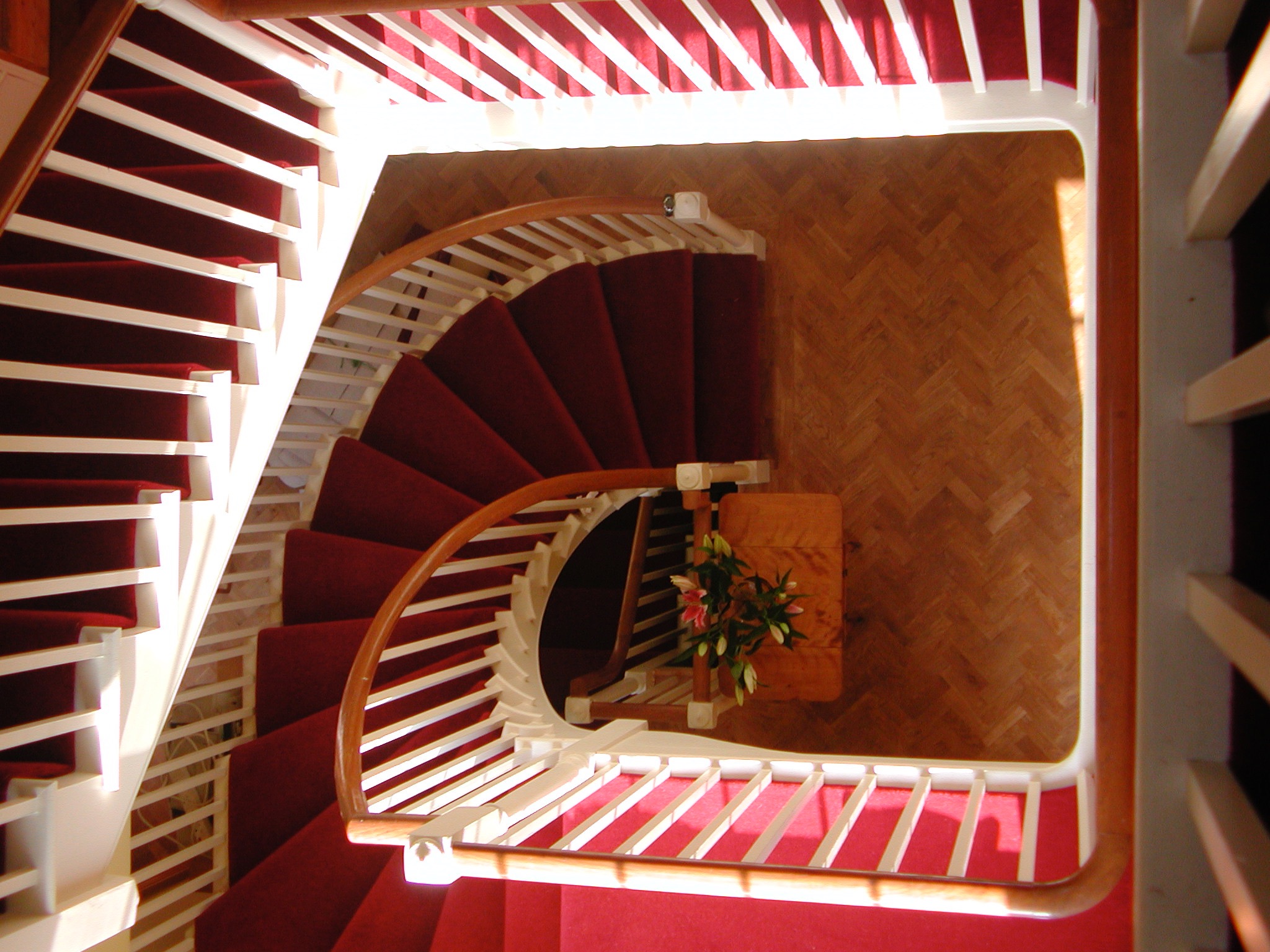

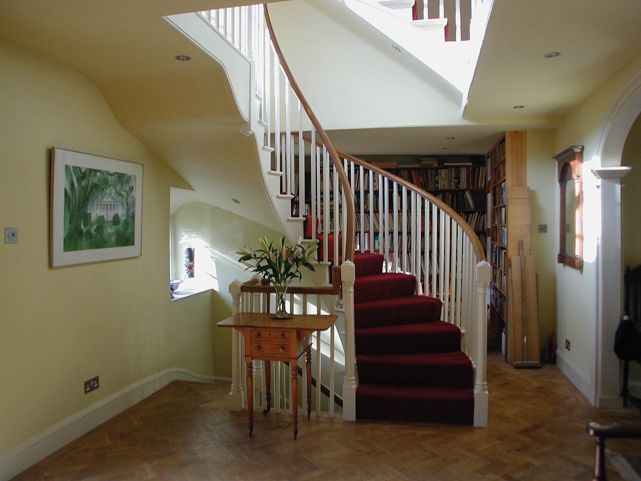

That's not entirely true I'm afraid. It is true vis à vis the normal planners but not Listed Building officers. If a building is grade 2 (any grade really) listed it includes all elements, internal or external, even down to door handles/light switches/wall coverings/lighting etc., if you are unlucky. If it is not listed but in a conservation area then it is, usually, just the exterior (often only the facade) that they are concerned about.
The best is to set up a meeting with your BCO and Conservation officer and negotiate. You can work this both ways. Either to dispense with some elements of BC – I managed to get an open 4 storey staircase (without sprinklers or fire protection) through by using Listed Building against BCO (see photos), you can work it the other way too as I did with the glass doors.
