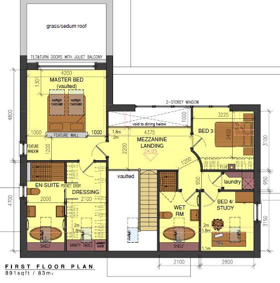

Conor Posted October 30, 2019 Share Posted October 30, 2019 In a bit of a rub with my architect. We have a 5m wide opening that has 5 panel bi-folds on the ground floor (2700mm) and five fixed panes directly above on the first floor (2200mm). At first floor level there's an open mezz, then a bedroom. I had always assumed there would be a 300mm deep RSJ spanning across and giving somewhere for the bi-folds to hang from, and above fixed panes to sit on. My architect is against this as it would be thicker than the glazing systems and difficult to insulate and therefore a really bad cold bridge. Instead, he's suggesting that the glazing is treated as a single element and designed accordingly by the glazing supplier. And the internal floor slab would be on a seperate, internal beam system behind the mezzanine. Issue is, both bifold door options I'm looking at are top hung and require something solid to bolt in to... So a commercial style glass curtain isn't an option. I'd have to change door systems... I was thinking a price of 300mm X 100mm steel channel. This would allow the bedroom floor slab to be supported as well as the glazing. Just not sure how it would be sufficiently insulated? Anybody have a similar detail? (Please note the 6th panel on LHS on ground floor is gone, total span is 5m on both floors) Link to comment Share on other sites More sharing options...

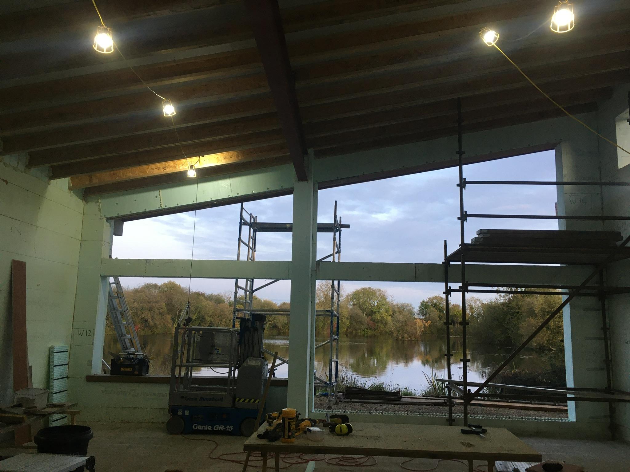

Russell griffiths Posted October 30, 2019 Share Posted October 30, 2019 Have you had a structural engineer look at this i would be surprised if a 300x100 Chanel will span 5m and support all that glass and a door and a floor not the look your after, but this is what we are doing to hide the 300mm deep concrete beam above our doors. Link to comment Share on other sites More sharing options...

Russell griffiths Posted October 30, 2019 Share Posted October 30, 2019 again not really what your doing but this is a 250x150 icf beam across the top of our doors. Like in my previous picture we are having an aluminium flashing to cover this on the outside 4 Link to comment Share on other sites More sharing options...

Russell griffiths Posted October 30, 2019 Share Posted October 30, 2019 We are only just discussing door location with the window co now, I believe because of the width of the frames they will sit towards the front edge of the wall, still needs clarification. As to waterproofing im afraid I won’t be doing anything unusual as I have an 1800mm roof overhang 45degree rain hardly gets near the front of the building Link to comment Share on other sites More sharing options...

Conor Posted October 31, 2019 Author Share Posted October 31, 2019 Update. Spoke to architect. We're now proposing to run a steel beam just inside the curtain wall, with the base flange extended out 65mm so windows can sit on/under. Will minimise cold bridging as will just need a wrapping of aerogel on the beam flange. Now off to the SE for her thoughts. Link to comment Share on other sites More sharing options...
