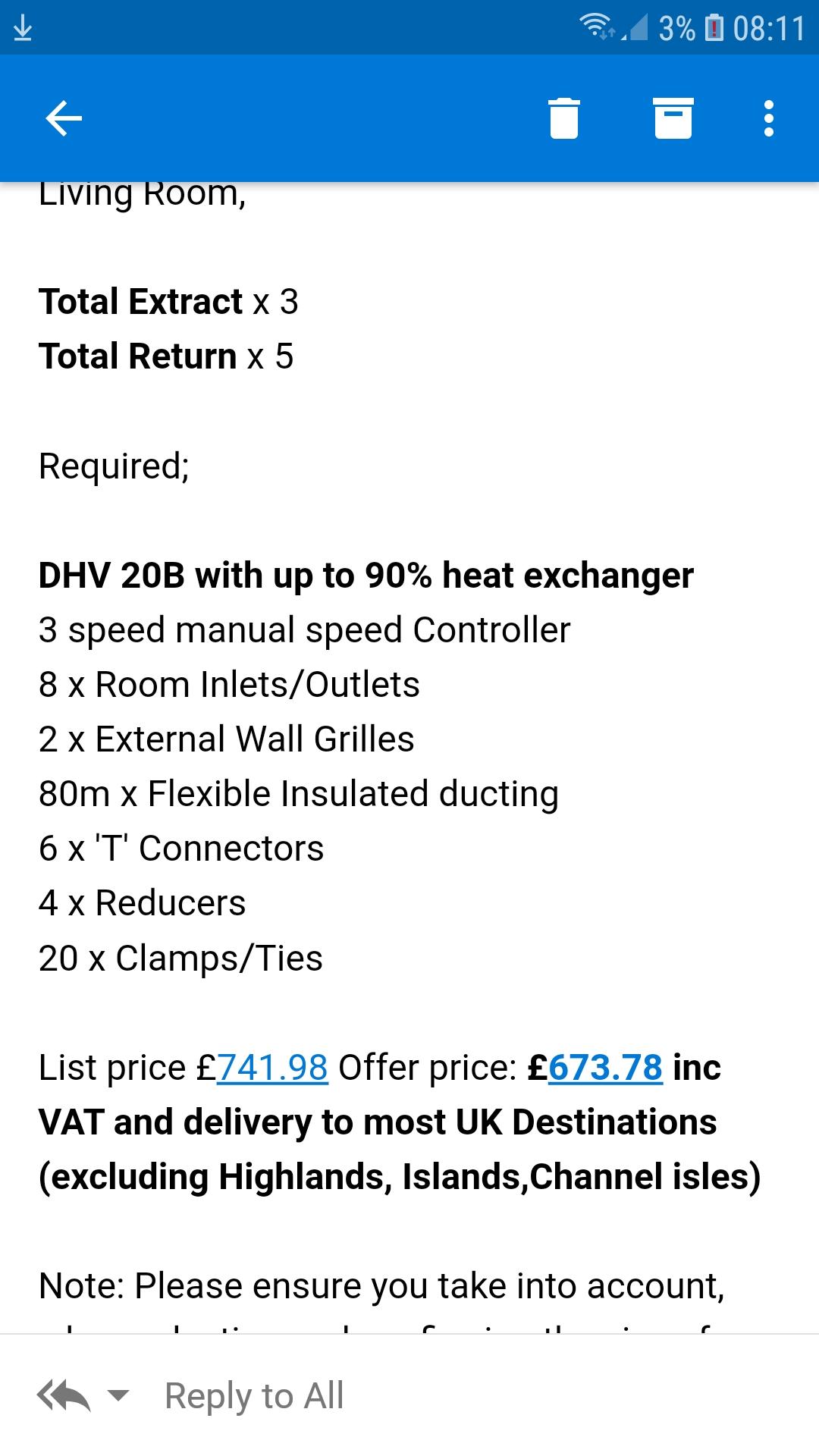

Oz07 Posted November 3, 2019 Share Posted November 3, 2019 I had a bpc price but then had this one recently much cheaper. Is it too good to be true? Yes I like to live dangerously with low battery Link to comment Share on other sites More sharing options...
joth Posted November 3, 2019 Share Posted November 3, 2019 (edited) @Oz07 This thread had some interesting points on the risks of cheap MVHR unit, especially around the noise output Edited November 3, 2019 by joth 1 Link to comment Share on other sites More sharing options...
