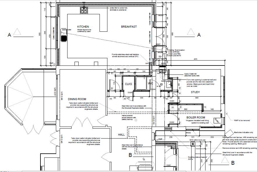

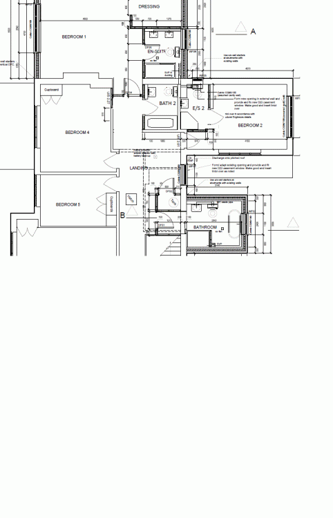

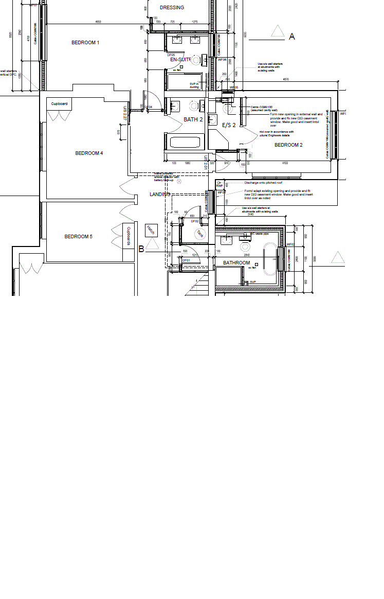

bassanclan Posted October 12, 2016 Posted October 12, 2016 I'm considering the layout for the plumbing system. 5/6 bedroom house with 2 bathrooms, 2 ensuite showers and one downstairs shower. I'm considering a thermal store around 500 litres. I like the idea of the short delay in getting hot water associated with a recirculating hot water system, but I'm concerned that the shower performance could suffer if two people turn on the shower at the same time. The concern of a radial type system would be the delay in getting hot water given that it is approx 8m from the tank to ensuite 1 (and approx 14 to the kitchen sink).
Nickfromwales Posted October 12, 2016 Posted October 12, 2016 I don't think your two concerns are directly related tbh. Having good flow will have nowt to do with a hot return circuit ( HRC ) or standard plumbing, either will be dependant upon pipe sizing, incoming cold mains pressure and flow rates, and your chosen dhw production unit having a good flow rate through it. Which room is the kitchen under.? Can you post the other floor plan please
bassanclan Posted October 12, 2016 Author Posted October 12, 2016 The kitchen is under Bedroom 1, the downstairs shower is under e/s2

Nickfromwales Posted October 12, 2016 Posted October 12, 2016 Ok. Boiling tap with blended instant hot water for the kitchen sink, with one assuming you'll have a dishwasher?. Write the expense of the tap off against the cost of the HRC and associated pipework / complexity and running costs. Go for radial plumbing throughout and consider a cold mains accumulator to reinforce the flow rates if your incoming supply is less than perfect. The delay to ensuite 1 will only be apparent when you run the basin hot taps after a jimmy riddle / other. That can be reduced by running them in 10mm. The baths and showers will be relatively high flow rate outlets so by the time you've turned the tap on fully and selected your favourite loofa the water will be hot. The thing to observe is reducing the amount of large bore primary pipework prior to the manifolds for the hot feeds. FYI, I previously plumbed a similar sized property and ran a HRC for just the basins. That worked well as there were a few satellite basins ( WC's ) which would have suffered otherwise. I chose to run a well insulated HRC and also decided to continue a spur off the HRC down to the very far away kitchen sink ( pretty similar to your layout tbh ). I ran the HRC at 50oC to keep the temp,high enough for 'dish wash' and then put individual TMV's ( thermostatic blending valves ) at each wash hand basin to reduce the water temp to make it comfortable for hand washing, negating the faffing about between hot and cold.

bassanclan Posted October 13, 2016 Author Posted October 13, 2016 Thanks for your thoughts. Boiling kitchen tap has been given a big thumbs down by "the boss" The kitchen sink is on an island, with the pipework having to run under the beam and insulated block floor, so not ideal and another reason I thought the recirculating system would be a good idea. I'm planning on using a WBS with back boiler, gas system boiler and any excess solar PV, which is why I thought a thermal store was the way to go. 1
