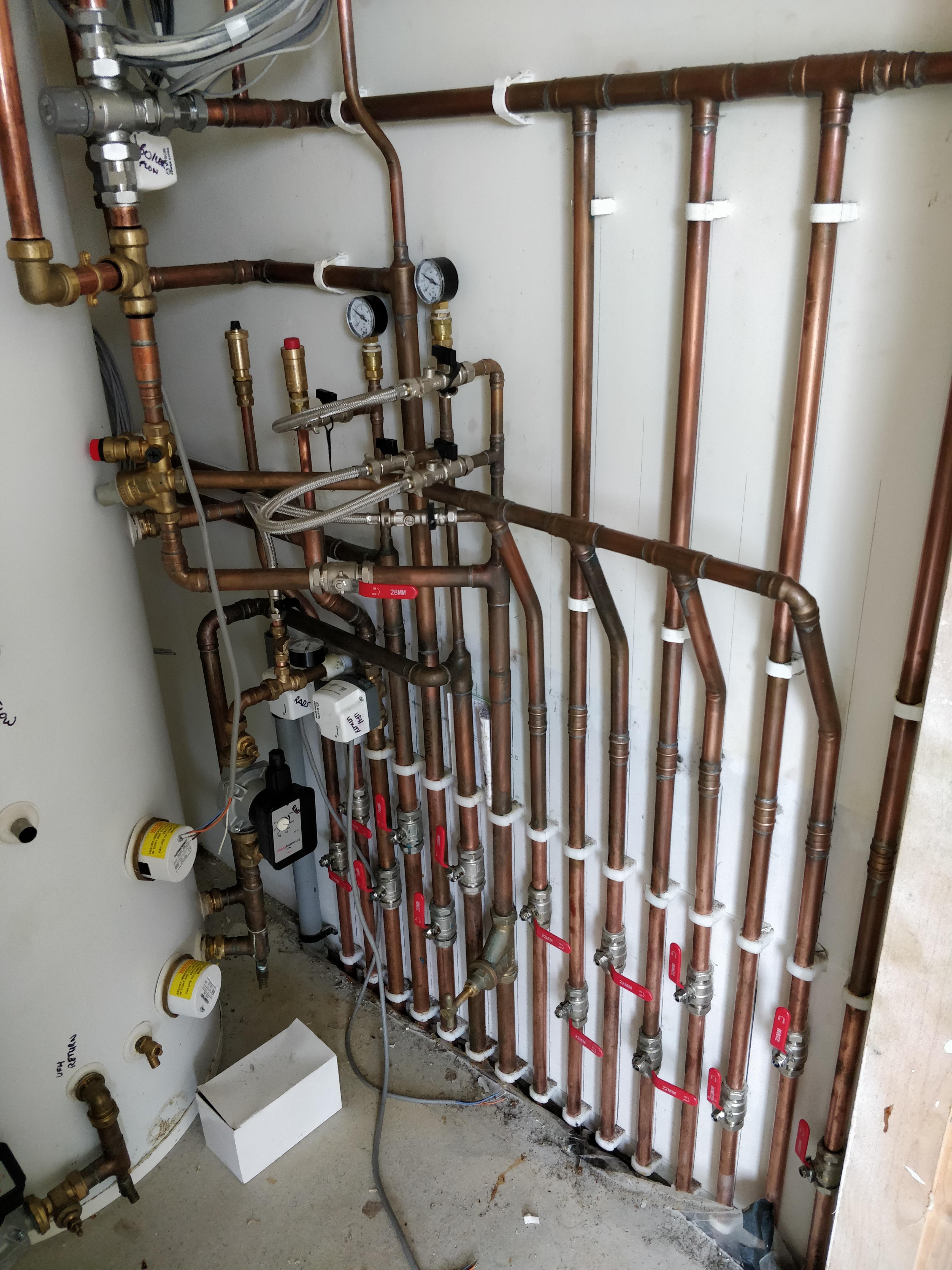

Who fitted the TS? Did they use a pressure reducing valve at the cold water inlet, directly before it? Deffo a mixing fault due to missing / fouled NRV's.
You could solve this possibly by fitting a whole of house PRedV at the incoming cold mains and set that to 3.5-4 bar. Sounds like you have good cold mains pressure adding to the problem.
Getting the cartridges out may or may not allow you to solve the problem, if you cannot get NRV's in there / get to the ones that are U/S. Do you have the manufacturers literature for the basin and the shower units?
Plumber fitted the TS. There is one of these TRV Multi-blocks ( pressure reducing valve and cold mains PRV combination valve with a balanced outlet for matched pressure reduced cold out to the mixer taps ) which is set at 3 bar, though I think I might want to change it for an adjustable one at some point.
What do you mean by get to the ones that are U/S? Manufacturer literature is very poor for both it is more just diagram and measurements.

Do you have a TS or an UVC?
Posted (edited)
Then you should NOT have that multi-block in there at all !!
That was supplied by your plumber then, because Trevor doesn't send multi-blocks out with a TS as its not a HWC but an instantaneous hot water heater with a coil volume of less than 15L.
The coil in the TS is good for north of 7 bar ( nominal ), and rated at 10 bar ( max ). Get rid of that and watch what happens to your flow rate to the shower ;)
Are you 100% sure the cold feeds to the same bathroom come from the balanced cold outlet of that control group ( multi-block ) ?

Interesting cause I didn't think it was needed but there is a reference on the side of the TS saying something about 3bar max which made him insist that it was needed.
Yes bathroom cold feeds definitely come off the multiblock.
Posted
3 Bar max is the cylinder rating NOT the coil rating ;) You 100% do not need it, and it's strangling your flow rate which is why the shower is a bit crappy.
Lose the MB, link through and give it a test run.
Posted (edited)
That's a LOT of 22mm pipework for that many radial runs too. Probably contributes to a lot of extra delay getting hot water out of the basins. ? Looks neat with him though :)
Why 3 x filling loops?!?
Edited by Nickfromwales

That does make sense. So can I just replace the multibloc with a t piece essentially and some more copper?
Kitchen is the furthest away and it wasn't too bad when testing yesterday.
Fill loops for UFH, small rads circuit and then the boiler circuit.
Posted
Yup. Make sure you put a cap end on the discharge pipe so you don't get ant back-flow / draughts through it.

Does the tank prv and tundish not need to connect to it?
Posted
Absolutely. That's the reason I am saying that you should cap the redundant one that will be left open ended after you remove the MB. Otherwise if the TS ones open and discharge the water will squirt out of that then open end.

You reckon there is room for a compression t and a compression straight either side on the vertical, in place of the multibloc.
Posted (edited)
Take the 28mm pipe out of the 1/4 turn lever valve and renew from there. Put a 28x22mm internal reducing set into the nut instead of the olive and thatll get you back onto 22mm pipe from the valve. Keep the top brass nut and fit your straight connector into there. Fit the tee to the horizontal pipe, should fit on the same nut, and just fill in the gaps with 22mm pipe.
