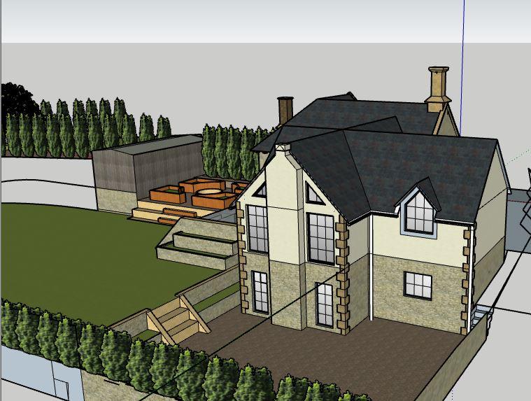

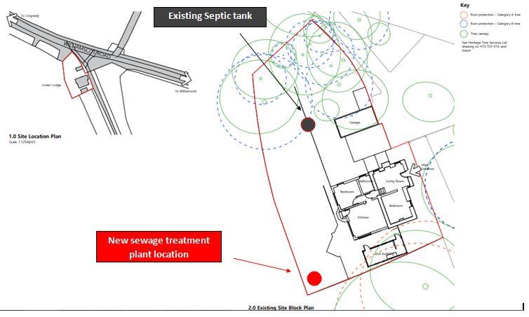

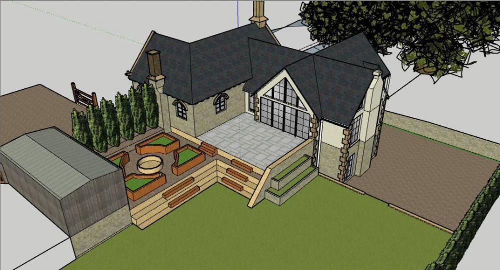

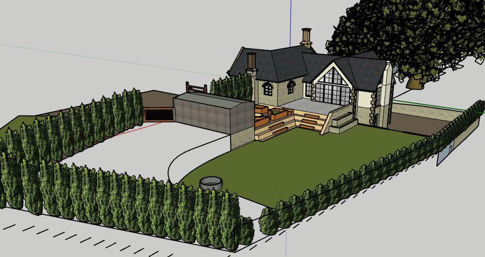

JulianB Posted January 9, 2020 Author Share Posted January 9, 2020 Evening All, It’s been a while since my last post… The good news is that our planning application has been granted against all odds, however it did require us to conjure up enough interest in the village to get it ‘called in’ and decided at committee level (6 in favour, 5 against!). They have placed a number of conditions in our path which are likely to drain more out of the budget and slow us down somewhat, but we’re still smiling! We’re now in the process of drawing up the necessary details to satisfy building control, and we really ought to be finalising our heat energy supply. I haven’t yet attempted to calculate the energy demand of the house (from JHarris’s spreadsheet), however I was under the impression that from a CH POV, ASHP should present us with a good improvement from our current oil fired boiler setup. We intend on integrating UFH in both the old and new part of the house. That said, the new part of the house is an upside house…i.e. upper level will be for living and lower for sleeping…I’ve seen UFH installed over floor joists (for the 1st floor living), but am keen to get people’s opinion on it? With regards to DHW, my wife and 2 children (& counting) enjoy their long showers/baths, and I’m aware that above ~45 degC, CoP plummets w.r.t. the majority of ASHPs? I have also read about people using the ASHP to supply the DHW tank with water @ 45degC, and then using an alternative source top up the remainder to get to say 65degC? Solar seems to be a popular option, but given our proximity to mature trees, seems an unlikely candidate? Wind however is something we do have a great deal of (the good kind!); being situated on the top of a valley, we really do get fairly good gusts on most days, but I haven’t yet grasped whether this is a viable / realistic route for the domestic market, and particularly given that we are in quite a sensitive area in terms of focal points (& our pockets aren’t deep!). Would using the grid to top up the remainder of the DHW needs be a viable option, or would we be better off scraping the whole idea and sticking with a more modern (& hopefully more efficient) oil fired system? Any advice would be greatly appreciated! 1 Link to comment Share on other sites More sharing options...
