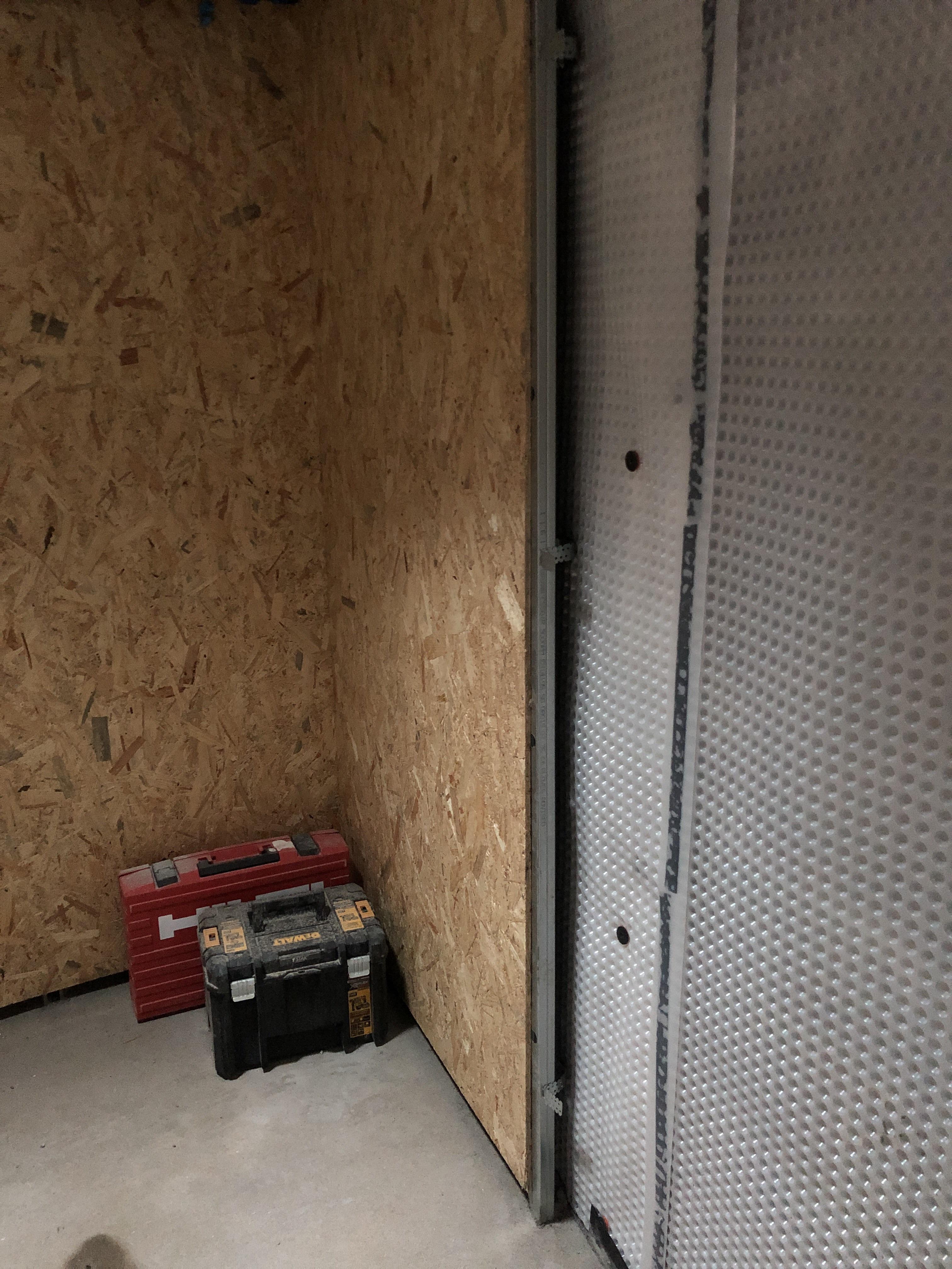

Dreadnaught Posted October 4, 2019 Posted October 4, 2019 (edited) 29 minutes ago, pocster said: Stud work going good Just out of general interest, I wonder did you ever consider using metal studwork, @nod-style? I am tempted. Edited October 4, 2019 by Dreadnaught
Pocster Posted October 4, 2019 Author Posted October 4, 2019 32 minutes ago, Dreadnaught said: Just out of general interest, I wonder did you ever consider using metal studwork, @nod-style? I am tempted. Ahhhhhhh I have ! All below ground is metal stud ( though I’ve only done a tiny portion) . Ground level just went with timber because it’s a timber frame ( yeah I know ! No logic there ) Underground metal stud photo ... 1
Dreadnaught Posted October 4, 2019 Posted October 4, 2019 Oh interesting. How do you compare using the wood to metal? Which do you prefer using? 2
Pocster Posted October 4, 2019 Author Posted October 4, 2019 8 minutes ago, Dreadnaught said: Oh interesting. How do you compare using the wood to metal? Which do you prefer using? Lol ! When I first started with metal I hated it - screwing it together and cutting it a right pain . Then I got into it ! . Loved every piece is dead straight - get a magnetic level and you are laughing . Back on timber now - prefer it . TBH as I will end up swapping between them it would be hard to choose one over the over . Do both ? 1

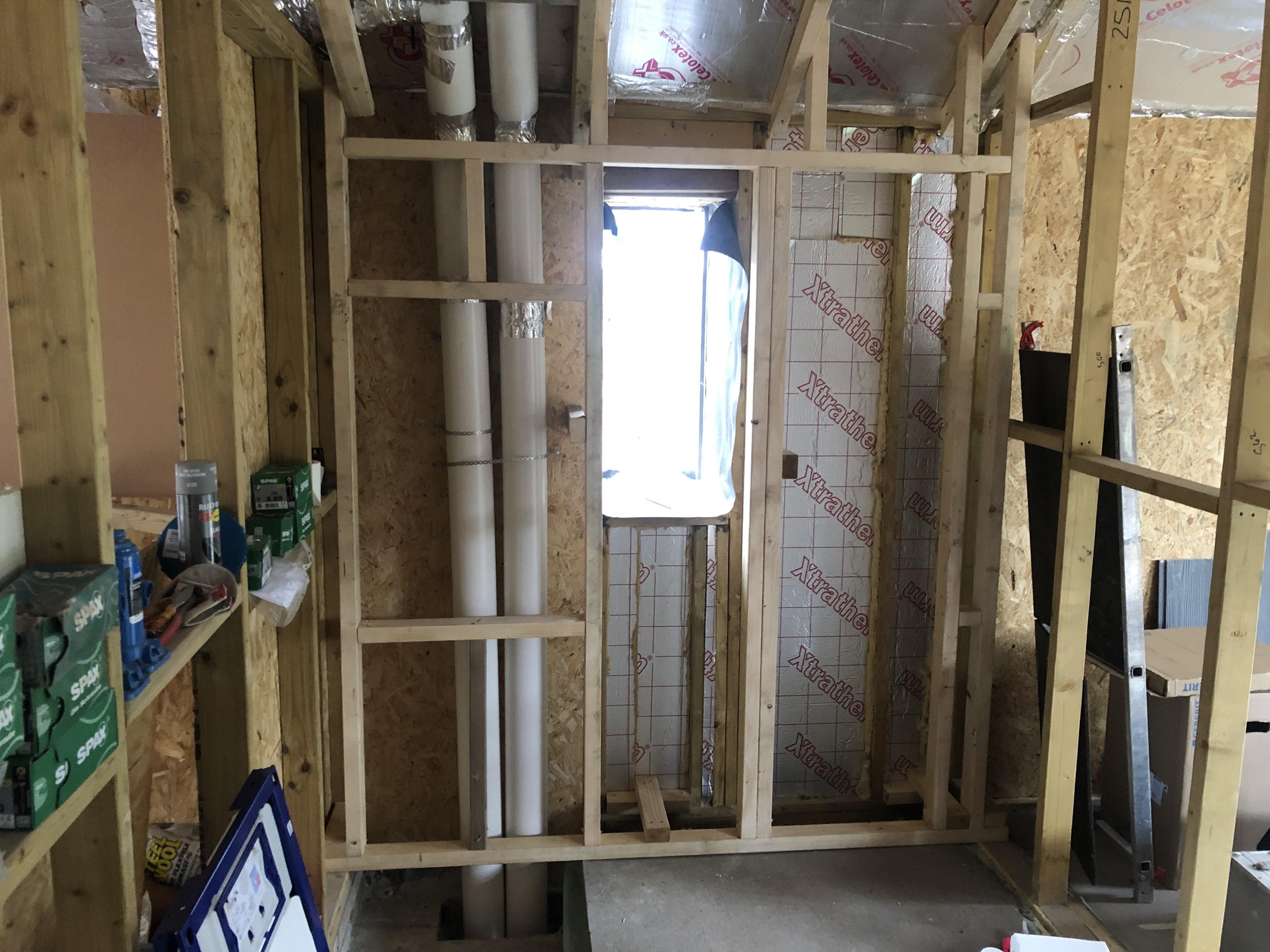

Pocster Posted October 4, 2019 Author Posted October 4, 2019 Right that’s pretty much it . Some extra noggins to support plasterboard at edges required later . Space infront of the vertical white pipes to allow for tv screen at end of bath . Space above where geberit cistern is going should allow for some recessed storage . 1
