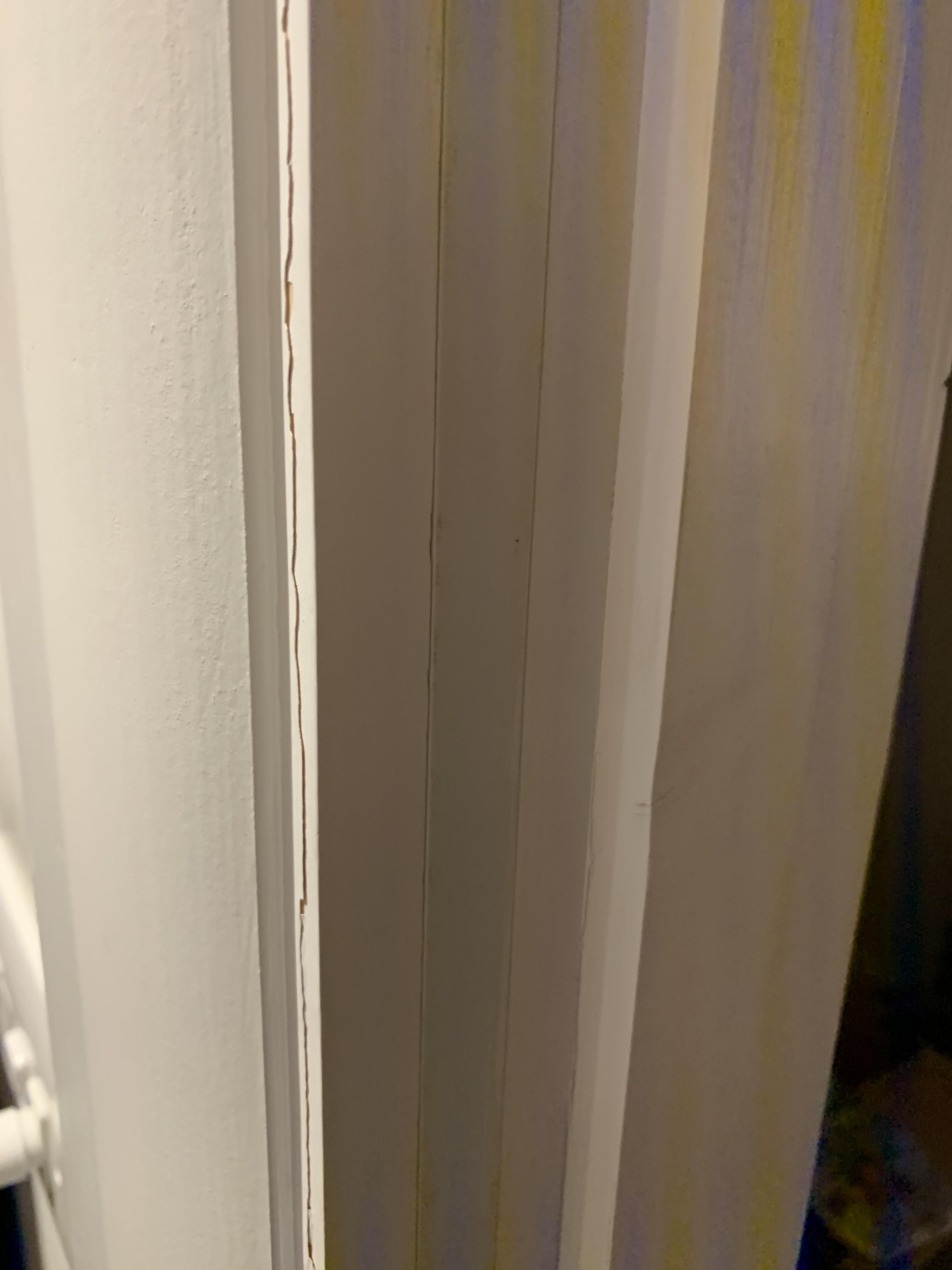

ProDave Posted September 28, 2019 Posted September 28, 2019 Simple question: How much clearance is needed around an internal fire door for the intumescent seal? More detail. This is the door between our utility room and the garage. when I hung the door, it has always been a bit tight on the intumescent strip, needing a good slam to shut it. I doubt it would have closed with a door closer. So I was always planning to plane the door a bit. Now in the last few days the utility room has been plastered, and now with the humidity of the wet plaster that door now won't shut. So time to plane it. But the question is simply, does the door need to "brush" on the intumescent strip as it closes, or is the theory that the strip expands with heat to seal the gap. If so what gap is allowed? I'm worried about planing the door now and when it shrinks back to size being too loose.

ProDave Posted September 28, 2019 Author Posted September 28, 2019 15 minutes ago, MikeSharp01 said: Yep this link sort of explains - well the PDF does. https://www.promat.co.uk/en/products/promaseal-expansion-joint It looks nothing like that. It's a fire door, door frame and intumescent strip all from Howdens. the strip sits in a groove in the door frame and the bit in the groove is plastic, but the bit that "presents" itself sticking out of the groove is a bit like a brush strip. I want the door to close easily (so a door close will shut it without problem) but I don't want there to be too much gap that BC fail it because it is not fire proof. So does the door have to touch the strip, or just come close?
PeterW Posted September 28, 2019 Posted September 28, 2019 So that is a full brush smoke seal, not an intumescent strip. 2p piece all round is ideal but an intumescent strip will expand to 6-8mm at least anyway In the event of a fire.
ProDave Posted September 28, 2019 Author Posted September 28, 2019 8 minutes ago, PeterW said: So that is a full brush smoke seal, not an intumescent strip. 2p piece all round is ideal but an intumescent strip will expand to 6-8mm at least anyway In the event of a fire. It was sold to me by Howdens as an "Intumescent strip" Are you saying it is not? I think it is this one https://www.howdens.com/hardware/screws-and-ironmongery/door-furniture/door-closers/intumescent-fire-strip-21m-obj-sku-family-its0005 So the bottom line is I can plane the door so it almost touches the strip and the strip will expand to fill the gap in a fire?
PeterW Posted September 28, 2019 Posted September 28, 2019 That’s a fire and smoke strip - they do a fire strip which is just the plastic without the brush.
