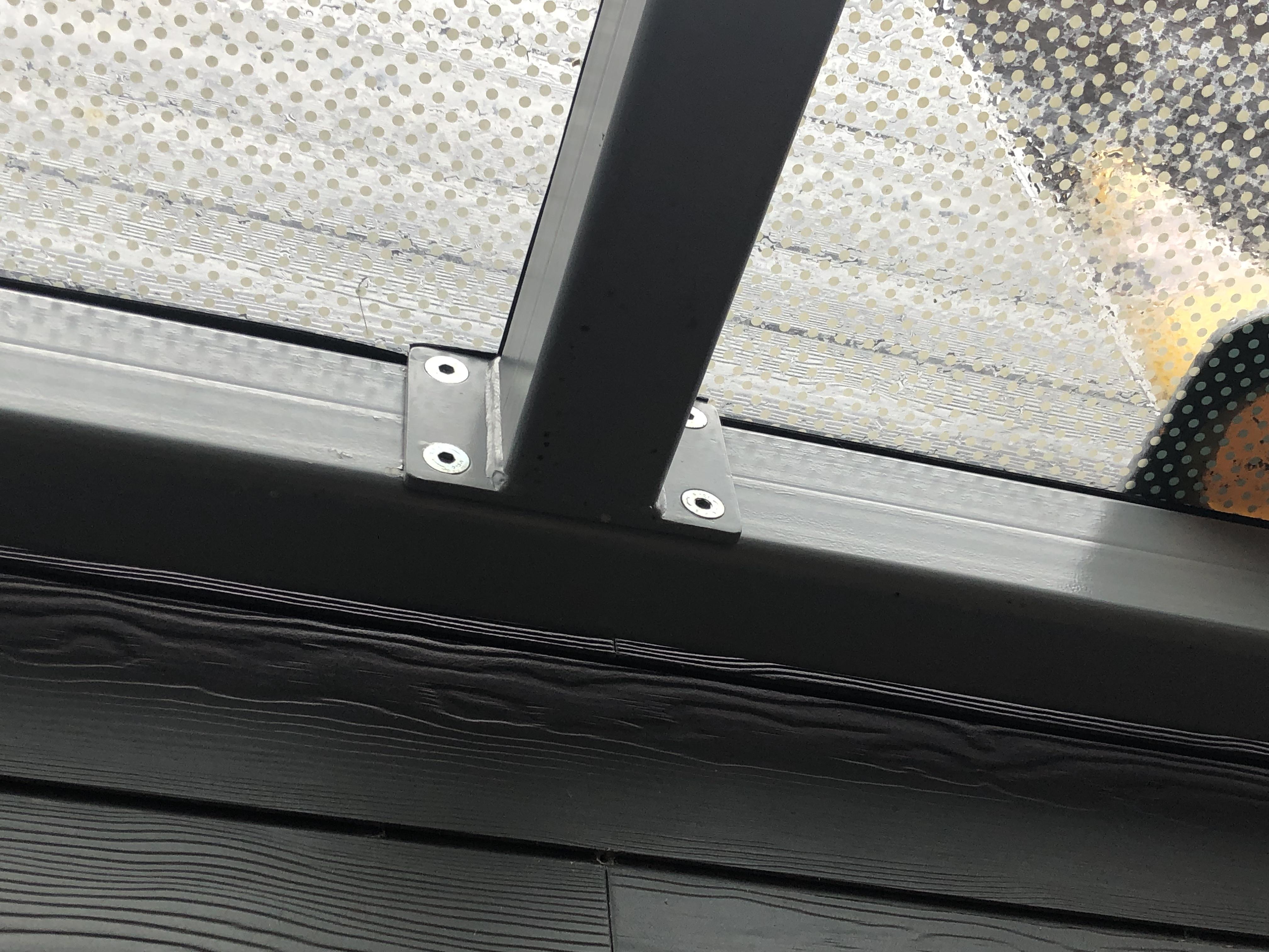

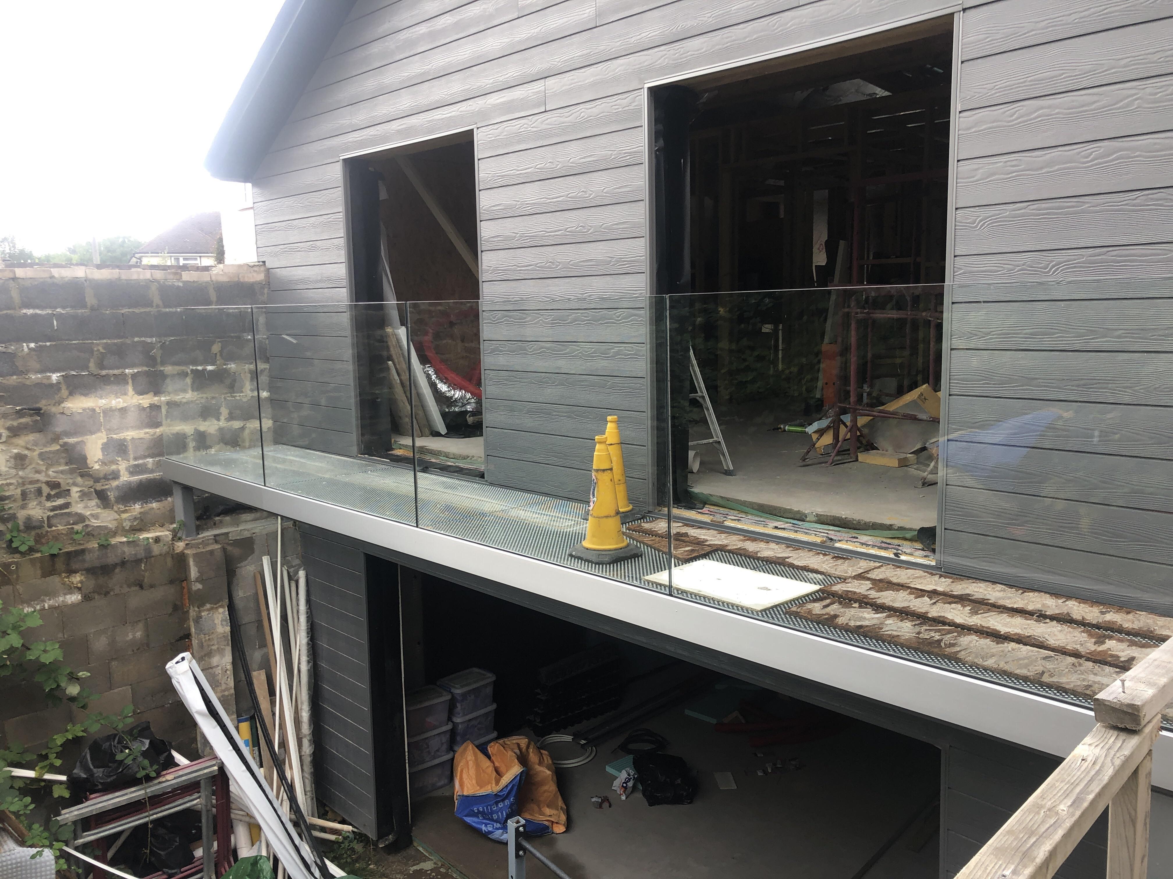

Hi Pocster,
Looking at your photo, have you used anodised alu channel for the frameless balustrade and was it bolted into galvanised steel?  If so, what sort of bolts did you use and were you able to take any precautions against galvanic corrosion?
24 minutes ago, D Walter said:
Hi Pocster,
Erm !
The steel beams are indeed powder coated I believe . The installer supplied bolts etc. - it was a custom job so I did nothing ?. I can later get a photo underneath so you can see the bolts - from memory there’s no sign of corrosion..... yet !
Thanks Pocster.  The risk of galvanic corrosion between alu and galvanised is relatively low in any event.
Not sure how helpful this photo is . After a year no obvious sign of corrosion
