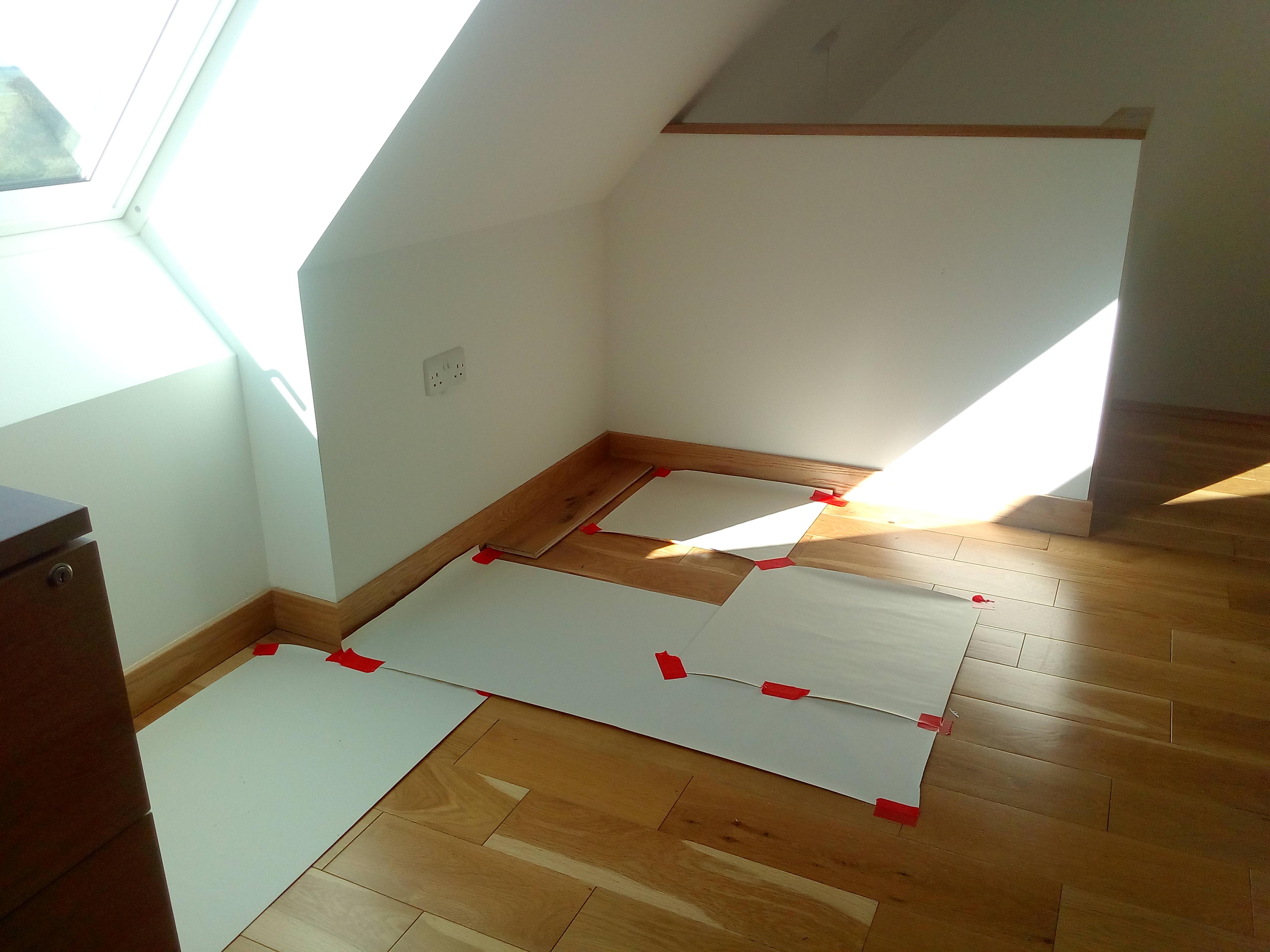

Stones Posted September 18, 2019 Posted September 18, 2019 Attached is a plan of my proposed office layout (apologies for poor quality of scan). The room is formed from attic trusses which means the coomb meets the wall at a height of 850mm. Because of this, it's a little challenging to sit a PC monitor on a desk simply run along a wall - it either has to be positioned in a corner, or on a peninsula of desk. I have a velux window recess where I would like to construct my desk area, both for the view and added space, and have come up with the attached as a layout that I could form from two 3m lengths of oak worktop. Alternatively I could use oak veneer MDF, or a ply base with engineered oak flooring glued on top for a finished surface. I have two options in terms of oak worktop - 27mm or 38/40mm. As I would be butting joints together to form the shape indicated in the plan, would 27mm be viable given I'm going to have route and bolt? I've still not discounted the plywood / engineer oak option - just need to look at some flooring samples to find a smooth surface product. Office layout.pdf

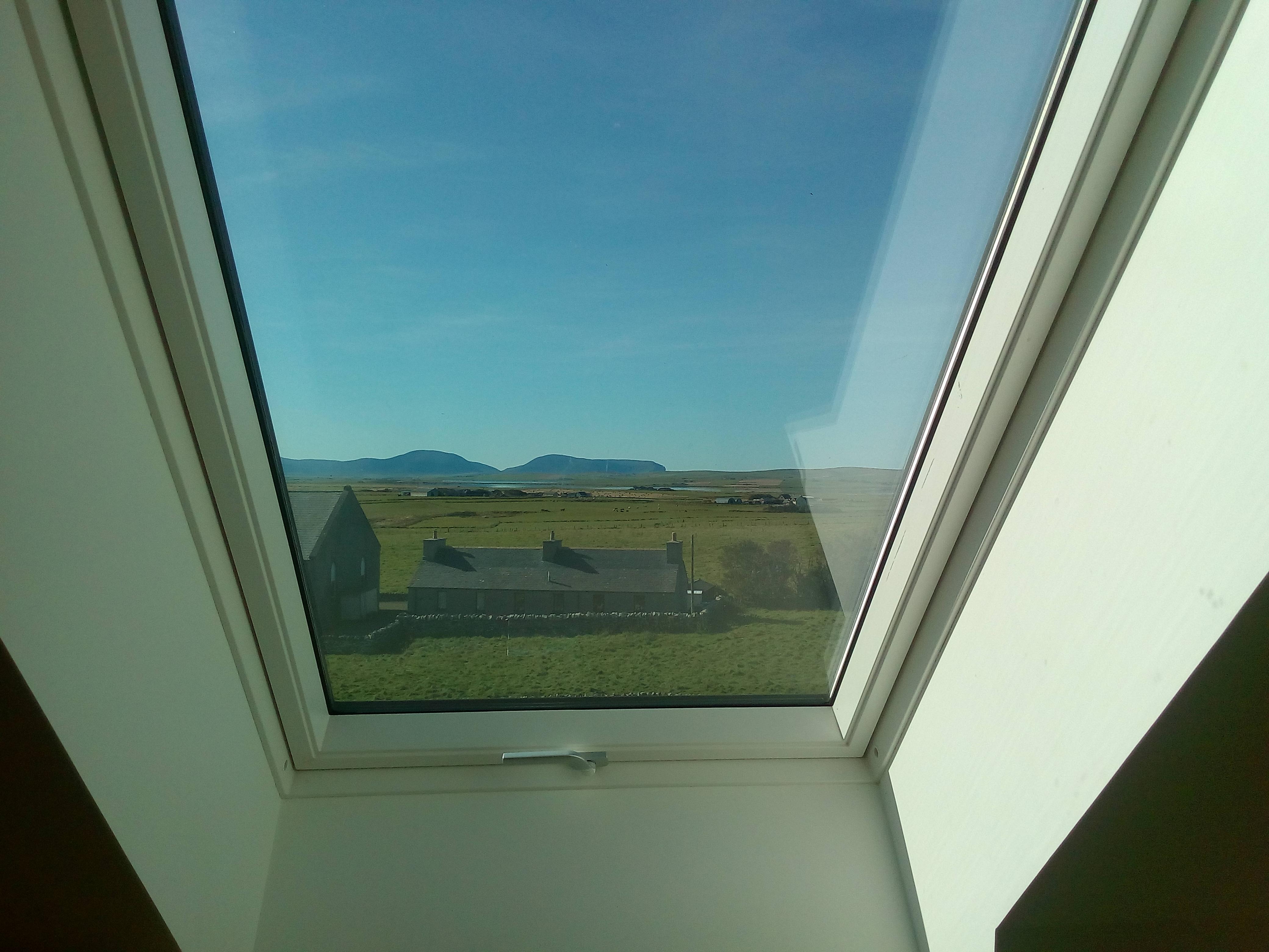

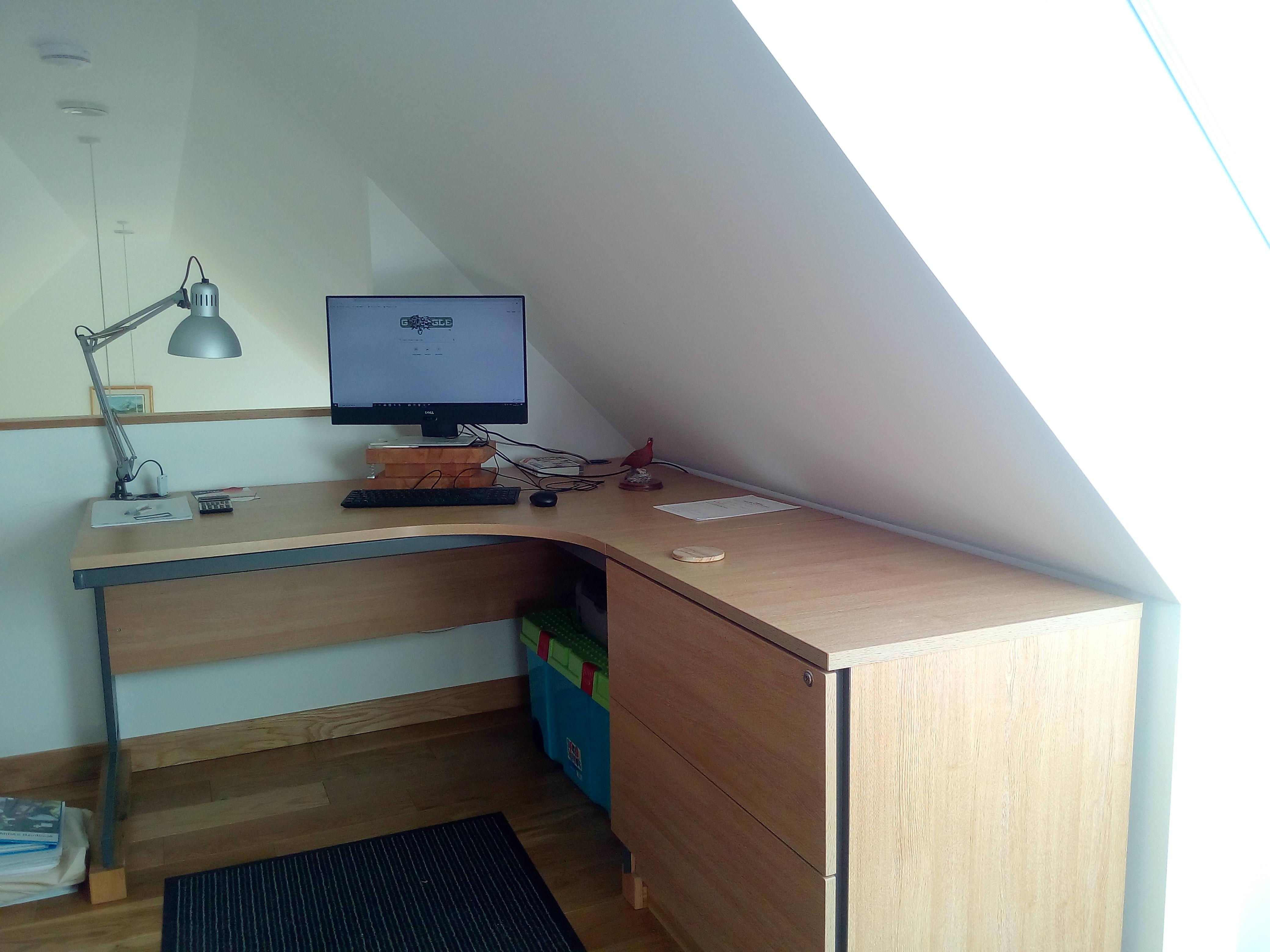

Stones Posted September 20, 2019 Author Posted September 20, 2019 Some pictures for context. 1st shows existing, functional but soul destroying layout. 2nd shows proposed position marked out on floor, desk space directly under window, PC on desk space at 90 degrees to the window. Indent at balustrade for built in seat or house plant. 3rd the view I want to see from my desk.
Stones Posted September 20, 2019 Author Posted September 20, 2019 To get the height I need standard office furniture has to be lifted on blocks. Off the shelf therefore not really an option.
ProDave Posted September 20, 2019 Posted September 20, 2019 Nice view of Hoy. Just watch that at a certain time of day, the sun may shine on your PC screen (like about the time the photo was taken). Do you have a blind on the window? Your soul destroying layout has the benefit of putting the PC in the shade. Would it not make more sense to keep the PC that side, but move it out from the end wall so your seating position lines up with the window still to get the view?
