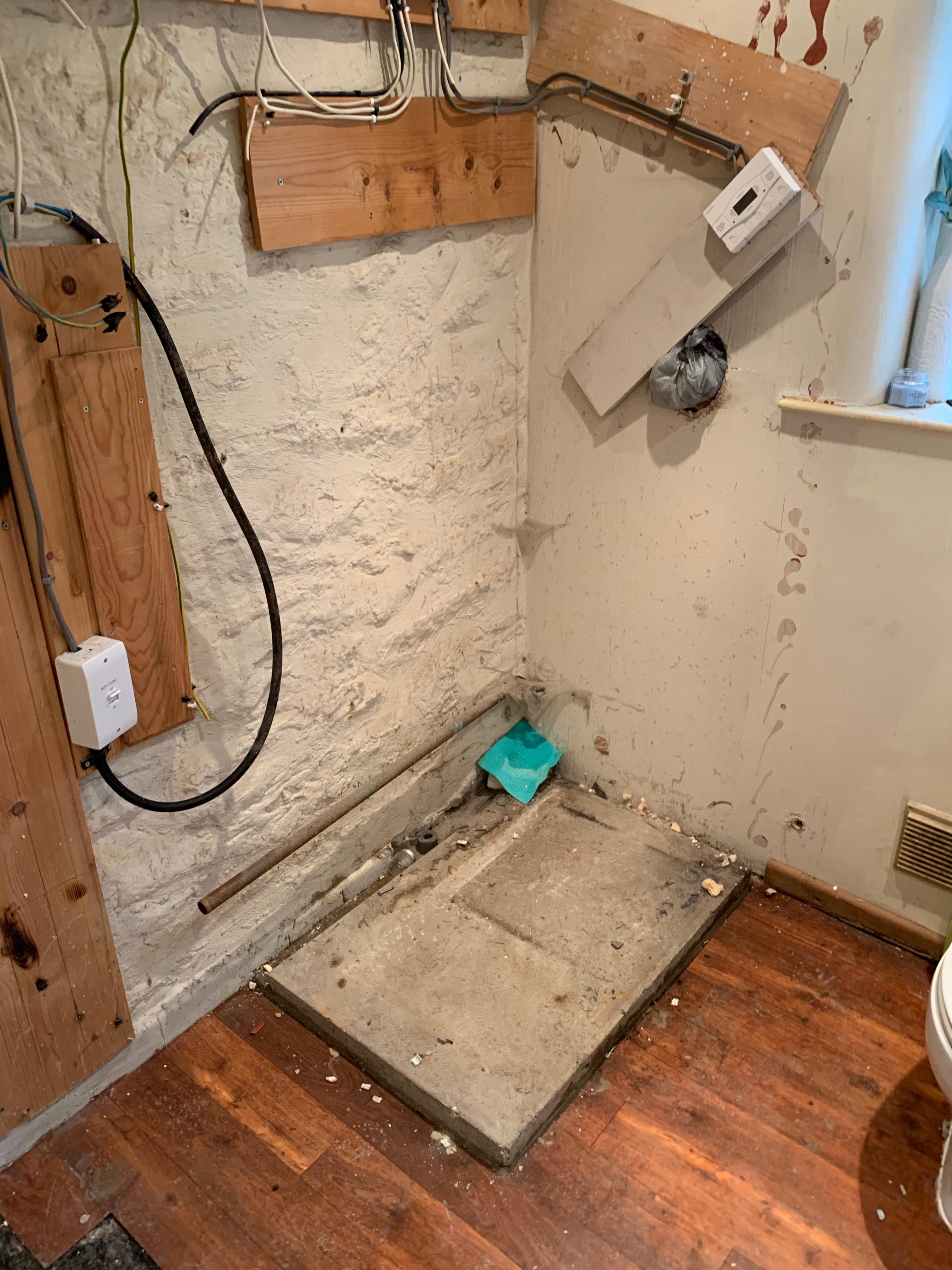

The week has finally arrived to have our old oil boiler and a huge 500L water tank ripped out and a new AHSP installed :)
Can't wait - especially as we now have no hot water until it's connected!

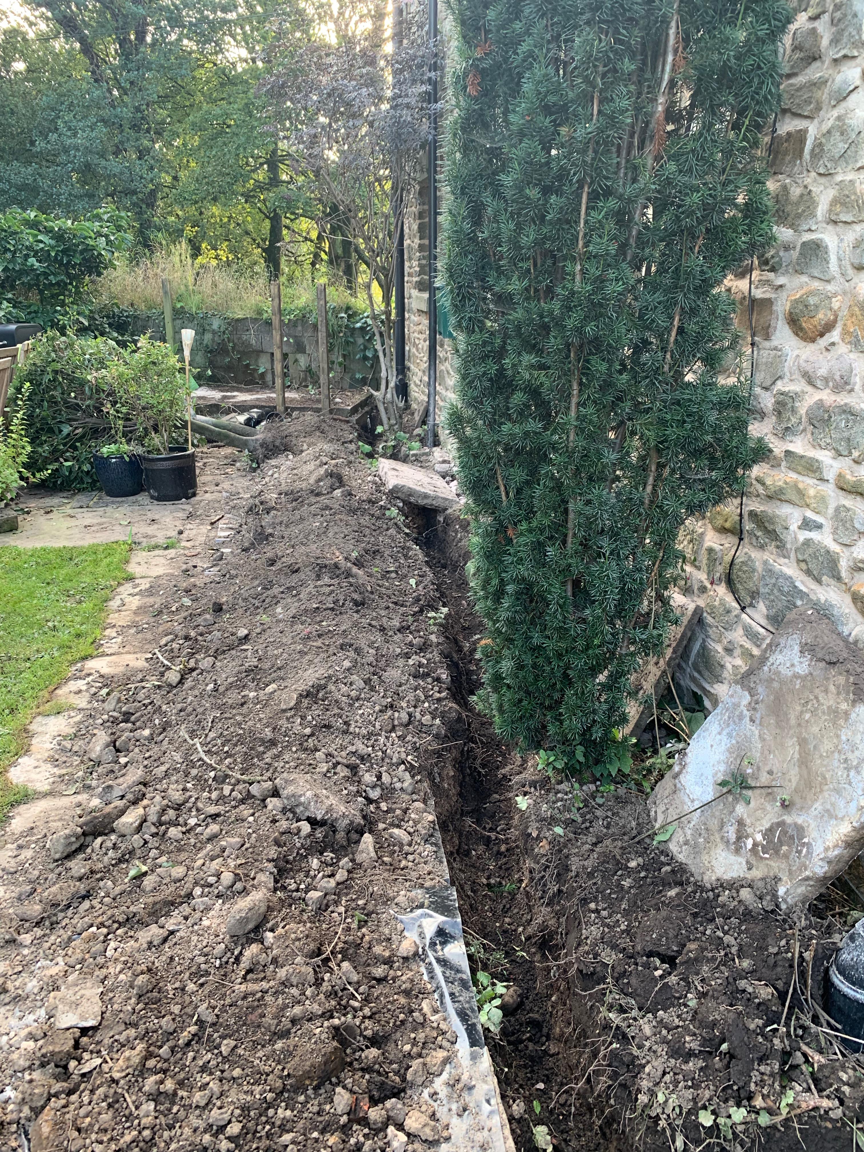

So far the oil tank has been removed, we've dug a big trench to lay the pre-insulated pipe into, and the old Whitebird 120/150 oil boiler is going on eBay!

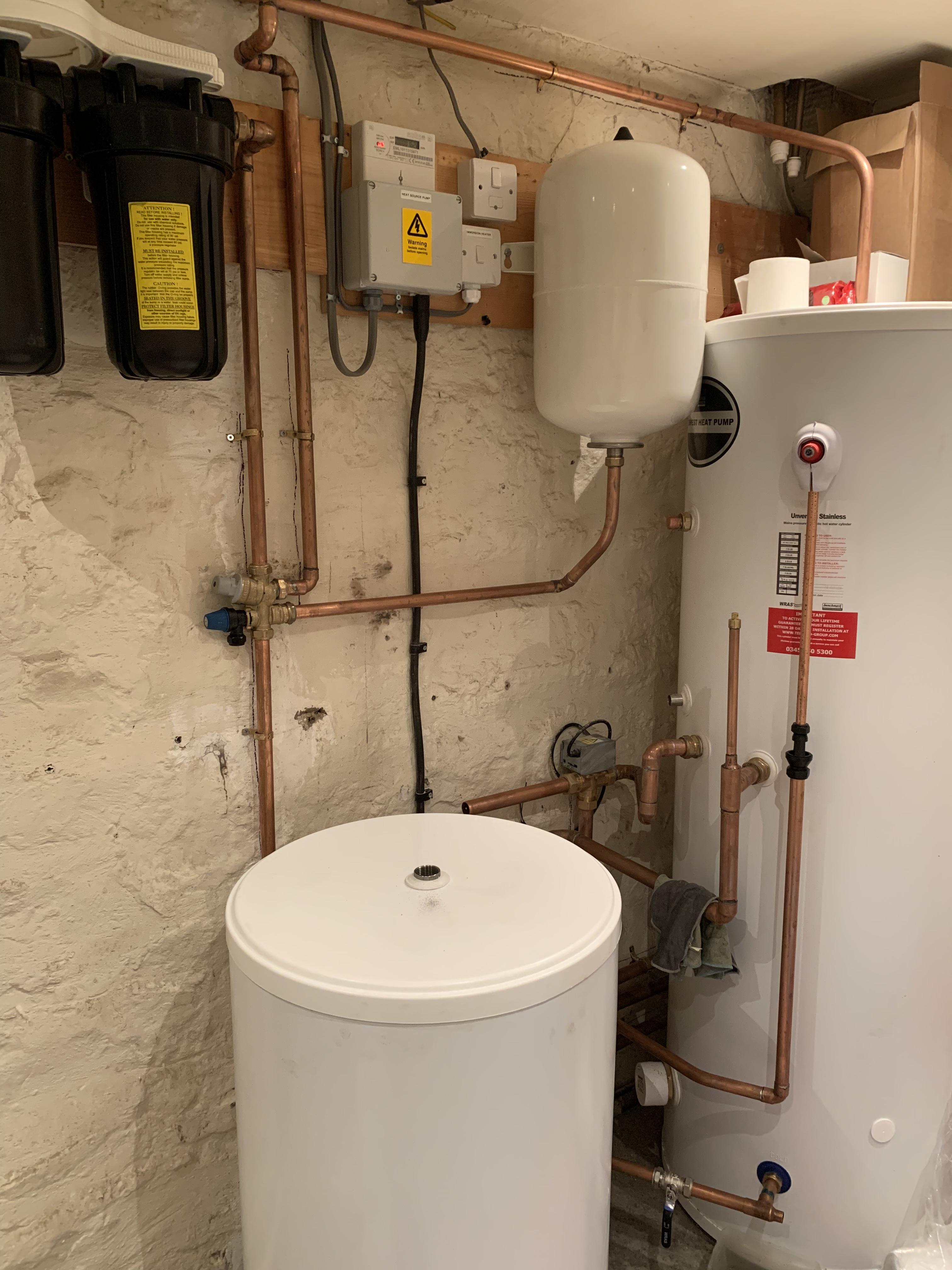

Hopefully today the cylinder will be in so we can have a warm shower, then everything else will get connected up and commissioned tomorrow
I am!

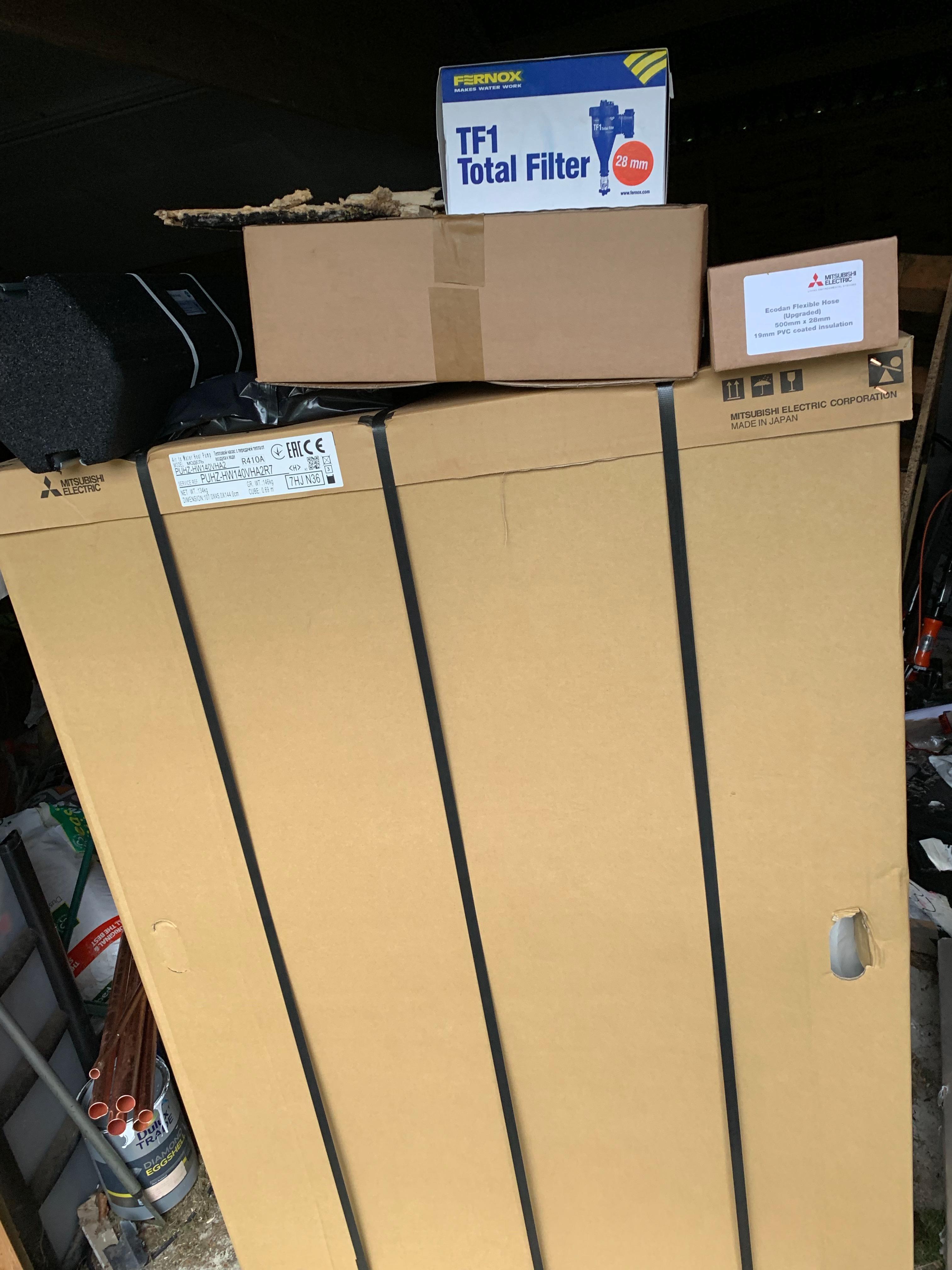

We’re  getting there. Tanks and water filters (chlorine/etc) in today.

We we didn’t really want the heat pump smack bang in the middle of the house layout so it’s gone where the oil tank was. Using pre-insulated buried pipes so hopefully heat loss will be minimal.

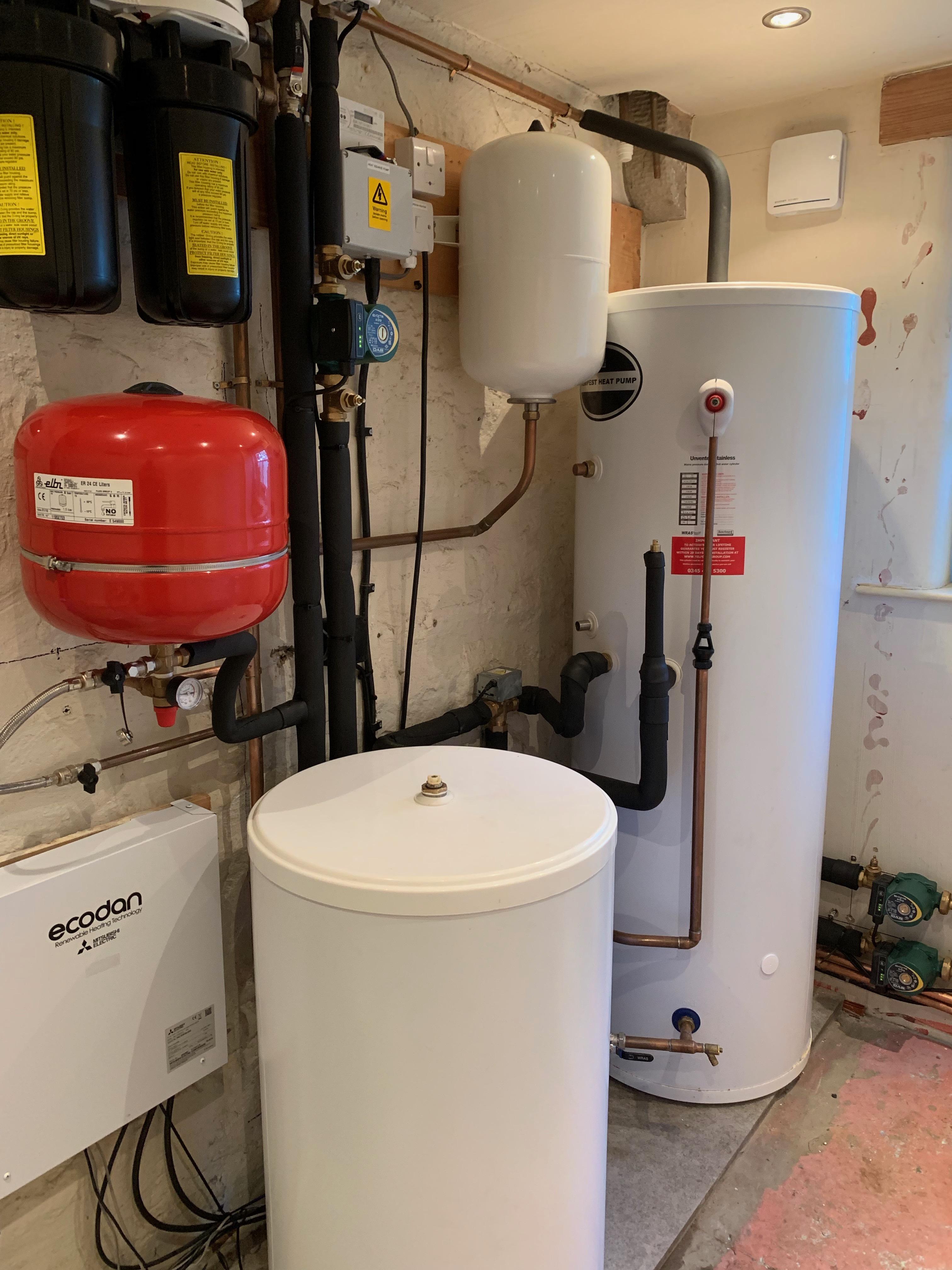

And we're done, all installed and working :)
We've not had an oil boiler since May so glad it's in! use in time too by the looks of the news with the Saudi oil strikes.
Great that we're fully pumped now and not on the horrible gravity fed system we had - so many air blockages previously!
Now to try out the underfloor heating!
