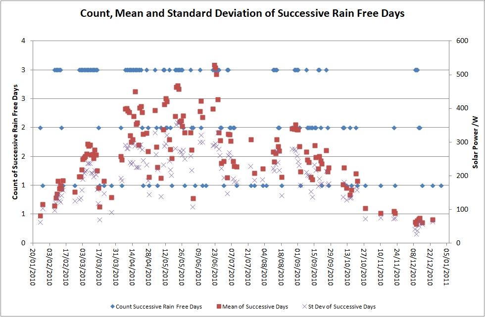

SteamyTea Posted September 12, 2019 Share Posted September 12, 2019 (edited) I took a slightly different approach. I looked for a rain free day during the hours of daylight, then looked to see if the next two days were rain free (left axis, blue diamond). If they were, I looked at the mean and standard deviation of the solar power, during the hours of daylight, in watts (right axis red square and purple cross) for the full 3 days. There is not a full years worth of data (got to drag some more out), but it shows a rise in mean power as summer approaches. The 'gap' in the data during July and August is not missing data, it is the rainy season down here, better known as school holidays. I have not done a proper correlation yet, truth is, it is late, and I can't think of an easy way to show it. But a quick visual scan shows more power during times of rain free days. Edited September 12, 2019 by SteamyTea Link to comment Share on other sites More sharing options...

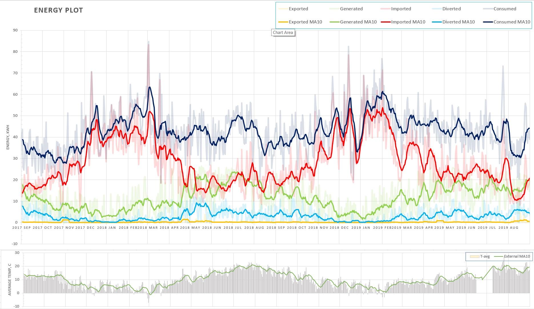

ragg987 Posted September 13, 2019 Share Posted September 13, 2019 (edited) Example visualisation - not directly related to your correlation question. Hopefully self-explanatory, "Diverted" refers to spare energy sent to my immersion heaters rather than being exported. As subsidised by @SteamyTea. Edited September 13, 2019 by ragg987 Link to comment Share on other sites More sharing options...
