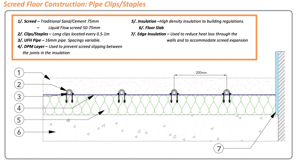

gc100 Posted September 9, 2019 Posted September 9, 2019 Hi, I've got a 155m2 house to build and I'm getting quotes of around £4K for the UFH part (and then the ASHP/fitting on top). Does that sound about correct or expensive? Thanks!
BotusBuild Posted September 9, 2019 Posted September 9, 2019 Is that supply and fit? Or just supply? Need to compare apples with apples ? What components are being quoted for? Manifolds? Pipe?
CC45 Posted September 9, 2019 Posted September 9, 2019 thats a lot more than I paid for just supply. Wunda supplied ours - 145m2 of UFH @ a cost of £1,213 + VAT (May 2016).
Alexphd1 Posted September 9, 2019 Posted September 9, 2019 Depending on spec you should be around the 1k for material only. Controls can add a bit depending on what you want. Laying UFH pipes can be done yourself and employing a plumber to connect manifold at a later date.
gc100 Posted September 9, 2019 Author Posted September 9, 2019 This was supply and fit: Supply & Install: Under-Floor Heating to Ground floor (Based on a Clip/Staple & Screed system) Includes: • 1 x 9-port Manifold • 1 x 7-port Manifold • 16mm UFH Pipe • EK16 Pipe Connectors • Pipe Clips/Staples • Edge Insulation – to be installed by others • 5 x Room thermostats. • 6 x Zone Actuators • Installation is to install pipe and manifold. Pressure testing of pipework. Labour & Materials = £3,895.00 VAT @ 0% Primary pipework. Pipe and installation from heat source to manifold. Labour & Materials = £300.00 VAT @ 0%
Alexphd1 Posted September 9, 2019 Posted September 9, 2019 (edited) I am a bit lost with the spec. 1x 9 port, 1x 7 port manifold and 6 actuators? Edited September 9, 2019 by Alexphd1
Alexphd1 Posted September 9, 2019 Posted September 9, 2019 I haven't used 1st hand but a lot of people on here have used wunda ufh.
gc100 Posted September 10, 2019 Author Posted September 10, 2019 Just to add, this price is installed and supply
recoveringbuilder Posted September 10, 2019 Posted September 10, 2019 Is this 155m2 ground floor? We paid £4K for ours supply and fit, which was around 154m2 , the fit though was only the laying of the pipes and connecting to manifold and air test which cost just over £1k , we still had to do everything else connected to it which I didn’t realise at the time, I expected them to come back to install everything else, personally I think for £1k we could have done it ourselves as we had done on our previous build but I thought I was saving hubby a lot of hassle when in fact they did the easy bit!
PeterW Posted September 10, 2019 Posted September 10, 2019 10 hours ago, Alexphd1 said: I am a bit lost with the spec. 1x 9 port, 1x 7 port manifold and 6 actuators? I saw that too. @gc100 when they state “manifold” is that just the brassware or are they also including the pumps and blending valves as they can add £2-300 per manifold depending on spec.
gc100 Posted September 10, 2019 Author Posted September 10, 2019 1 minute ago, PeterW said: I saw that too. @gc100 when they state “manifold” is that just the brassware or are they also including the pumps and blending valves as they can add £2-300 per manifold depending on spec. I have no idea to be honest. I'll have to go back to them.
