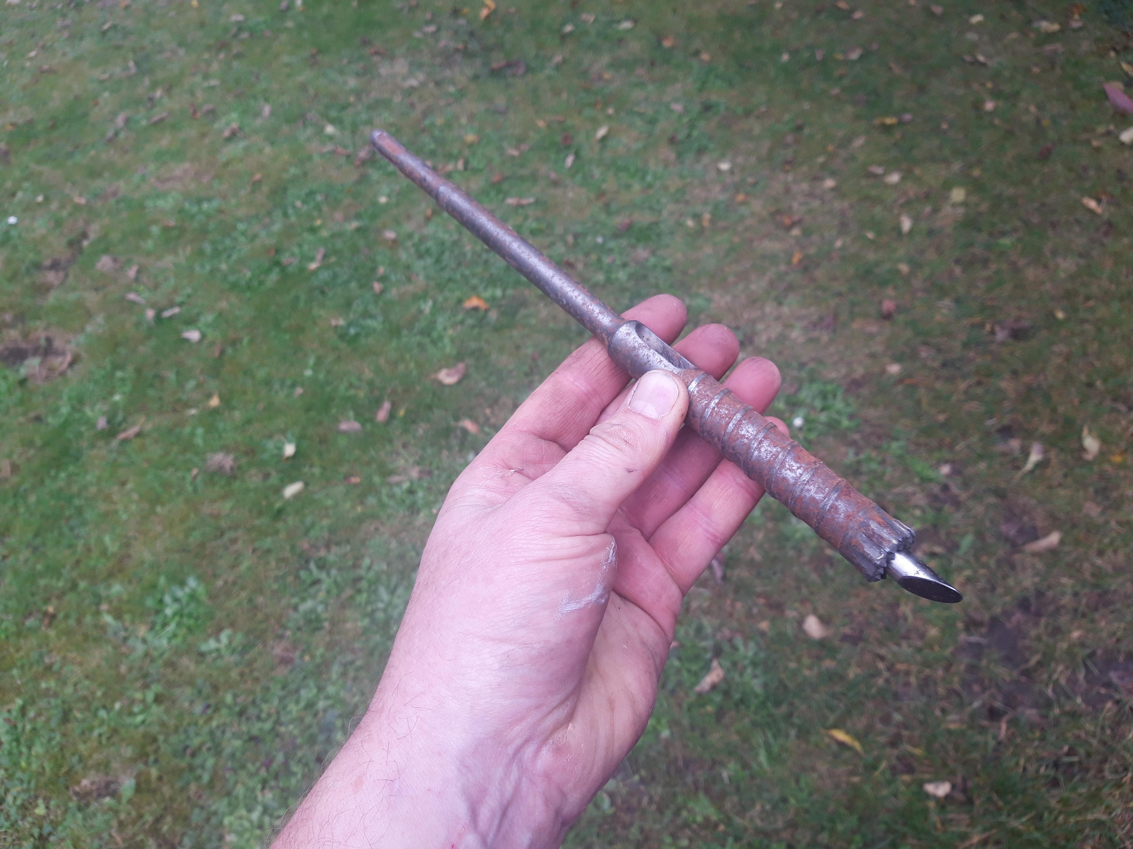

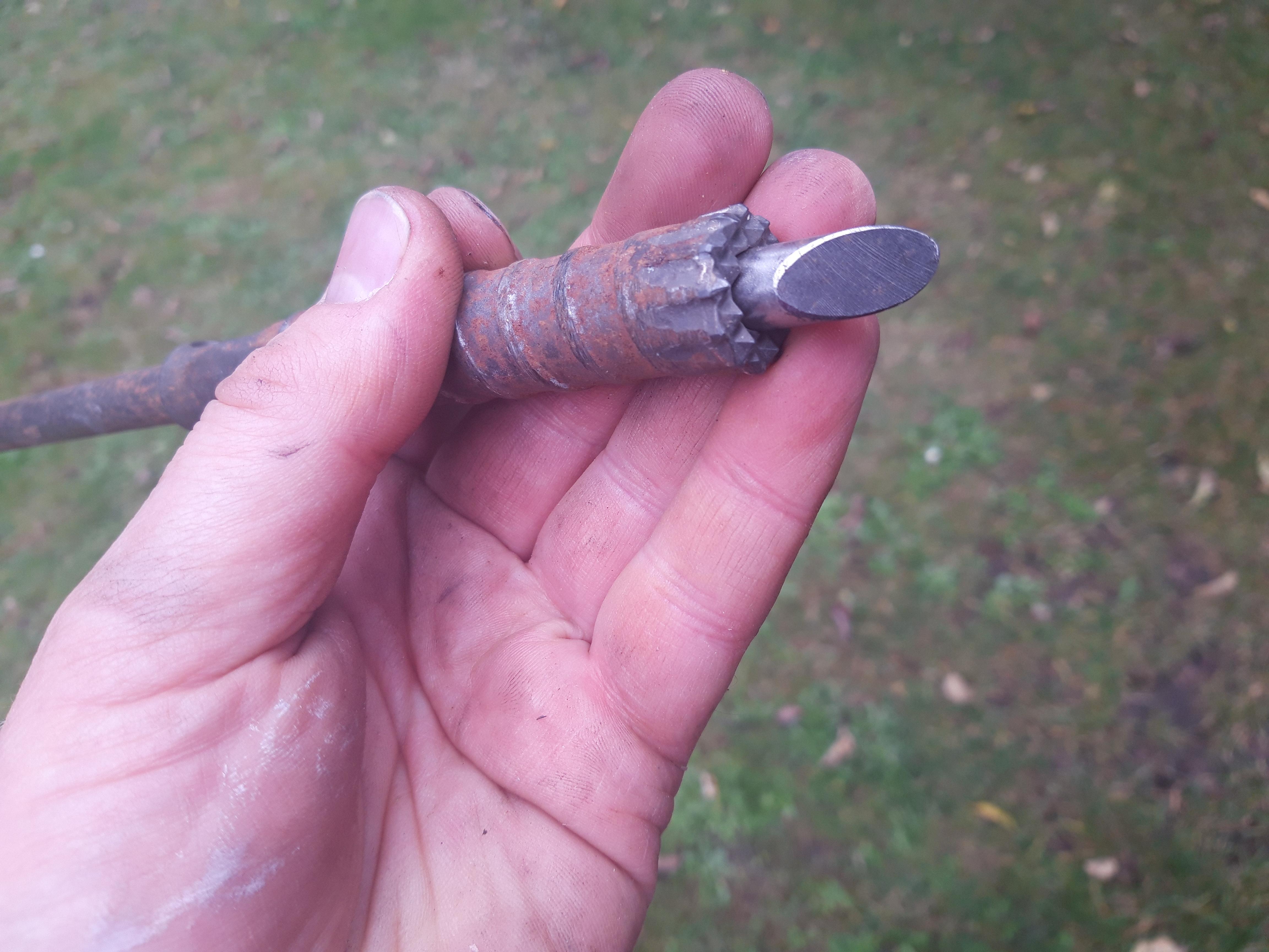

Onoff Posted September 28, 2019 Share Posted September 28, 2019 I found that rebar bit I mentioned a while back in this thread. 20mm, SDS, German Hawera brand: Link to comment Share on other sites More sharing options...
