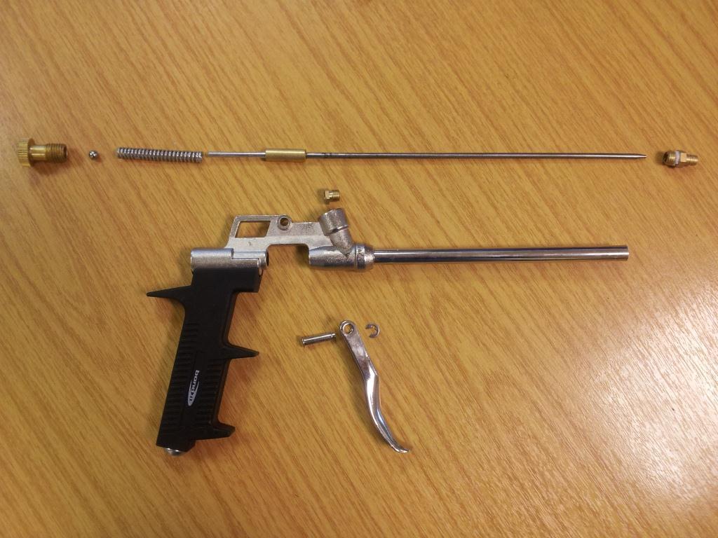

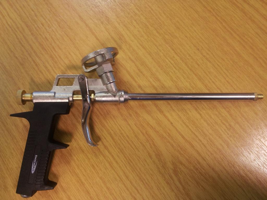

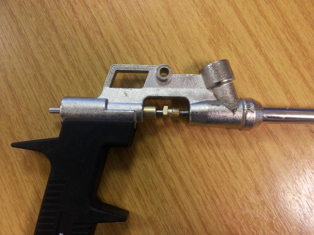

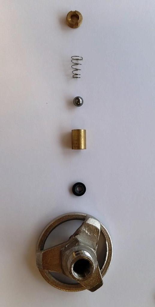

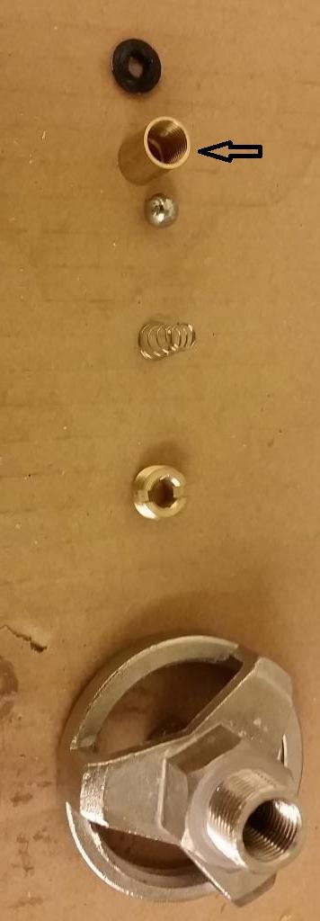

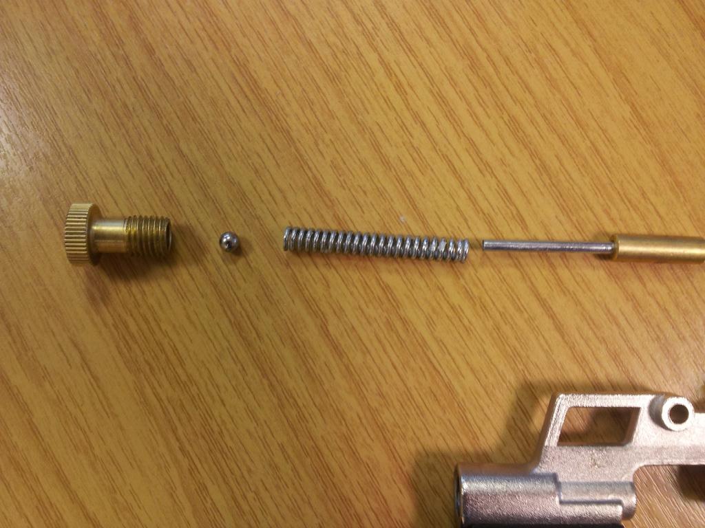

gravelld Posted September 5, 2019 Share Posted September 5, 2019 (edited) Not sure if it helps but Bond-It sent a series of pictures of how to disassemble their guns (they're pasted below in reverse order). Edited September 5, 2019 by gravelld 4 Link to comment Share on other sites More sharing options...
