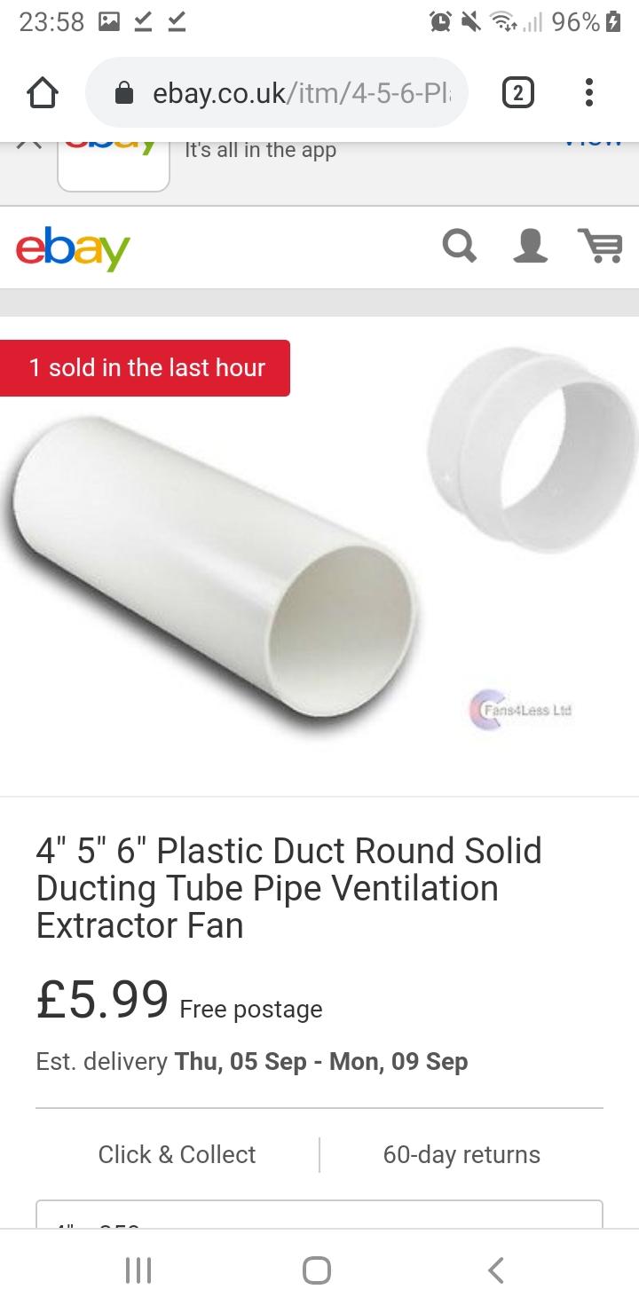

Onoff Posted September 1, 2019 Posted September 1, 2019 I've ordered a bit of 100mm pipe and a coupler: However...as it is the bathroom gets so humid when used as a wet room, the current extractor fan will run for a good few hours or more until it's below 65%. I've yet to check if I've an adequate gap under the door. If I connect the pan to the extractor won't I just be sucking warm air out of the room that way too...for hours?
dpmiller Posted September 2, 2019 Posted September 2, 2019 only a small proprtion of the flow will manage to make it up the small pipe. 1
Onoff Posted September 2, 2019 Posted September 2, 2019 On 02/09/2019 at 05:48, dpmiller said: only a small proprtion of the flow will manage to make it up the small pipe. Expand I just hope it's enough! I'm blaming the prawns I ate last night.
Onoff Posted September 7, 2019 Posted September 7, 2019 (edited) I bought a 100mm dia pipe and coupler to extend where the extractor comes up through the ceiling: The pipe coming up from the Geberit cistern into the loft is 32mm solvent weld so I've got a few extra fittings: The plan is/was to drill a 36mm OD hole in the side of the pipe then introduce an elbow, with a straight coupler the other side, linked with a short bit of pipe. I'd lay sandpaper on the 100 dia pipe and rub one end of the elbow and coupler on it to concave the faces. This to better mate to the big pipe. It'd put the 32mm pretty much dead centre of the 100mm pipe: Looking at it though this I think will severely impede the csa of the 100 dia pipe for it's primary purpose as a room extract, or will it? Edited September 7, 2019 by Onoff
