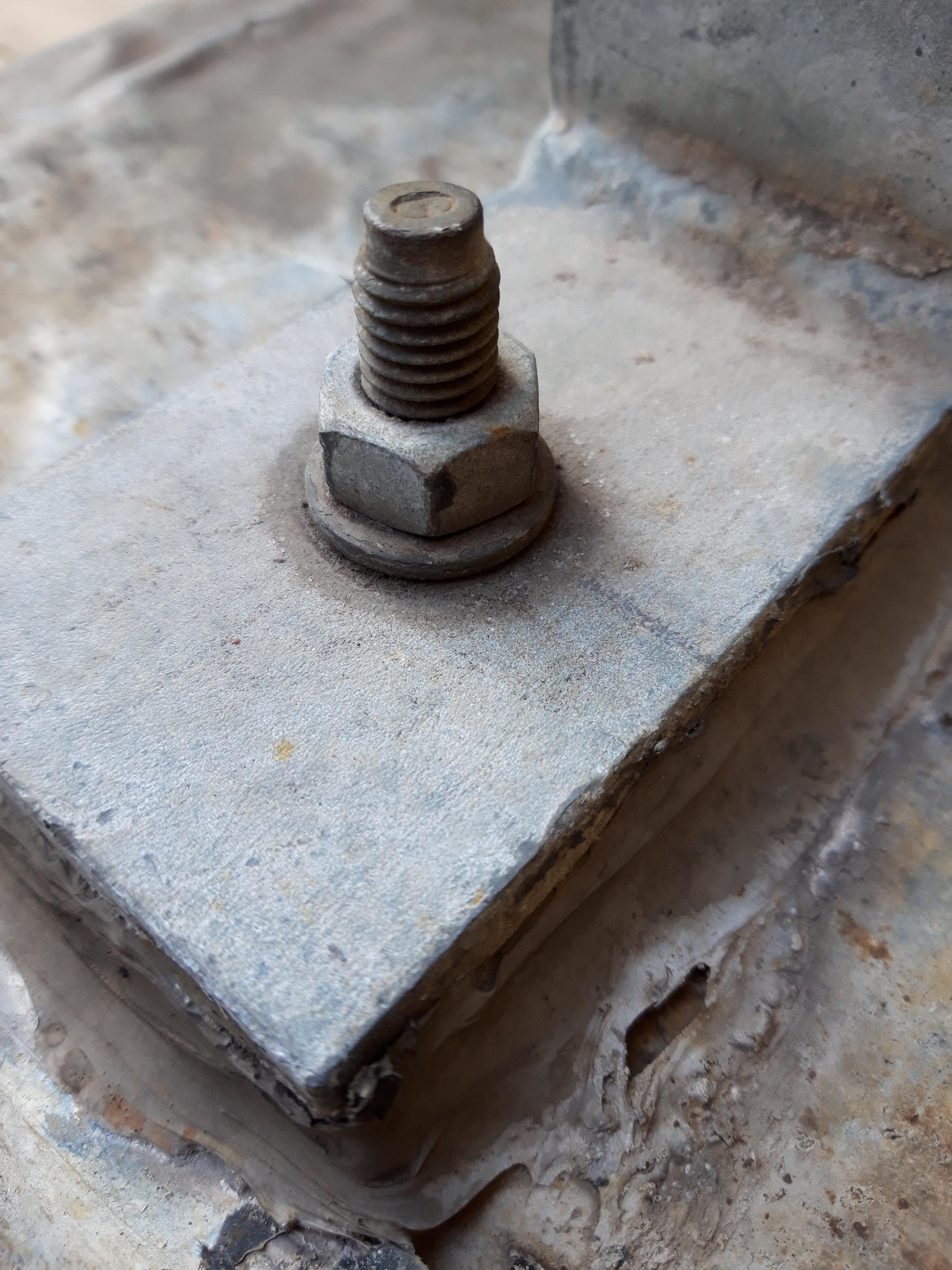

Onoff Posted September 17, 2019 Posted September 17, 2019 How does the shoe prevent use of a spanner? It'd be slow, better to use a socket on a ratchet. If using stainless studding, stainless washers and stainless nuts they won't rust, you cut the studding off low and use a spanner or ratchet. Something like this:
zoothorn Posted September 17, 2019 Author Posted September 17, 2019 @Onoff ok understand that, there seems to be some room for a spanner (but enough for a drill? doesn't look like it on the 6x6 shoes). But I'd need an angle grinder to cut the bar off.. or I saw through by hand & a tiny metal saw is only thing I have/ cant see that working. Before I buy these shoe things, I'm concerned about upward pressure (wind will want to lift cabin UP, & constantly too). I don't seem to have any actual fixings into the post bases with these clamps.. so I'm relying solely on squeeze/ clamped sidewards pressure.
Onoff Posted September 17, 2019 Posted September 17, 2019 If you look at the pic of the galvanised Taurus shoe there's a hole drilled thru one face. I'd project the hole centre line around with a square and Sharpie pen. Drill thru the shoe and the wood so you've a through hole. Whack a bit of grease or zinc spray around the drilled hole in the shoe and fit a cross bolt/stud. Might be worth getting the shoes first as you might be able to get M10 studding in there. Stainless steel stud is easy enough to cut with a decent full size hacksaw + decent blade. Best is 115mm grinder and 1mm slitting disc. Finish off with a file or flap disc in the grinder.
zoothorn Posted September 17, 2019 Author Posted September 17, 2019 10 minutes ago, Onoff said: If you look at the pic of the galvanised Taurus shoe there's a hole drilled thru one face. I'd project the hole centre line around with a square and Sharpie pen. Drill thru the shoe and the wood so you've a through hole. Whack a bit of grease or zinc spray around the drilled hole in the shoe and fit a cross bolt/stud. Might be worth getting the shoes first as you might be able to get M10 studding in there. Stainless steel stud is easy enough to cut with a decent full size hacksaw + decent blade. Best is 115mm grinder and 1mm slitting disc. Finish off with a file or flap disc in the grinder. Ok understood. I do have access to a grinder (chap's still here but collecting anytime). what about this resin though? is it specalist stuff, is the idea here use the bar/ nuts/ washers + resin?

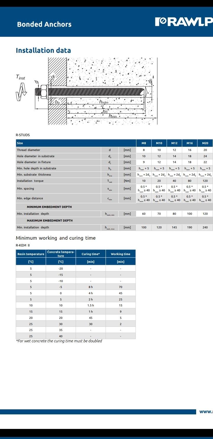

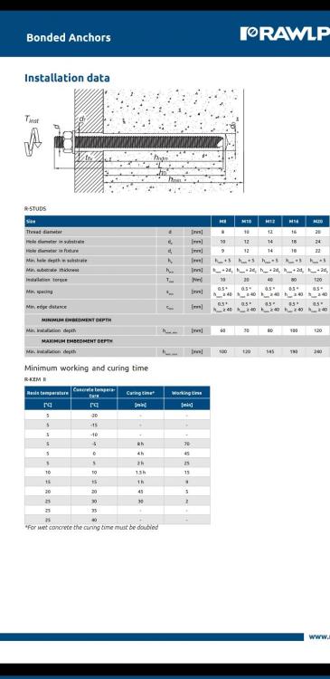

Onoff Posted September 17, 2019 Posted September 17, 2019 10 minutes ago, zoothorn said: Does this 'threaded stud rod' stuff need to be anything specalist, or can I use m8 steel rod from my hardware store? If it's not stainless it'll rust. M8 stud 10mm masonry bit M10 stud 12mm masonry bit Stop whinging.

zoothorn Posted September 17, 2019 Author Posted September 17, 2019 4 minutes ago, Onoff said: Stop whinging. ? ok I'll try but I'm stressed. Look just going back to these thunderbolts- only a £few extra on the shoe brackets after all, so cheaper to go with these in fact. Is the idea with these to -not- use resin as well? & how do I do these flange-head hex heads up? (do they need a specialist tool attatchment thing?)
Onoff Posted September 17, 2019 Posted September 17, 2019 You drill a hole and screw in the Thunderbolt with no resin required. or You drill a hole, clean it, pump in resin and push in a stud In both cases a spanner should do, to wind the Thunderbolt in or do thd nuts up on the stud. Aratchet with socket better.

Onoff Posted September 17, 2019 Posted September 17, 2019 9 minutes ago, zoothorn said: Ok stop the website everyone pay attention- Im going with 10mm bar & gubbins & nuts. I'll have to get more manly & tackle the angle grinder. How long each bar section into concrete? HANG ON! Until you get the Taurus shoe you don't know the hole size for sure i.e whether it will take an M10 fixing stud! You might have to stick with an M8 resin stud. Depending on which resin you get e.g Rawlplug, Fischer, DeWalt, No Nonsense etc then hole depth might vary a bit. For example:
zoothorn Posted September 17, 2019 Author Posted September 17, 2019 Ah bugger. Ok understood.. but couldn't I use my brass stepped hole enlarger bit if I find the hole a tad small? I'll be getting the shoes thurs, & then was gonna get the stud & nuts, & drill bit from town to suit anyway.. so cheers for the info/ useful for my Depth. I'm going with fisher gubbins/ screwfix if they have it. A spanner will have to do to.
zoothorn Posted September 17, 2019 Author Posted September 17, 2019 @Onoff sorry.. is there a difference between a m10 'fixing' stud, & a m8 'resin' stud/ apart from the size?
zoothorn Posted September 17, 2019 Author Posted September 17, 2019 Hole dia is 8mm in the base. So I guess Im best sticking with this & not enlarging. Cleaning out the hole.. does it need a special brush, or can I improvise with something.. or even blow the concrete out (goggles on etc)?
Onoff Posted September 17, 2019 Posted September 17, 2019 Fischer resin is my goto stuff. Rawlplug resin second. Resin stud/fixing stud = same thing. Stud/studding is just threaded bar, sometimes called "all thread", "threaded rod" etc. You can buy ready cut resin studs or 1m lengths and cut your own as aforementioned. Push comes to shove you could open up the 8mm hole in the shoe with a normal, HSS drill bit from your drill set as long as they're half decent. If using 8mm stud you will have to use the shoe as a guide for the 4 holes using an 8mm, masonry bit. once the holes are drilled you will need to open them up to 10mm diameter. So there'll be 1mm all around the 8mm stud for the resin to fill. You may find you are off a bit and end up having to enlarge one or more holes in the shoe. If you do then paint the drilled metal with Screwfix 40801 (my goto is Toolstation 60070 but think you only have a Screwfix?) Cleaning the hole is v.important. I always use a puffer. Some people use a hoover and/or compressor. The thing is a puffer is a two way action. it blasts air in and sucks it out agitating loose stuff in the walls of the drilled hole. A compressor can push debris into the walls of the hole where it won't come out but isn't in fact that well "bonded". So the resin goes onto a "loose" particle. Ditto a hoover. The tiny bottle brush thing followed by puffer system is best. I have, once at home, cobbled together one of the resin gun nozzles on the end of the hoover hose to get in the hole and "suck" the debris, then switched the hose to the blow side of the vac, keep switching. Rough but I couldn't find the puffer at the time.
