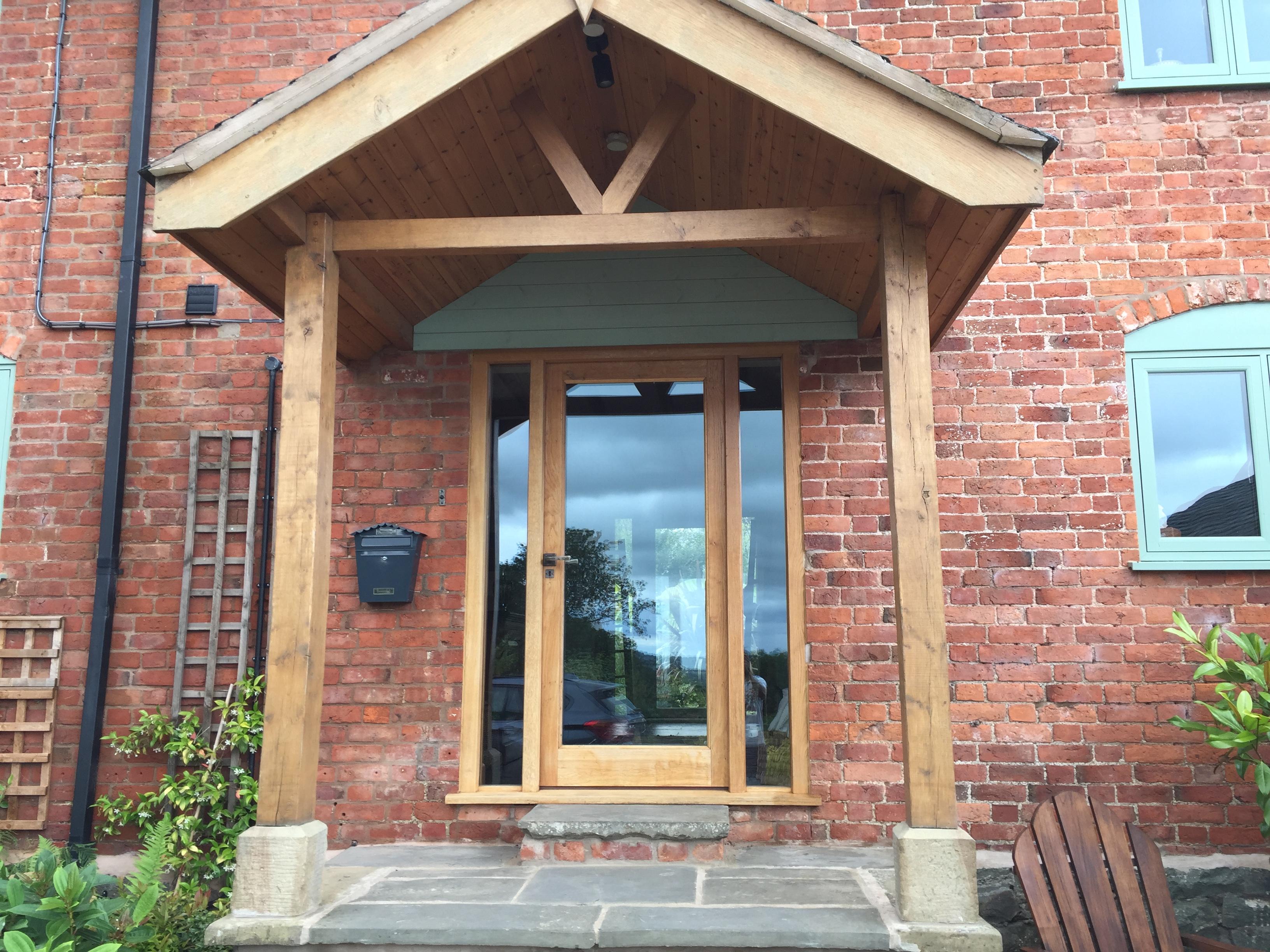

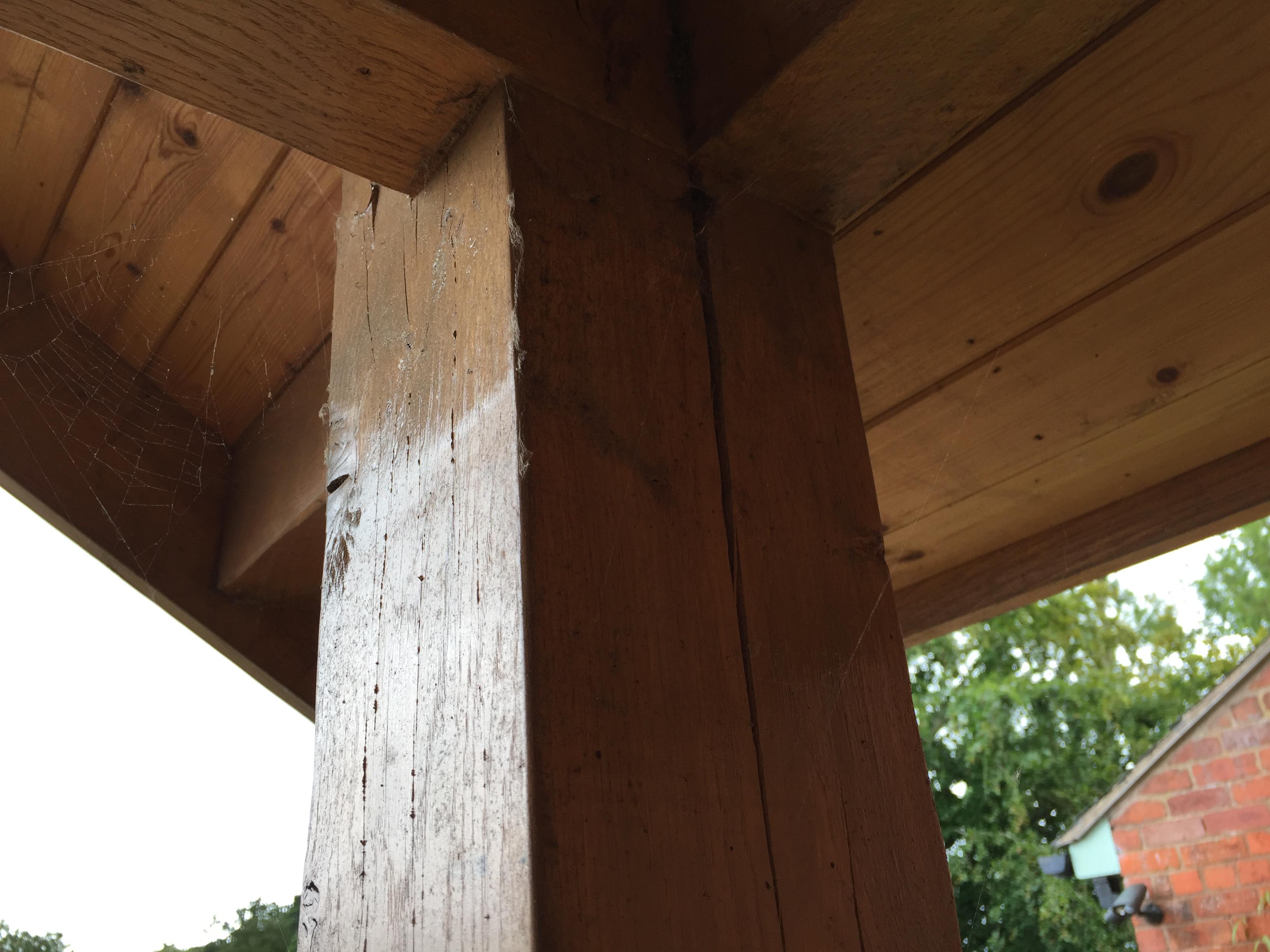

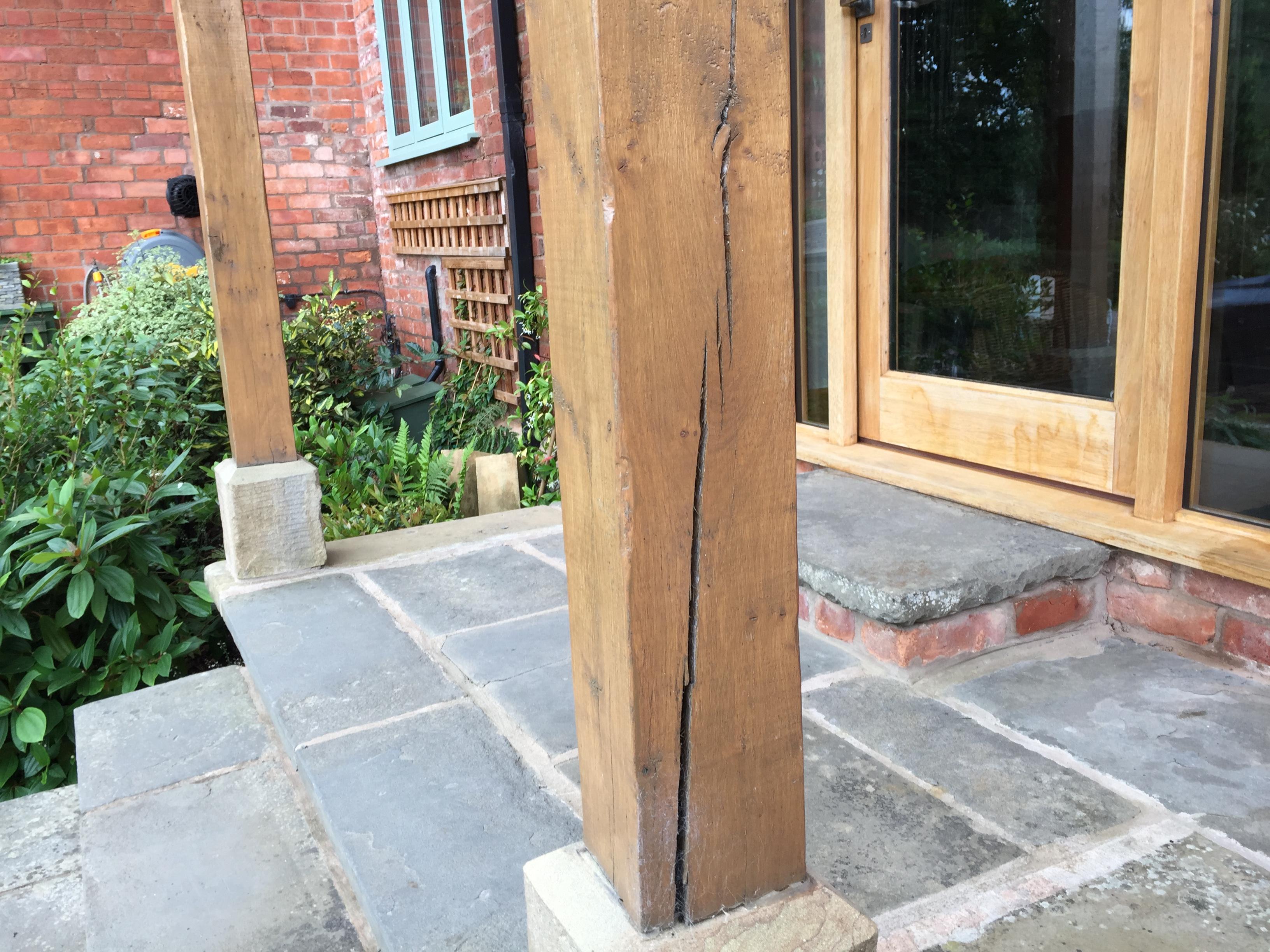

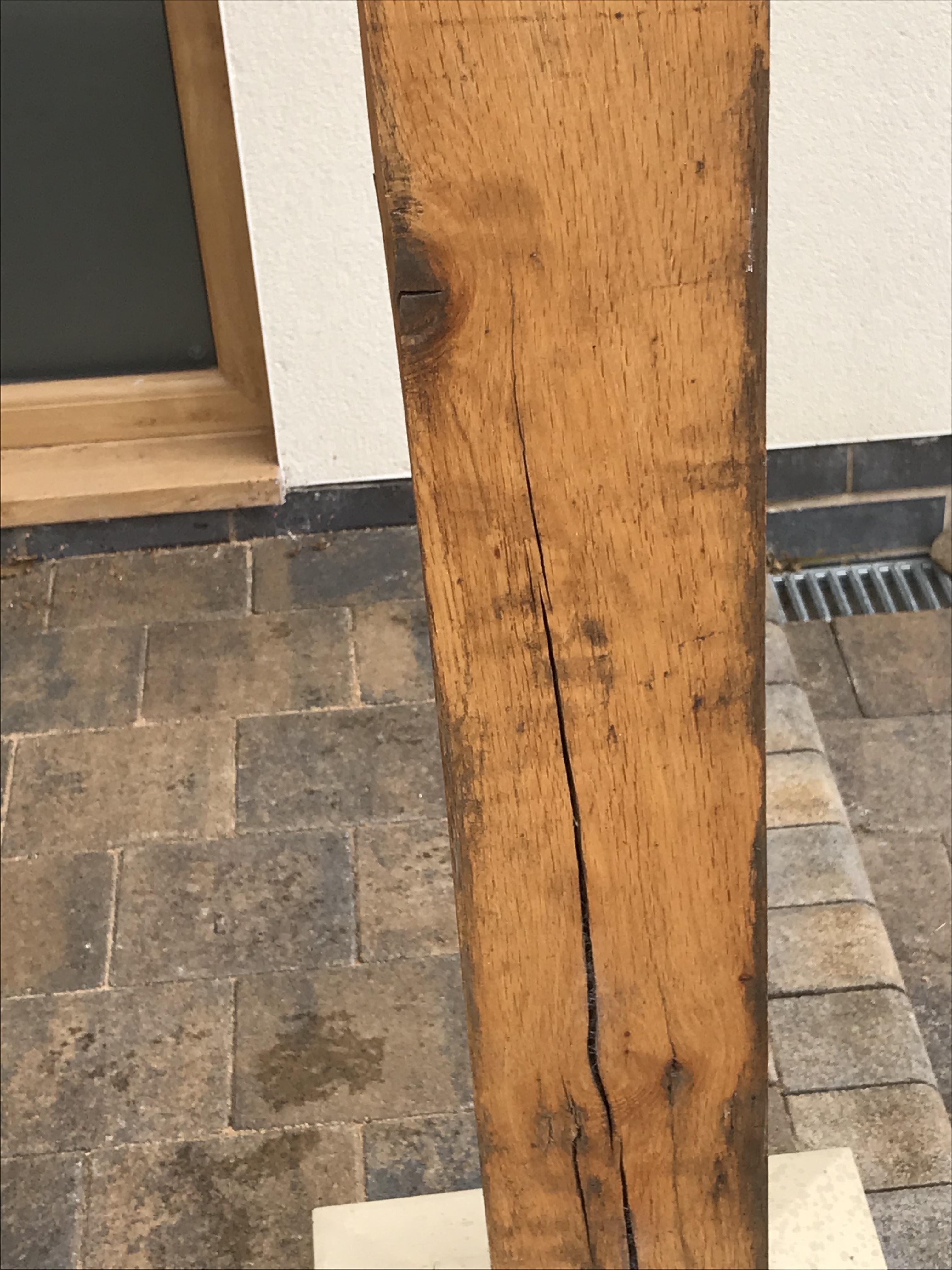

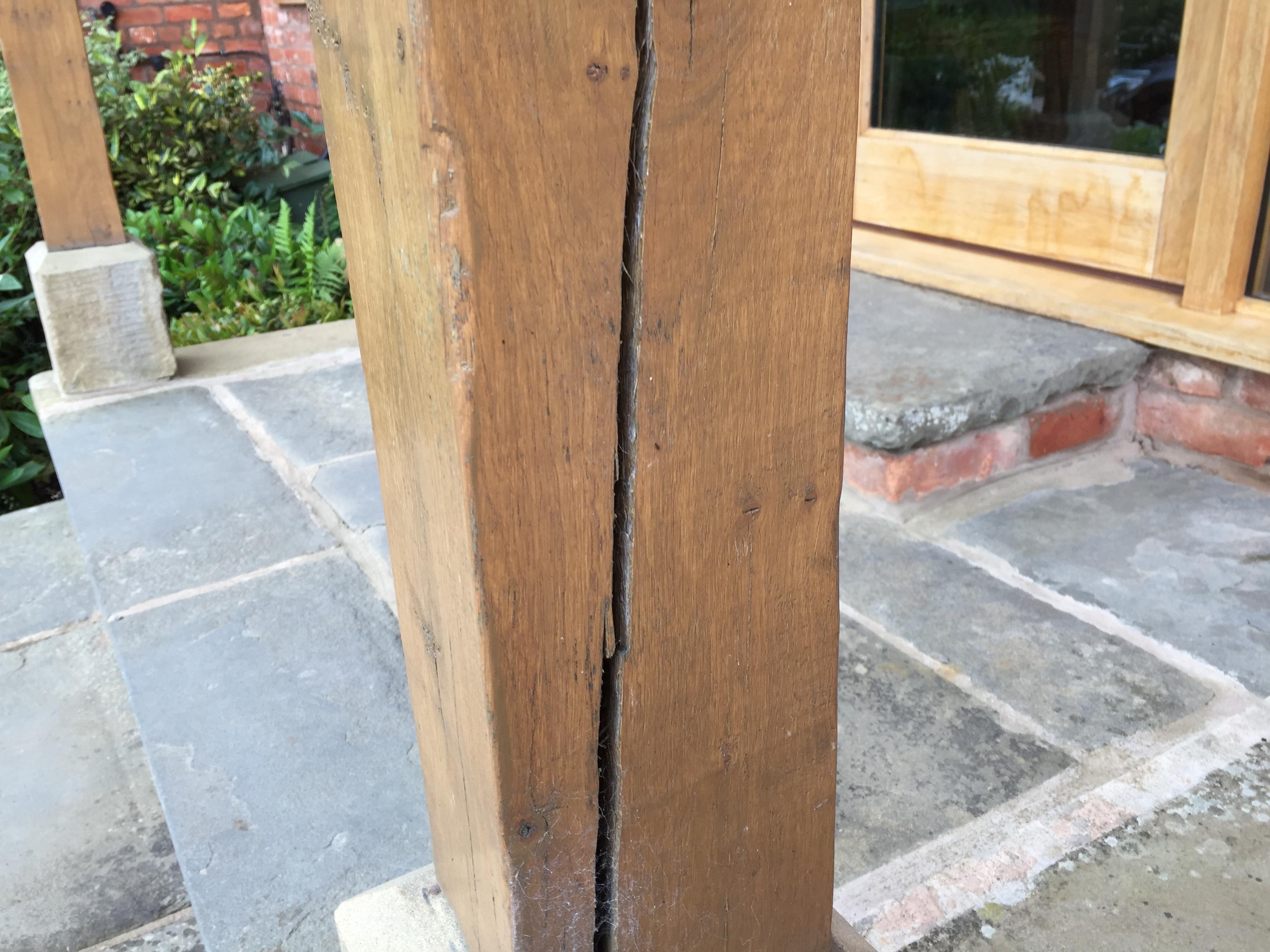

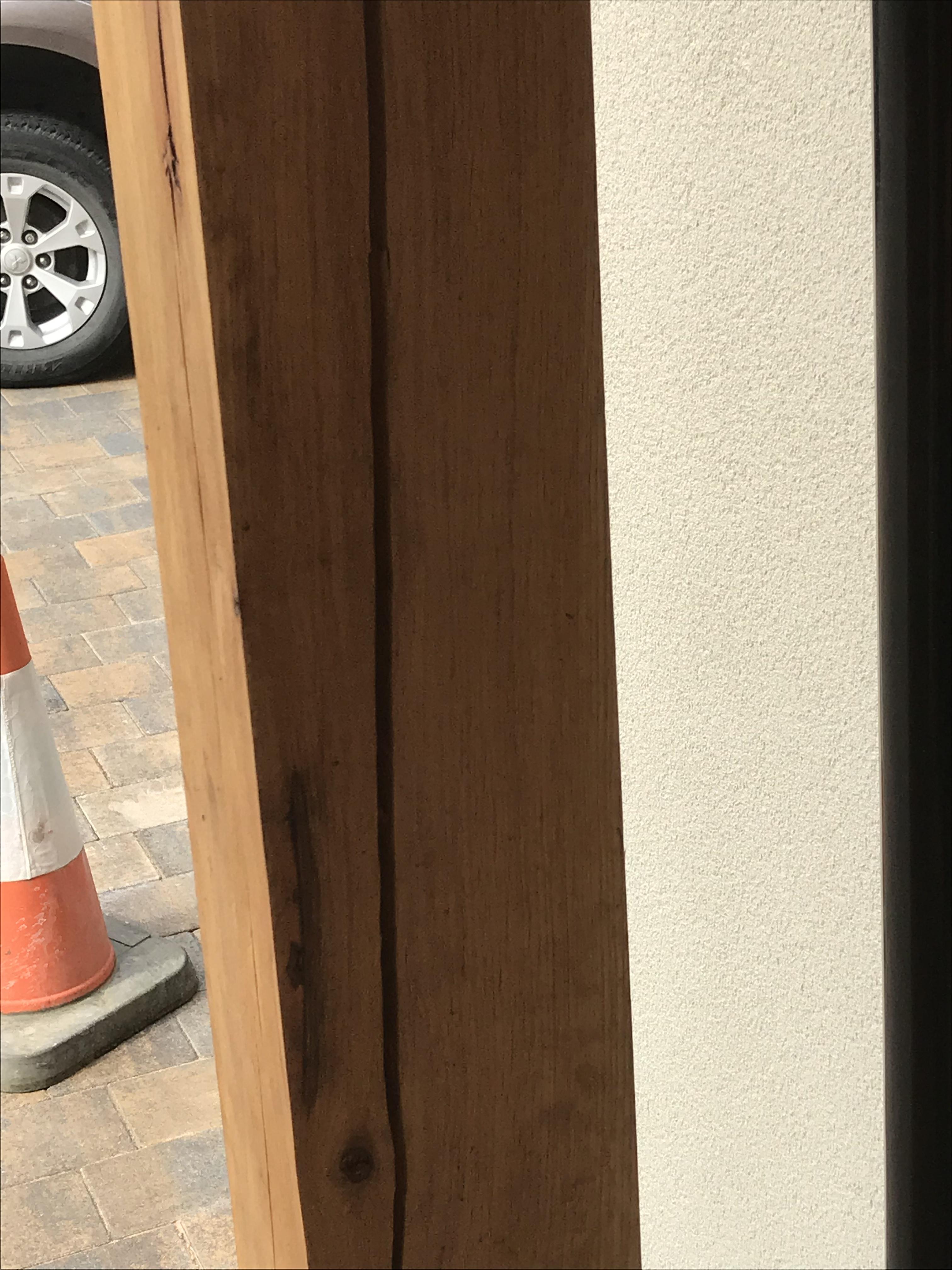

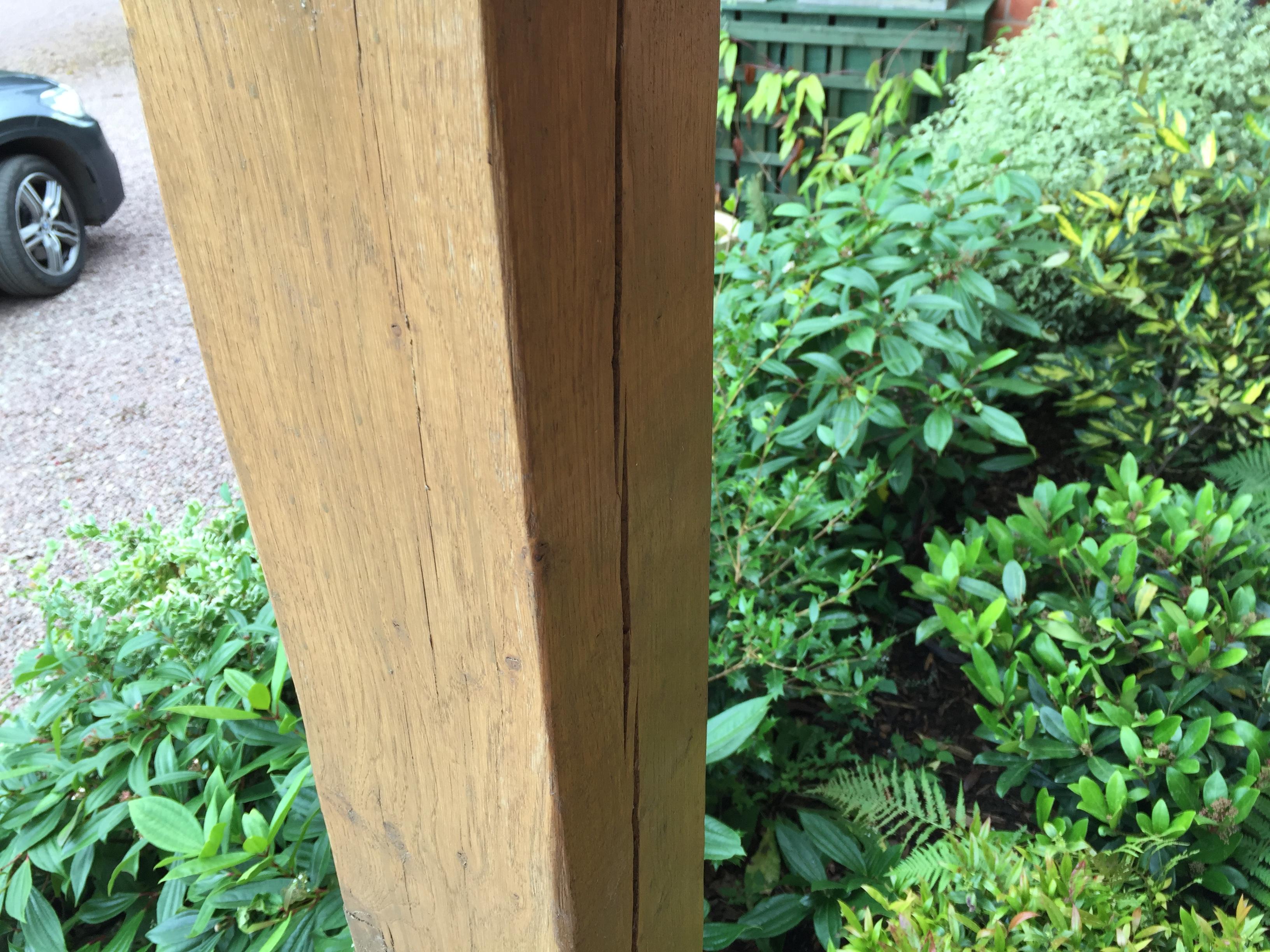

H F Posted August 22, 2019 Share Posted August 22, 2019 We have oak pillars that lead up to our house. Ive noticed that we've got some almighty cracks in them. Should we be filling them or treating them in any way? Link to comment Share on other sites More sharing options...
bassanclan Posted August 22, 2019 Share Posted August 22, 2019 No that is expected with oak and part of its natural charm Link to comment Share on other sites More sharing options...
Barney12 Posted August 22, 2019 Share Posted August 22, 2019 Green oak will do exactly as you've shown but it is highly unlikely that it is anyway compromising the strength of the posts. Definitely don't do anything. Its probably got a fair way to go yet and anything you add will not only destroy the visual appearance (I guess that is subjective but if you were looking for 'clean' lines then that is the wrong material) but just crack or fall out. Link to comment Share on other sites More sharing options...
H F Posted August 22, 2019 Author Share Posted August 22, 2019 I love the appearance of the cracks was just scared that it would continue to crack and splinter and collapse. Glad to hear that won't be case any time soon. Since it doesn't need it, I won't fill it. Should we be treating it all every few years with a coat of varnish, preserver, stain, etc.? Link to comment Share on other sites More sharing options...
nod Posted August 22, 2019 Share Posted August 22, 2019 43 minutes ago, Home Farm said: We have oak pillars that lead up to our house. Ive noticed that we've got some almighty cracks in them. Should we be filling them or treating them in any way? Green Oak we have the same cracks They will be standing long after we have gone Link to comment Share on other sites More sharing options...
Jeremy Harris Posted August 22, 2019 Share Posted August 22, 2019 26 minutes ago, Home Farm said: I love the appearance of the cracks was just scared that it would continue to crack and splinter and collapse. Glad to hear that won't be case any time soon. Since it doesn't need it, I won't fill it. Should we be treating it all every few years with a coat of varnish, preserver, stain, etc.? Looks like the oak has been finished with something already. Most people would probably just let it weather, I think. It will then go grey, darkening over the decades. It doesn't need treatment, there are quite a few big lumps of oak in buildings that have been there a few hundred years with no treatment. Link to comment Share on other sites More sharing options...
Barney12 Posted August 22, 2019 Share Posted August 22, 2019 As Jeremy has said it looks like its had a coat of oil. The need to re-apply is purely cosmetic, personally I quite like the look of oiled oak rather than the natural grey. If you do decide to coat it try and find out what was used before. If it was oil then I'd personally stick with OSMO: https://www.osmouk.com/sitechaptern.cfm?bookid=Products&chapter=82&page=262 Link to comment Share on other sites More sharing options...
ToughButterCup Posted August 22, 2019 Share Posted August 22, 2019 Green oaks without cracks, I'd be wondering why not ... Link to comment Share on other sites More sharing options...

H F Posted August 23, 2019 Author Share Posted August 23, 2019 (edited) 14 hours ago, JSHarris said: Looks like the oak has been finished with something already. I think they used a clear varnish. Edited August 23, 2019 by Home Farm Link to comment Share on other sites More sharing options...
H F Posted August 23, 2019 Author Share Posted August 23, 2019 Relieved to hear it’s all good. Thanks for the reassurances everyone. Link to comment Share on other sites More sharing options...
