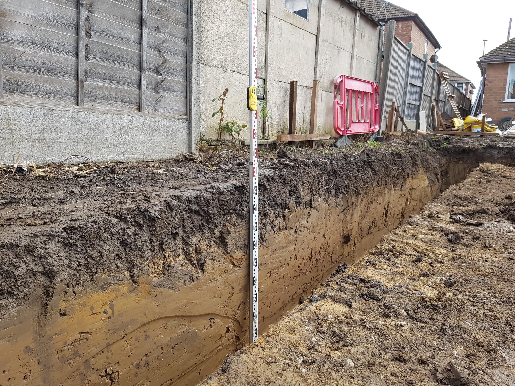

Oz07 Posted August 18, 2019 Share Posted August 18, 2019 You can leave the perimeter at existing ground level and demonstrate your 1m depth off this. Providing you've scraped all the veg off. They don't expect you to take foundation level from reduced dig level Link to comment Share on other sites More sharing options...
Oz07 Posted August 18, 2019 Share Posted August 18, 2019 Link to comment Share on other sites More sharing options...

sean1933 Posted August 20, 2019 Author Share Posted August 20, 2019 Thanks for all the replies everyone i appreciate it. Can i just check the measure from depth as looking at Oz07 picture has confused me a little. I have stripped the topsoil off c.1m around where the foundations which because of the site (overgrown wildflower/deep weeds) has removed some 200mm (to be reinstated afterwards). Should i be measuring from this new 200mm depth or the original ground level - which will be used as reference for GL? I wouldnt normally be too fussed but its a big house with lots of sleeper walls and wide (600 & 750's) foundations so at £125m3 theres a lot of money that could be wasted here! Thanks in advance. As always the helpful responses are greatly appreciated. Link to comment Share on other sites More sharing options...

Oz07 Posted August 20, 2019 Share Posted August 20, 2019 As above always get a visit morning of first day digging. If you strip the whole site have the conversation with bco early doors on phone see what he wants. I've left the top layer of soil in that pic as it's not going to be paved or anything. Always easier working if you strip the lot off. Link to comment Share on other sites More sharing options...
